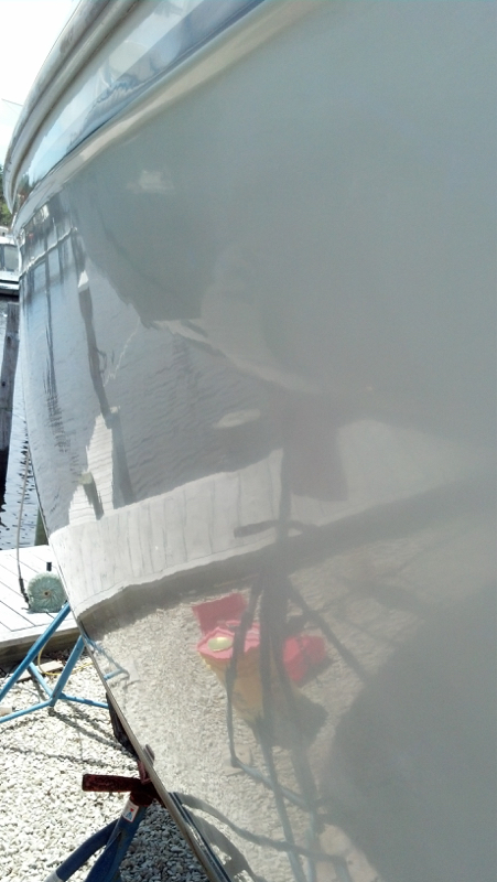

Ok so if i go with the Makita, what kind of bonnets should I buy and how many.
I only wax my hull once a year and as you can see from the picture it does not look to bad.
My cabin and deck is where I need to do some work.
