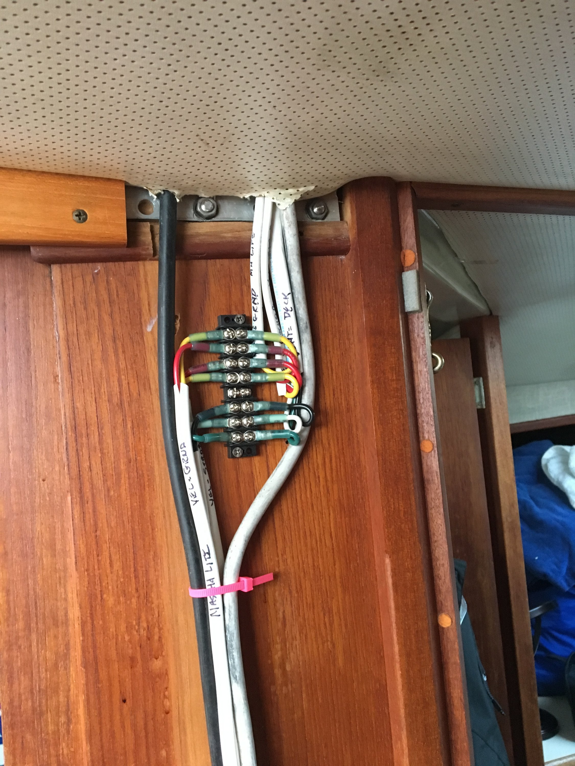

I do not remove my mast unless needed for a major repair. I created this electrical block to permit removal of the electrical leads. The radar and VHF cables would be fished from their displays to the compression post to be pulled with the mast.

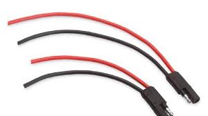

On my previous boat I used SeaDog connectors but was disappointed because they were expensive and they didn't last nearly as long as I expected. I replaced them with the connectors Ned shows above. They are automotive connectors, available in 2,3 or 4 conductors, very inexpensive and with a bit of dielectric grease they last almost forever. They are designed for a fairly corrosive environment like trailer light wires on salted winter roads. I used them just for lights, not instruments or anything else. One advantage they have over other connectors is the wires are molded right into the plastic with no way for water to get in. You don't need to solder wires to the connecter pins, just splice the wires using a good marine grade shrink wrap.

I used to have these type of plugs but they are prone to corrosion and not all that easy to identify the oversized post to get the plug in proper line up before pushing them together. Last time I unstepped the mast I exchanged them all for a nine pine trailer male and female plug. They have bigger contacts, plug and socket lock together they use nice sturdy screw compression connections and I made up a spare piece of cable with plug and socket ends so I can test all the lights with mast unstepped and cradled on the boat

My wiring is thru deck and mast base also but the wires are crimped (not liked) I just bought the parts to do a set up like this one, its a clean way to do it.
