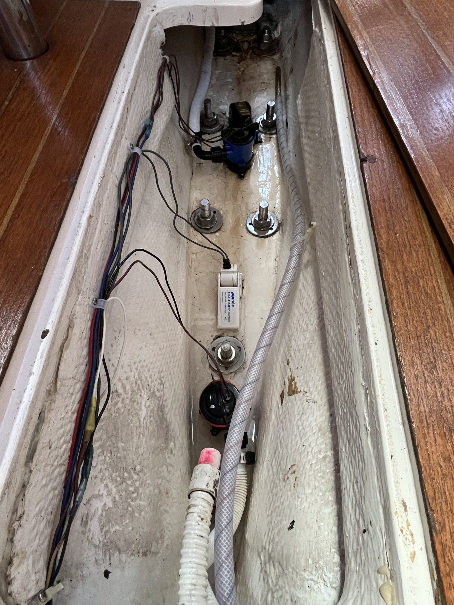

My thinking is that simplicity, redundancy and ease of replacement/repair are key in a bilge water management system. For that reason, I favor simple mechanical float switches and the Johnson bilge pumps with the removable motor cartridge.
Maybe I’ve just been lucky or perhaps being in fresh water with a short sailing season is a factor, but the Rule float switch installed in 2007 is still in use and reliable. The Rule 800 bilge pump installed as the primary pump at the same time just gave out late last year and was replaced with a Johnson pump. 17 years is a pretty good run, so no complaints. I have no idea if they’re still of the same quality today. The float switch installed for the secondary bilge pump is West Marine branded. I don’t know who the manufacturer was, but it was installed in about 2009 and I’ve had no issues with it to date.
My primary bilge pump is on a pump cycle counter, which I strongly believe in because I think an automatic bilge pump could mask a small problem until it’s a big problem. The two pumps are also connected to separate batteries.
The hose to the right in the photo runs to a 3-way valve on the engine side of the raw water strainer. It allows me to use the engine as a third emergency bilge pump, but the primary purpose is easy winterizing. The home made brass pipe strainer is friction fit with no hose clamp. I just pull it off and stick the hose directly into my jugs of antifreeze and the engine is winterized in about three minutes with no mess.
Before anyone comments, yes, I know the corrugated hoses are less efficient. I just didn’t know that back 2007-2009 when I installed them. When it’s time or I’m in need of an easy project, they’ll be replaced with smooth walled hose.
This is probably all more than you asked about, but to me it’s all related because all the components are part of a system.
