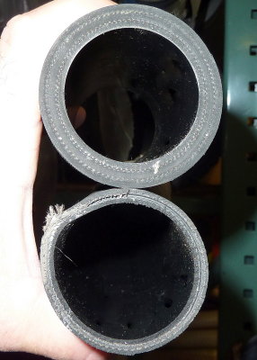

I have no history on mine. Not even sure it's the right material. It may be as cheap as the nylon stuffing box. After reading Main's article it leads me to want to replace it. He says the accepted life expectancy is 7-10 years. I'll bet many will say there's is older but do you want to chance a rupture?
http://www.pbase.com/mainecruising/stuffing_box
Guess which is the correct one -
