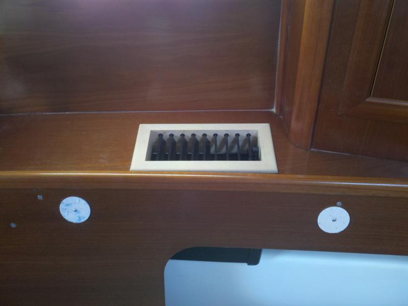

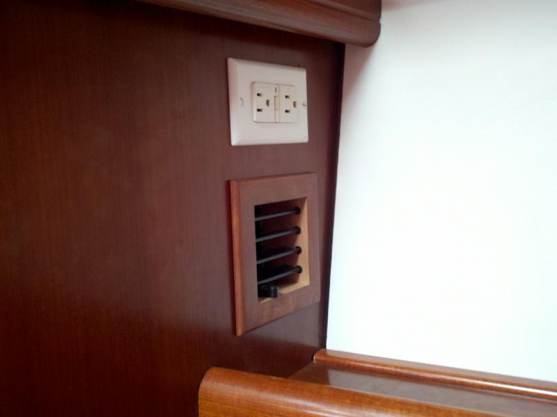

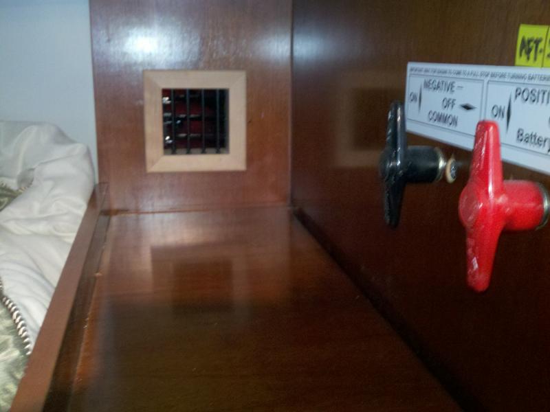

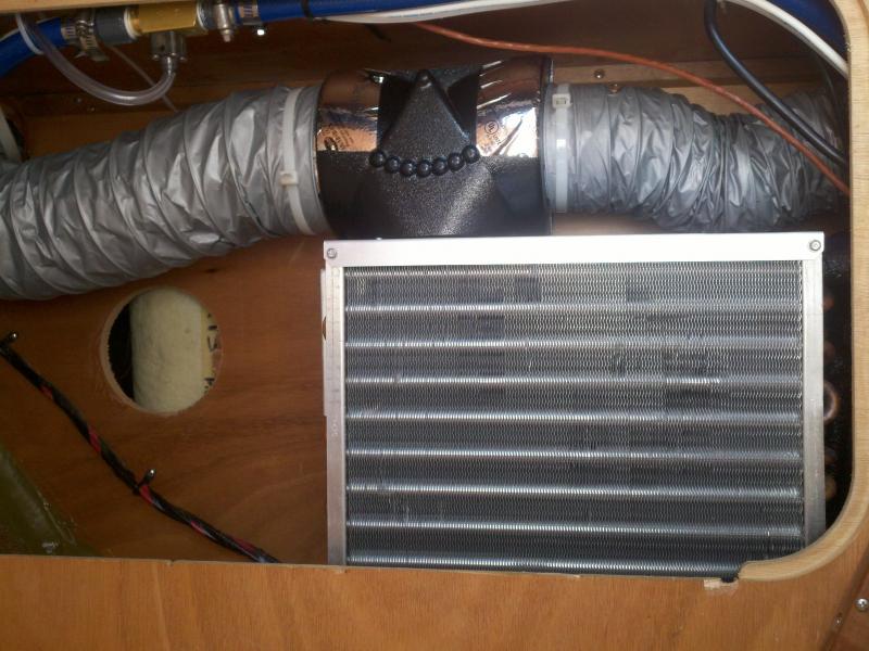

I just completed installation of a 16k Flagship AC in my B331. It was a lot of work but I figure I saved close to $5000 based on the est I received from the Cruisair installers. Good start would be for you to ask around and find out what size and where Beneteau dealer installs an AC on the B321.
