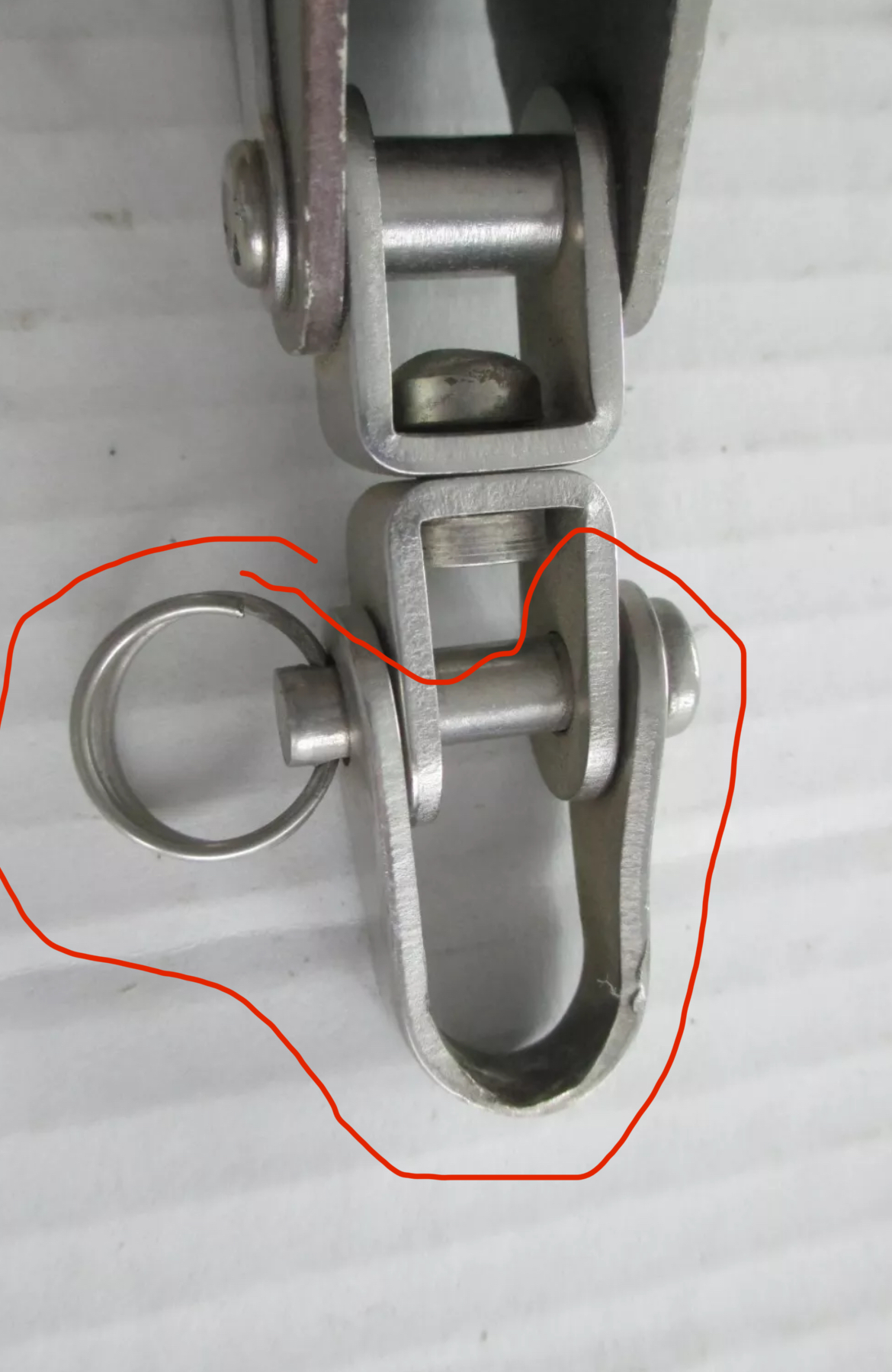

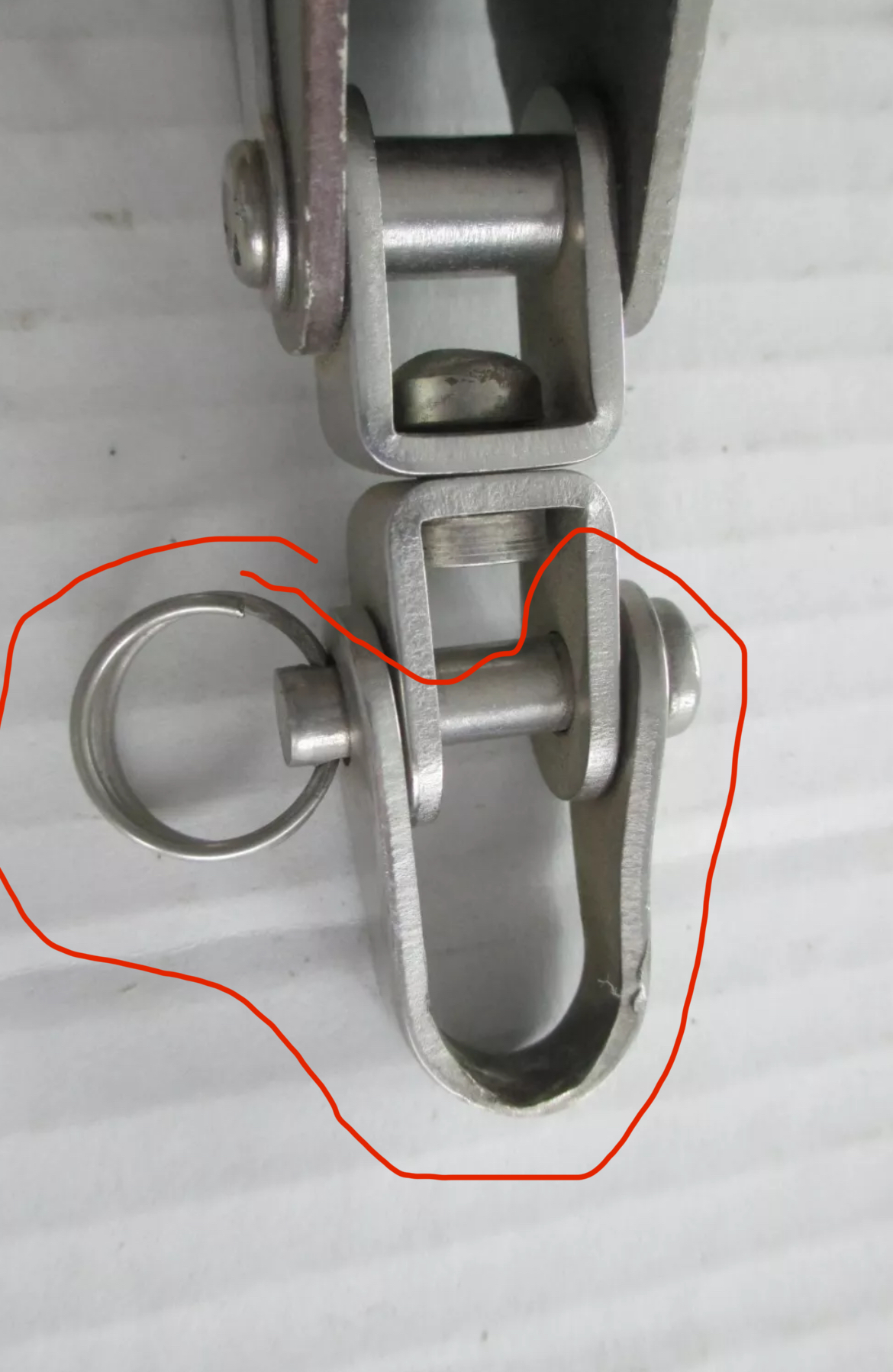

What is name of a block’s attachment point?
JBP-PA
Apr 29, 2022
831
Jeanneau Tonic 23 Erie, PA
When a shackle is attached to a block in that fashion, it is also know as a becket.

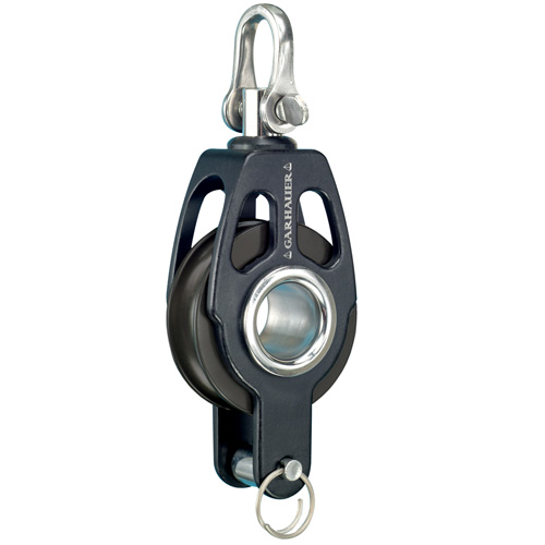

Becket is one of those terms that has multiple meanings, so it "might" refer to this shackle, to some. That would be confusing, in this case, because the becket more commonly refers to one of two things:
  1. The attachment point for a line, such as on a fiddle block or becket block.
  2. The loop in the end of the line that is used to attach the line to a fixed point.
I have only ever heard the term used to refer to that pin (usually with a little sleeve/roller) that serves as an attachment point on a fiddle block. I learned, a while ago, that it can refer to the spliced loop in the line that attaches there, though I haven't heard anyone use it that way.
This Garhauer block shows the shackle on one end and the becket on the other:
By the way, Garhauer would be a good place to look for a good price. SBO also sells them and it looks like they have good prices, though largely out of stock.

Gotta love sailors, several words for everything. Ideally in a totally different context from normal humans.
I especially like "jack": lazy jacks are totally different from jack-tars, altgough they both might be lazy, plus jack lines, jack stays, etc. Floors are not what you stand on, although floorboards are. Ceilings are not above your head.
I'm liking your definition, a becket is a fixed attachment point suitable for a line, a swivel shackle provides motion more suitable for fixed attachment.
Keerect....... the becket will be opposite the shackle end(fixed or swivel) Very handy item that gives the block a number of options.
