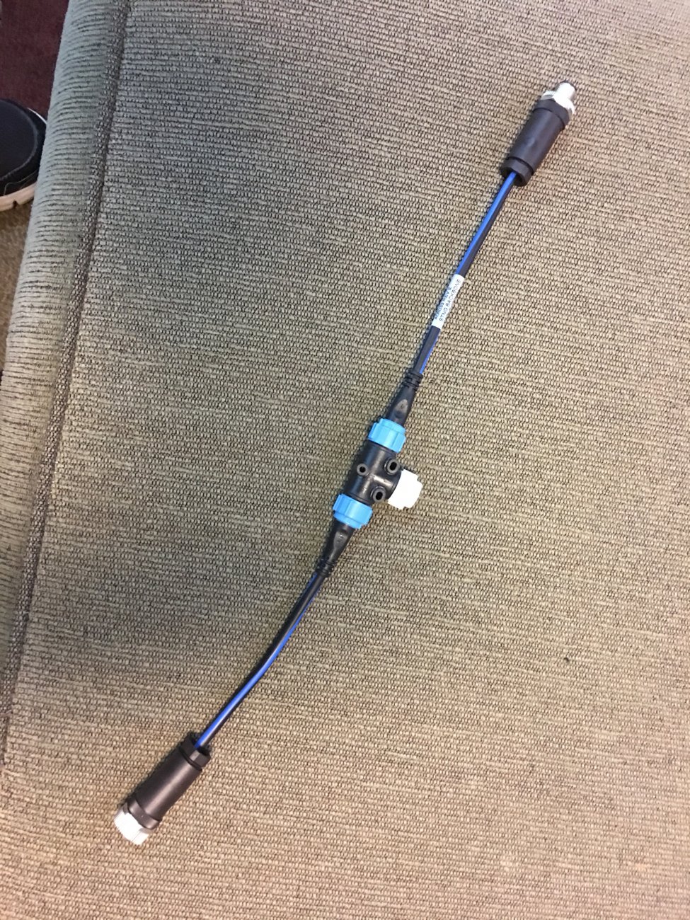

What is it??

Is it a power splitter, made to run power to each of your bow lights from one wire? Probably incorrect, but that's all I can think of.
24,592
It's a backbone wire to your Raymarine network and you wanted to connect two sensors to the SeatalkNg so that you can see the info on your MFD...

A section of N2K backbone with field installed terminals.
why I made it ???
You were bored?
You wanted to do something that is incredibly frustrating, trying to get all those little wires in the right places.

Getting closer - it inserts a SeatalkNG backbone segment in a NMEA 2000 backbone.
In our upcoming charter in Belize I believe they have Axion chartplotter s which are N2K. I want to plug in my yachtdevices log so we can record the nitty gritty of the trip. My log device plugs directly into the White SeatalkNG socket, so needed a converter, which for some reason no one makes.

Well that will be cool. So one of the ends is a termination and the other daisychain connects to the axion?
May 20, 2016
3,015
Nope one end is male N2K the other is female with a SeatalkNG device in the middle.
