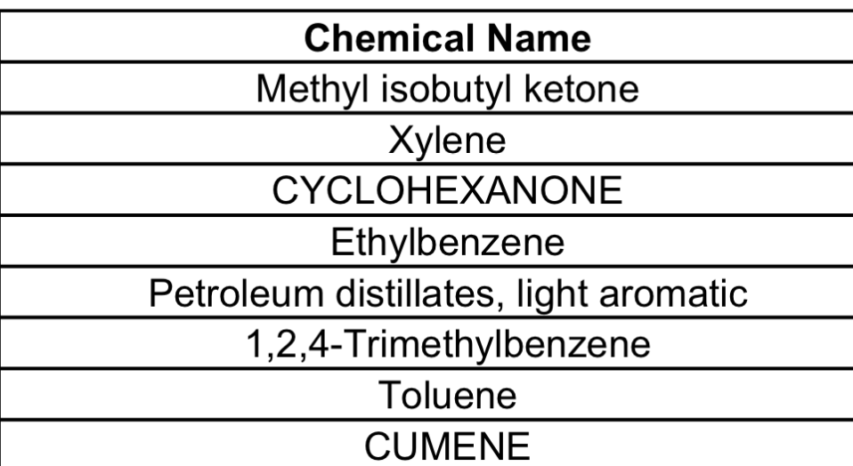

I can’t find the MSDS for the TotalBoat product, but it’s probably pretty similar to the Pettit Dewaxer, which lists these compounds in its MSDS:
With that mix of chemicals it’s probably fair to say a “dewaxer” product is broader and able to dissolve more kinds of grease, waxes, oils, and other surface contaminants than just acetone or alcohol. @rgranger or @thinwater might be able to go into more detail.
