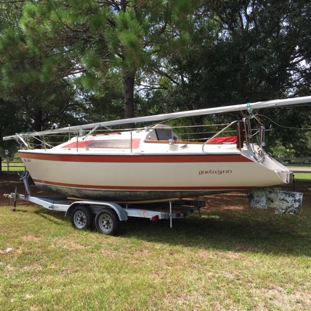

I had a 240 that was easy to set up by myself but like the mac 26 was tender until on a good heel, even then it could get spooky on the high mountain lake microbursts. The Dehler 25 is an awesome trailerable as it is an eight foot beam in the vicinity of 2500lbs towing weight dropping 800lbs of the ballast as you move to the parking lot washing down the ramp. it still carries 800lbs of cast iron fin vertically moving keel. I towed with a 5.9L Durango and it was effortless even over the high passes. It is also a one person set up in 45 minutes, a gin pole came with the boat when new but was absent when I came along so I made one. It has baby stays but was much better with side stays for the pole as well. If your boat is easily trailered and set up then you can sail far and wide. Mine traveled to the Sea of Cortez twice, San Juan Islands, every large reservoir in Colorado, Gulf of Mexico. It is so stiff that the rail has never been under as it will round up before you can get it wet. It serves as a fast racer cruiser that beats much longer waterlines and comfy camper on the road, dual axle trailer means no sway. Sadly it is time for a new home as two boats is one too many.
