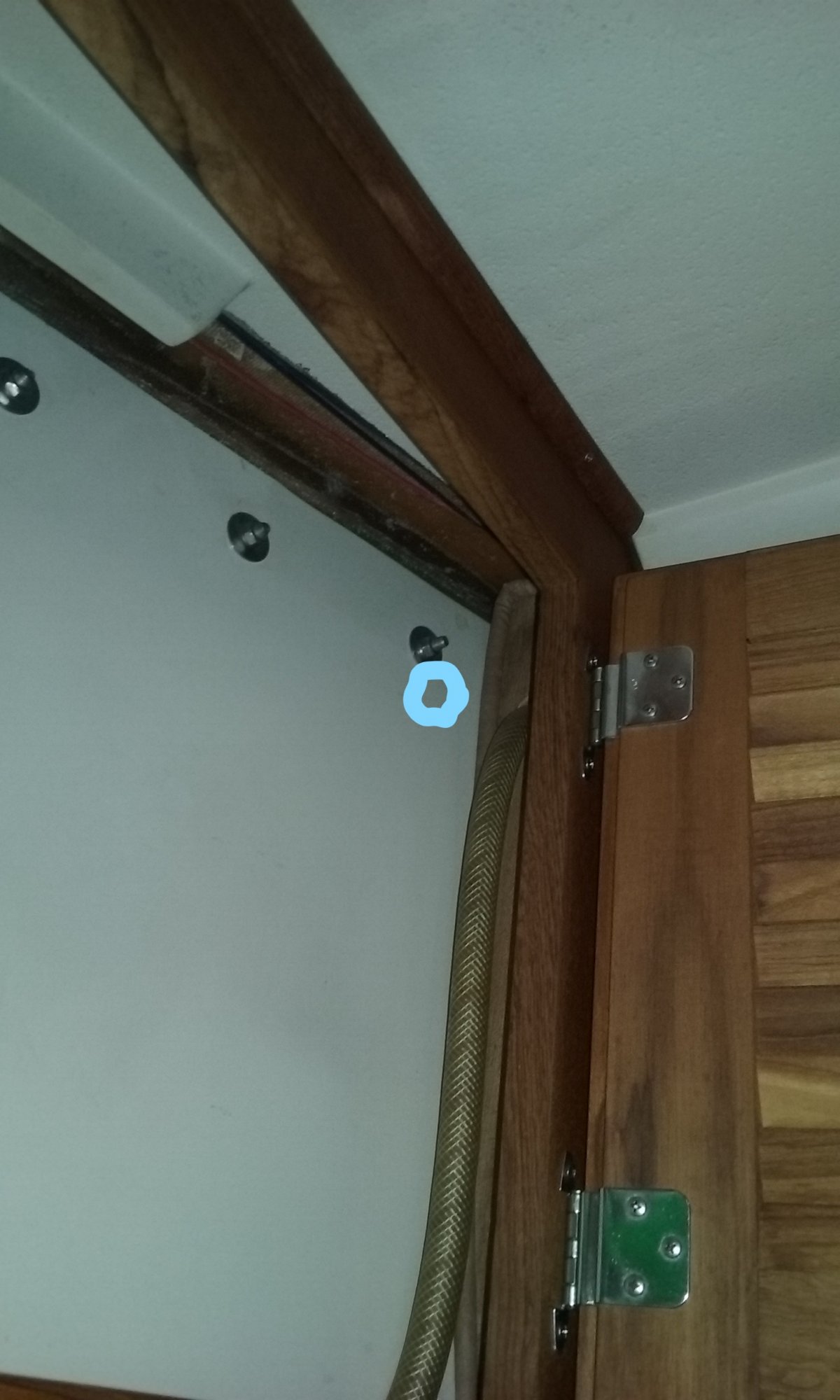

Thanks s. @Peggie Hall HeadMistress. I needed to replace my black tank head vent stanchion due to cracking at the base and purchased a solid base instead. My plan had been to install this Flush Mount vent. There is not a lot of depth available for the hose in the cabinet where it gets mounted. Any suggestions for 1" vents that would fit in the available space? I need a right-angle thru-hull.

@Hayden Watson I don't think you want a right angle thru hull, which will restrict air flow.
Check out this link. Replacing Stanchion Vent Very good photos of what @Smunkey did on his boat in post #15.
I installed mine the same way and put the thru hull in the same place. I used the Trident PVC 148 white hose. Yes the hose is stiff but that forced a nice gradual bend which I'm sure helps with the air flow. I used a standard 1" mushroom head thru hull with hose barb.
Just one word of caution. There is a gap between the liner and hull. I filled the gap with thickened epoxy so I didn't deform the hull while tightening the thru hull.

I am trying to figure out why a 90º bulkhead fitting would be a problem. Air can bend the angle with little change in pressure and it would give me the room to install the 1" vent. I need it to go into the foreward end of the port bin and that can only be done with the 90. In plumbing, the vent lines use tight 90º elbows whereas the lines that carry water need to have sweep 90's.

A holding tank vent isn't a plumbing vent..it doesn't just provide an escape for air, it has to provide a means of exchanging ambient air with gasses inside the tank which are heavier than ambient air. Therefore, to keep the tank aerobic, the vent line needs to be as short, straight and horizontal as possible...which on a sailboat is difficult enough without introducing any 90s into it.
So I'm not sure that your choice of thru-hull location will work, with or without a 90 in the vent line. If you'd like to discuss how to do it right in more detail than is practical here, send me a PM. We're in the midst of a major snowstorm that has me housebound for at least another 2 days, so I'll have plenty of time for you.
