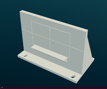

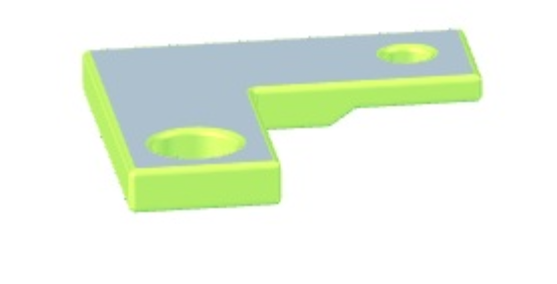

First project up is a prototype of a special connector plate between a switch and Class T fuse block.

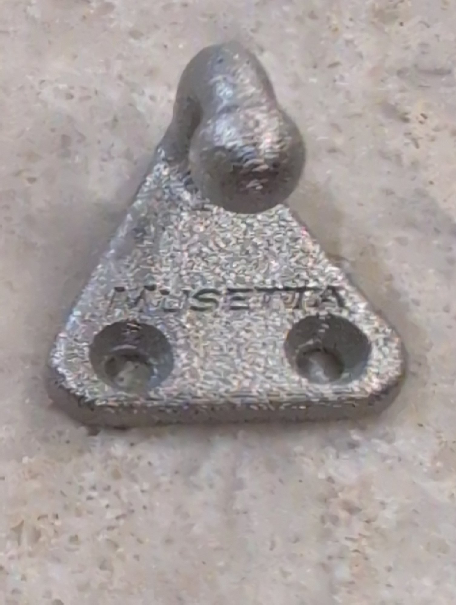

post 2. Interesting. The original was cast. A replacement would have been either cut, drilled, and bent from 1/4-inch aluminum, or possibly TIG welded from aluminum or stainless. Not difficult or time consuming. Alternatively, something could just be sourced. Not a common 3D machine, either.

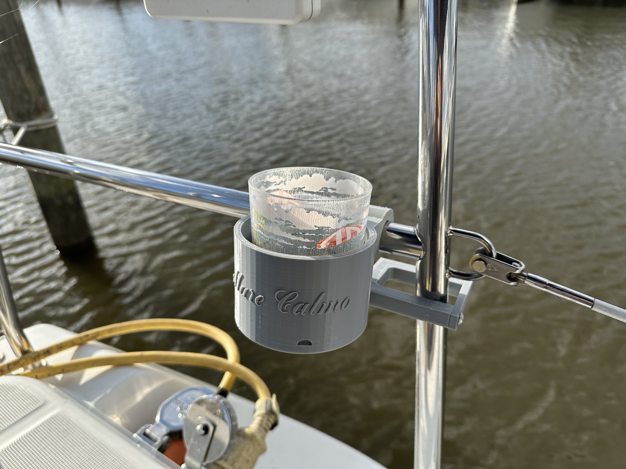

Post 5. Neat. Obviously, you could source that. I actually use bicycle water bottle holders, since we don't use cups much. If I wanted something cool and custom, I'd probably TIG something from some rod and tubing. Clamps are actually pretty fast to fabricate. I can't think of a simple way to add a name.

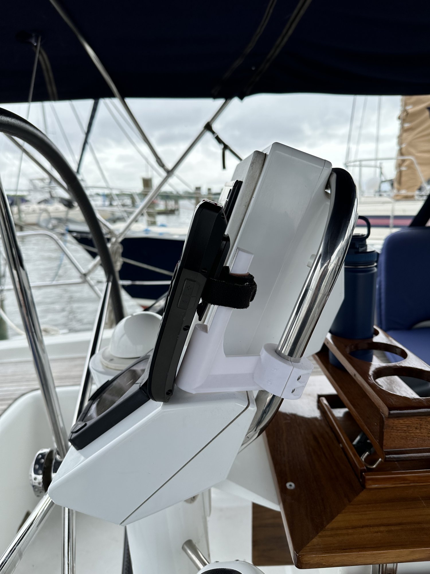

post 6. I fabricated a similar holder for a tablet on my last boat. Some bending, welding, and machining. An after-dinner project, similar complexity. I made a bird-blocker from 11 ga aluminum using a bending brake; looked factory made. I like the door latch, a good 3D project, but I'm not sure I like it as well as the simple hook/grommet my last boat came with; more secure in rough weather.

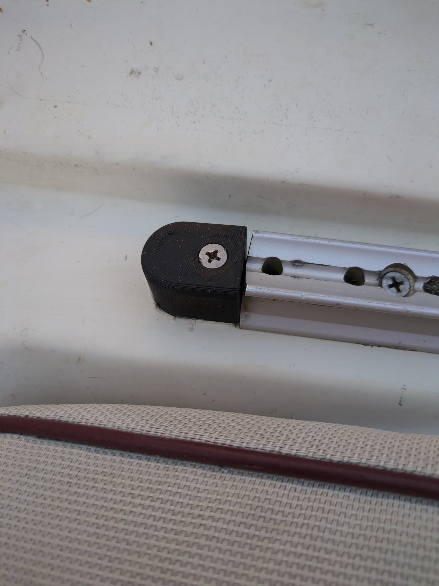

Post 18 could be cut from scrap in minutes.
Post 19 I could cut from GRP angle scrap.

As I posted #2, I'll speak to that first. I don't know if the original parts were cast, they may have been I've not concerned myself with that. They were originally made from a copper based alloy - I also haven't concerned myself with figuring out which specific alloy. However, the originals were definitely not strong enough as many had broken the hook off.
These would have been a bit difficult to manufacture - for sure casting would have been the easier manufacturing method. I also looked extensively for a replacement commercially available but it was not possible to find an exact copy - more critically for me was the hole placement for the attachment screws. Blanks where I could drill the holes were not available. If I'd had my forge set up, I could have forged replacements in 316 stainless but that process would have been fairly labor intensive with the final required polishing and passivation they would have needed.
Hence, the simplest method to manufacture these was through 3D printing. For sure, printing in Ti6Al4V is not your typical home machine.

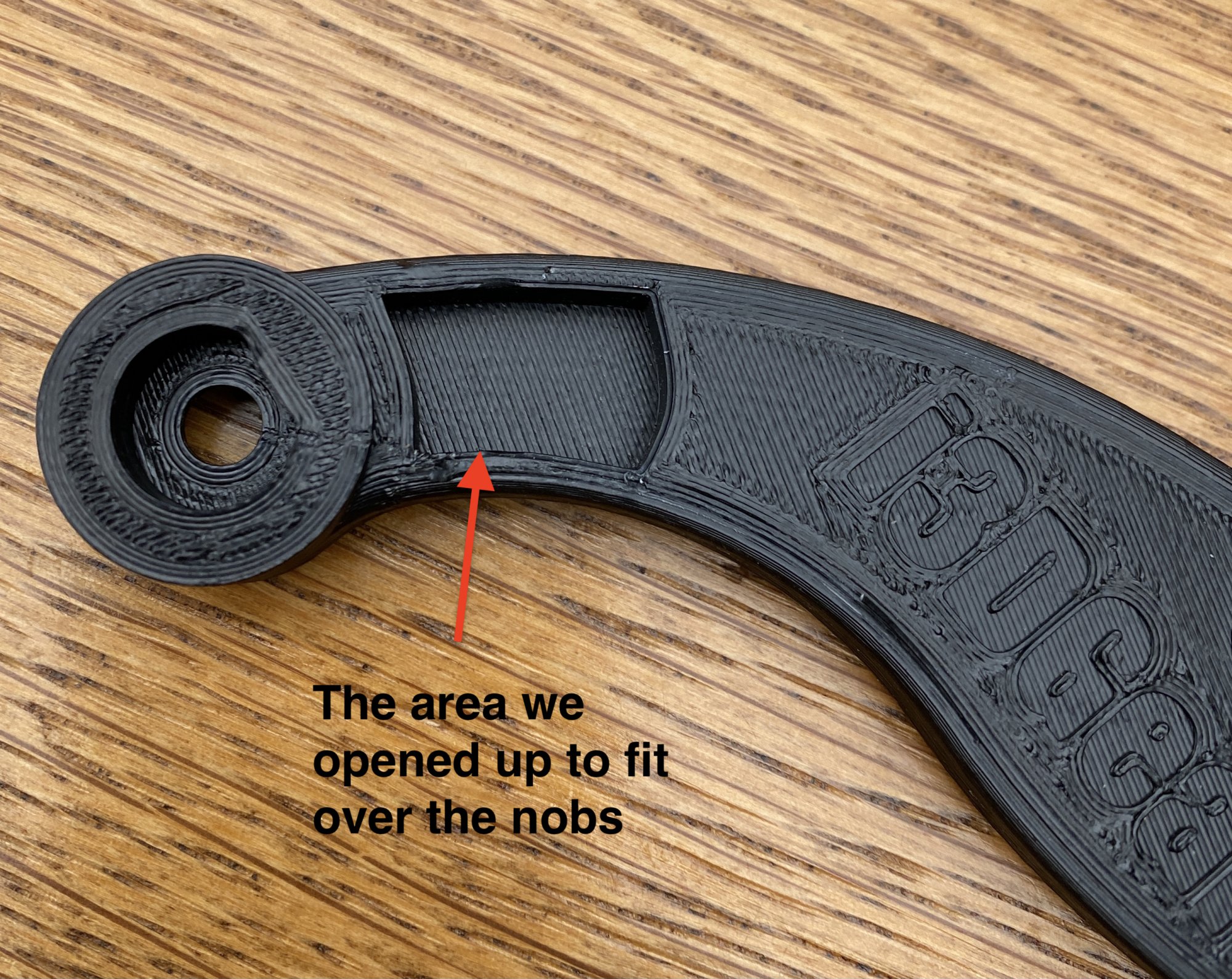

I took the Raymarine clutch handle on the Wheel AP and changed the size of the indent so that it fit over the nob on the wheel. This improved the hold function of the clutch handle.
Did you use a Cad program to draw the clutch handle to input into your 3d printer? Or does Raymarine publish detail Cad drawings of their wheel pilot parts?

Good Question, @heritage. I gave a clutch to Rick of I3dGear. He produced a CAD drawing. We discussed my observations of the clutch function. He produced a clutch. I took it to test. It was an improvement, but it still jumps off the hold-nob in rough water (conditions that produce rudder movement - like a following sea or 1-meter waves). Not sure there is a solution that will work. It needs a lock that can be easily released when you need to take manual control. I have made it work with a rubber band.
