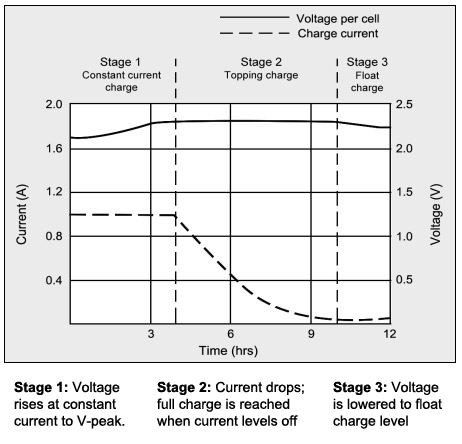

I agree with Jviss's explanation, and it's also consistent with, for example, this picture from https://batteryuniversity.com/learn/article/charging_the_lead_acid_battery
You can think of the battery as a variable resistor, with increasing resistance as its SOC increases. Also think of V=IR. At low SOC, R is low, so V stays low, limited by the fact that I can only be so high (100A in jviss's case). As SOC increases, R increases, until eventually V can reach your set absorption voltage (14.8). Then, as R increases, and V is held at 14.8, I must decrease.

Absorption starts when you leave bulk, which is where you reach your voltage set point. At that transition current should just start to drop from your maximum output. The BatteryUniversity link above seems to say the bulk/absorption transition happens around 70% SOC, but I'd imagine that depends on the size of your current source (with a larger source transitioning earlier).
Bingo!
At that transition
This is the transition from CC / constant-current or maximum charger output to CV or constant-voltage.
Again this is absolutely correct. Once the battery becomes voltage limited charge current has nowhere to go but down..

You can't accurately suggest a Bulk/CC to CV/Absorption transition as a percentage of SoC without also referencing the charge rate. The point at which you attain "absorption voltage" is based on the charge rate.
If you threw a really high current at a flooded lead acid battery it could attain an absorption voltage almost immediately, at 50% SoC. Conversely if we charge it at a very low rate (eg: many PV systems) we won't hit the absorption voltage until a quite high SoC many times well into the upper 90's as a percent SoC...
For example if we charge a high acceptance Lifeline AGM battery at .4C (40% of Ah capacity), starting from 50% SoC, bulk is about 20 minutes and we attain absorption voltage at about 63% SoC. If we charge the same exact battery at .2C (20% of Ah capacity) bulk is about 1:15 minutes and absorption is attained at about 77% SoC. If you charged it at .03C (3% of Ah capacity) from a small PV array the bank won't exit bulk until well into the 90% SoC range.
