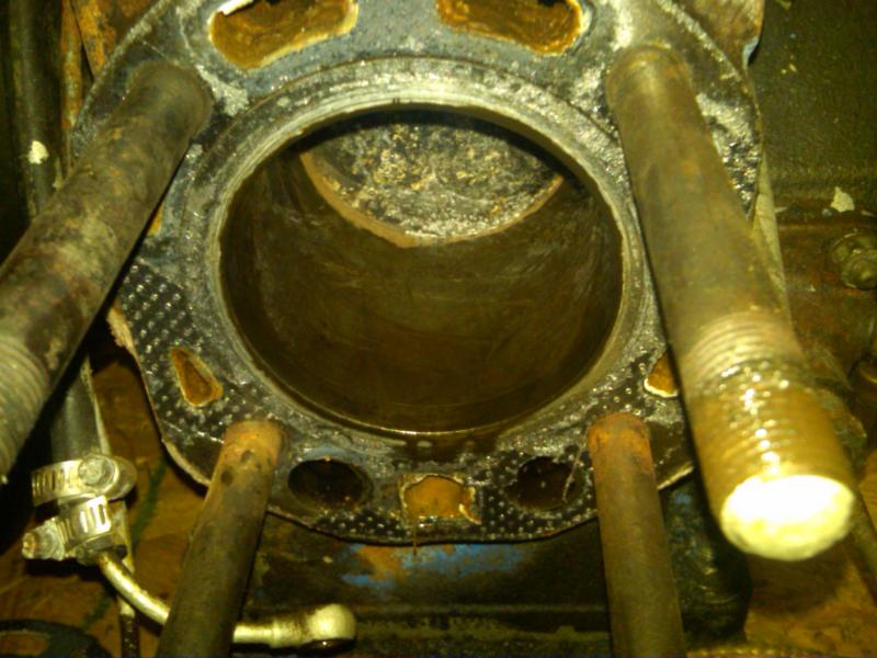

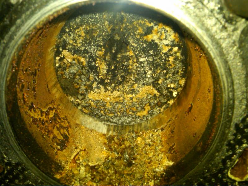

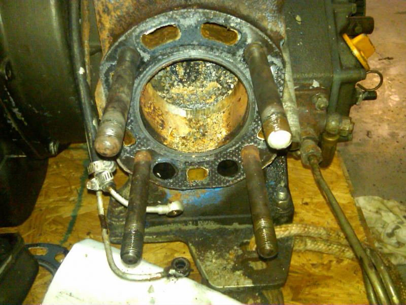

The mechanic has had it for two months or so. Yesterday he said the motor was locked up and took the head off to see why, and this is what he found. He claims the motor had been submersed in water prior to him receiving it.
The buyer says there are no engines outside at the warehouse.
The buyer is going to the mechanics shop tomorrow to talk about it. The mechanic is under the assumption that this engine looked like this leaving my boat. I don't believe an engine could run like this or any where near this condition.
I thought it was astronomical odds that this engine ran flawlessly for 2-1/2 years and the moment I am standing there selling it, the exhaust elbow broke off. What else could have happened to this engine immediately after running perfect for 2-1/2 years, we turn it off and now it looks like this two months later? Cracked block or cracked head as we shut it down?
In your opinion what happened to this engine?
