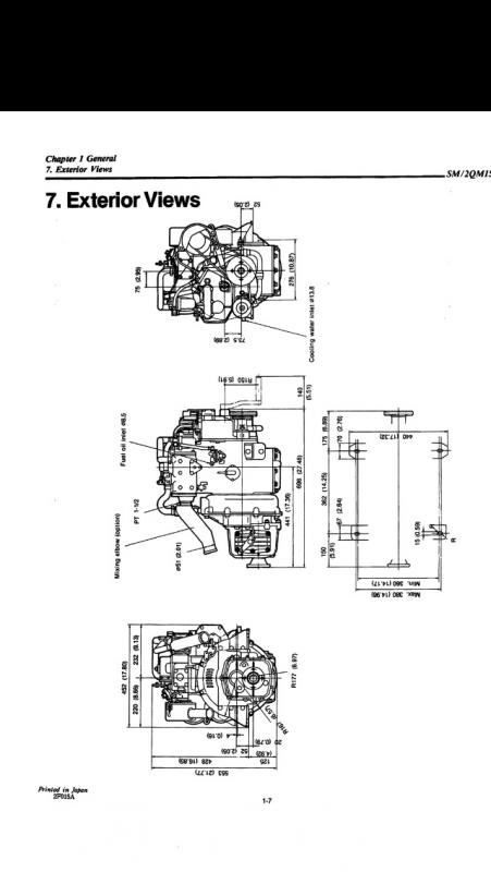

I have a yanmar 2qm 20hp that won't fit and an atomic 4 that won't fit. I'm guessing the boat came with the universal 5411 because of the wide stringers the atomic 4 doesn't even touch, and from what I got from the original owner it had a ysm12 he pulled out. It's not the size of the motors I have that prevent them from fitting it's the fact that I can't get the Trannys to line up with the prop shaft. The prop shaft is a few inches lower than the Trannys. The output shaft is almost level with the engine mounts on my 2qm and atomic 4, is the tranny output shaft lower than the mounts on the universal 5411 or ysm12? What can I put in it that will line up?? Any info will help. Thanks Zachary.

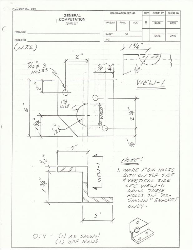

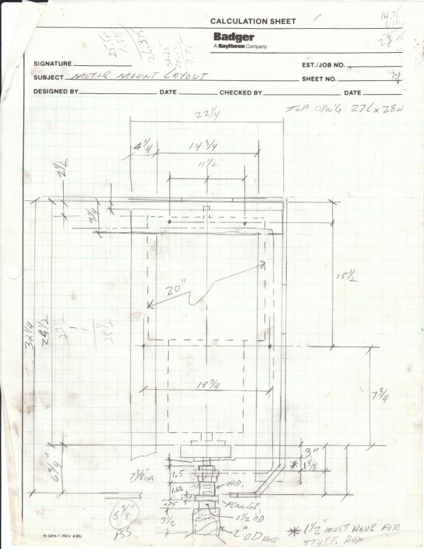

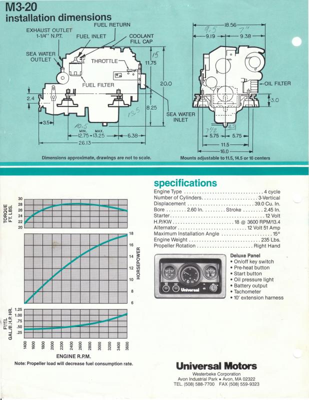

I changed my 5411 to a 3M20A several years back. I had to design motor mount transition brackets. If wanting to use the engines you have, you will need a bracket that lowers the tranny to align with the shaft. Remember if you do lower, because of a shallow space under the engine, you may not have oil pan room.
Here are a couple of my bracket sketches, engine compartment & my engine dimensions that may give you some ideas on how to tackle this job pal.
CR
i like your sketch work there Ron you must be a draftsman of some sort

Nice drawings Ron, you're always the consummate pro.
As far as the A 4 engine, it has to fit. The Atomic 4 was what the C-30 was designed
around. As Ron illustrates, you may have to alter the mounting position with new, custom
mounting plates but the A 4 will fit. Ask Moyer Marine if the oil pan has to modified or had an altered version to fit the C 30.

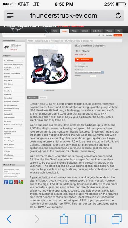

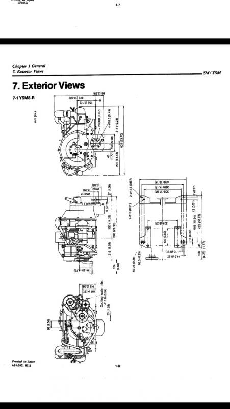

Thank y'all for all the info. And yes captnron great drafting. If I deside to go with the A4 I will make your designed mounts a see if they'll work but I have mixed feelings on using the gasser or saleing the two engines I have and just getting a ysm to make it easier since the tranny output shafts are the lowest point on the engine unlike the a4 and 2qm. Also I was contemplating converting her to electric drive. Any opinions on that?

Electric drive setup. This is the smaller setup. If I go with it I'll go with one a little beefier.

When I repowered, the 25XP was abit too long & I would have to extend the forward engine/setee hatch area to accommodate it. If I remember, I found the Perkins & Yanmar to have a too-high profile or too deep a pan.
I settled on the 3M20A. It wasn't a hard install sans the brackets. I run thru alot of currents & seas & my normal cruising speed is about 5.5 KTS (w/a 3 blade prop). I can push it when needed to 6.5knots but, if replacing an engine, the HP & RPM'S may change the prop pitch for maximum performance. Not to worry, as I have a simple test to see if you need to change your pitch.
