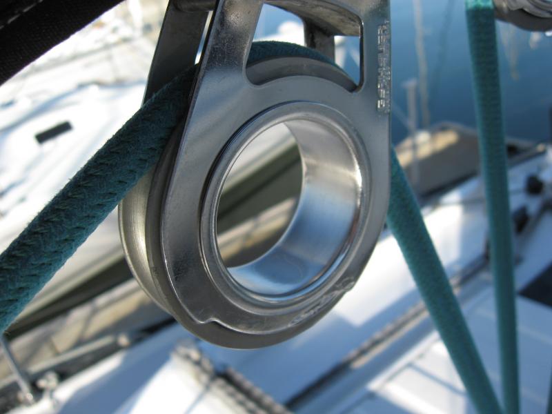

But yesterday, I noticed that my mainsheet block and tackle system no longer worked as smooth as I seemed to recall. Actually that is an understatement. In my hand, the main sheet felt like it was binding or getting hung up. Observing the action on the blocks as I hauled in and let out, I could see that one of the four Garhaurer Delrin ball-bearing blocks on my boom (see the picture) was rotating with a humping motion and also it was obviously locking up when under tension.
