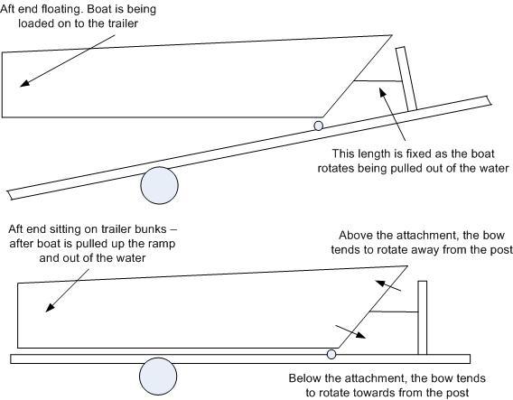

Since you were discussing the trailer loading dynamics, this diagram shows what happens and also shows a slightly different way to deal with the bump issue (Sumners idea will work nicely also).
A key thing to note with this is that when you pull the boat up to the trailer, you tighten the bow eye strap and since you don’t mess with it as you pull the boat up the ramp, its length doesn’t change. The figure below illustrates that as you pull the boat up the ramp, the boat rotates on the trailer. The original stop above the strap will move AWAY from the boat hull as the boat settles on the trailer.. and of course results in the boat sitting too far back on the trailer.
However the very interesting thing is that BELOW the strap, the opposite happens and the bow of the boat moves TOWARD a stop that was positioned below the strap.
Ie, if the stop is below the strap, the bow of the boat doesnt pull away from it as the boat rotates, it actually moves closer or little at all.

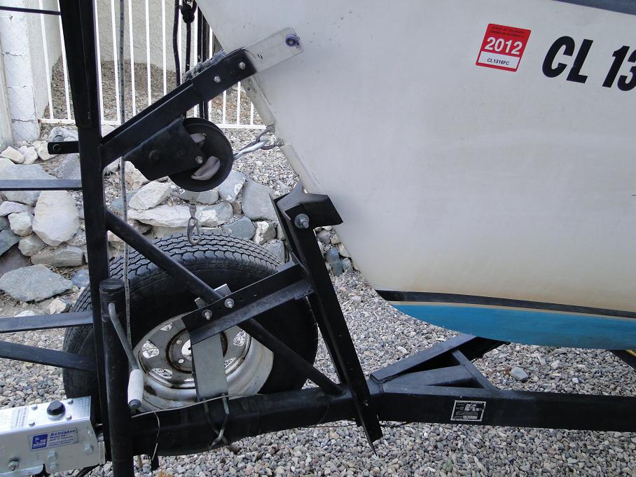

So.. I did try this idea by putting a stop below the strap and it actually does work. I’ve been using it for several years now.. the picture below is after pulling the boat out using the lower stop. No iterations, no bumps and boat is sitting in the correct spot. In the picture below, the old high location stop is just a guide. The boat makes contact with the lower stop when its pulled up the trailer to load.

Yes, another way to fix the problem, too bad Roger didn't do that way back when. I'm sure they were aware of the problem right away. Of course being cheap to the extreme they would of done away with the top one and I think as you mentioned that is good to have as a guide and as an added safety measure as it might actually help keep the boat on the trailer in a small accident.
I know a lot of people use the 'bump' but I just don't like the idea of trying to get 2000+ lbs. moving in what is suppose to be a controlled slide on the trailer.
