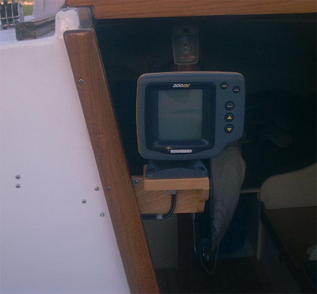

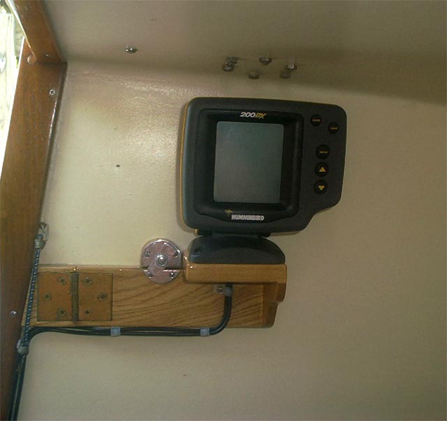

I h ave a fish finder mounted on a swing out arm, using as shoot thru hull transducer which is epoxied to the hull.
Works great. You do lose a small amount of sensitivity shooting thru the hull, but since I'm really more interested in 6-8 feet, rather than 200-330, it never has mattered. And my 1961 dutch built boat has a THICK hull
this pic shows a Humminbird on my old boat, but I've since switched to a Lowrance on Tehani. Same setup though. Pics show stowed, and in use
