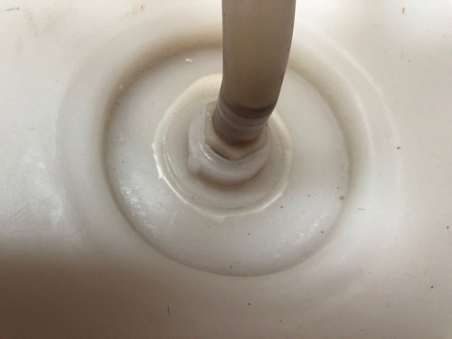

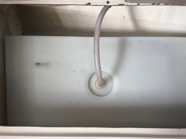

Hello,
I was wondering if the holding tank in my 1990 C30 MKII is a replacement. I see some photos on here that are black, mine is opaque white. Part number is correct, think B123... I see that the opening has about a 1/4” dremeled away, so I was wondering if is newer. I about to undertake a head and hoses replacement.
Thanks,
Ward H

Sounds like a PO replaced the holding tank, 'cuz Catalina has always specified black for waste holding, white for water. And btw...Ronco Plastics has been Catalina's OEM tank supplier for decades. And 321 would be a Ronco mold #.
Which opening has been "Dremeled?" I'm guessing that's a misguided attempt to repair a tank fitting that cracked due to over-tightening the male thread-barb hose fitting.

I was guessing that it may have been replaced, and it is clear/opaque.
I plan on replacing the toilet (head), and the hoses, and I would like to increase the vent as well to route to a bulkhead thru-hull as Peggy suggests (following this thread). Can you re-use the original vent hole instead of drilling a new one?
