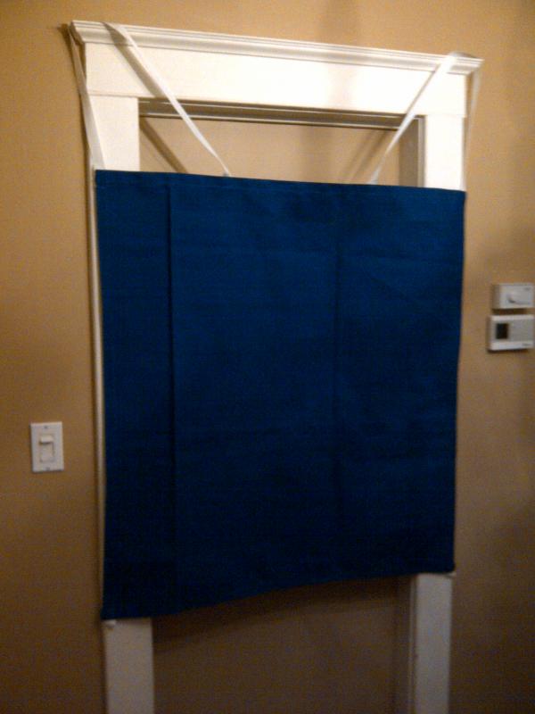

I made one like what you can order form SailRight. They have an instructional video on how to do it. Very easy! It cost about $15 in materials.
Her is a picture of mine hanging in the dining room. I haven't had a chance to get it on the boat yet.
