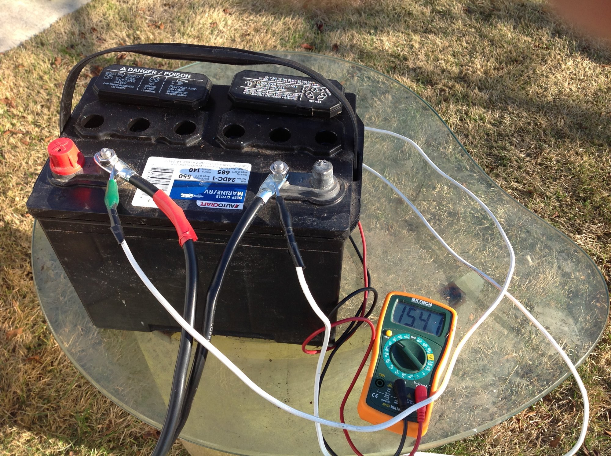

I completely agree with you Richard, captcoho, shemandr. It's all about giving back. Even through Rod's recovery he's still helping others. That MaineSails article outlines the equalization process completely. Straight forward easy to read. I hope it helps others in doing an equalization on their batteries as well. I'm equalizing an old battery I have as I'm writing this response to test the equipment I have. After about 2 hours now, the specific gravity is almost equal in all cells. I'll keep checking.

What's your open circuit voltage on that set-up?

Just sitting in my garage (1 year) with no loads on it at all. Voltage was 12.38 v. So, approximately at 70 % of capacity.

Sorry, I meant what's the open voltage on your charger before hooking to the battery.

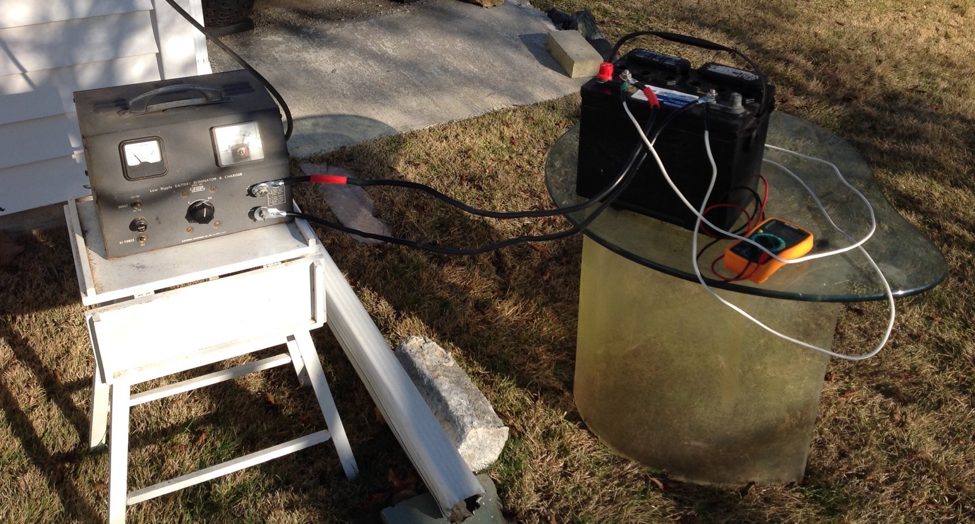

The DC voltage is +\- 18 V The DC Amp is 0.5 Amp
Prior to starting I had Specific Gravity readings of 1.250 (2 cells) to 1.270 (4 cells)
I'm about 3 hours into the process and have Specific Gravity readings now of 1.275 in all but one cell (which is 1.265)
This was a much older, unused battery so I figured it was a good test subject.

A modern charger that has automatic equalization is a very good idea. If you REALLY want to do it by hand, here is the info you need: Leave the battery in its box or put it in an old cooler. Cover it loosely with a thick rag or old towel. The objective here is to contain flying acid in case the battery decides this would be a good time to explode. Raise the voltage to 15.6 volts for 15 minutes, no more. Your old Eico may not be "man enough" to charge a Group 24 battery that hard. It was really intended as a bench accessory for auto radio repairmen. Remember that you are deliberately abusing the battery plates to expose fresh lead / lead dioxide. It is better to underdo this treatment than overdo it.
I strongly disagree.
For flooded lead acid batteries, I find that it will often take many hours to properly equalize the battery, depending upon state of sulfation.
Lifeline specifically states for their AGM's to perform this for a 4 hour cycle.
This is not correct, as long as you have excellent control of voltage and current. With proper controls, you are primarily breaking down lead sulfate back into it's respective lead and sulfur.
Your open voltage is too high. Can you turn it down to not exceed 16.2 volts?

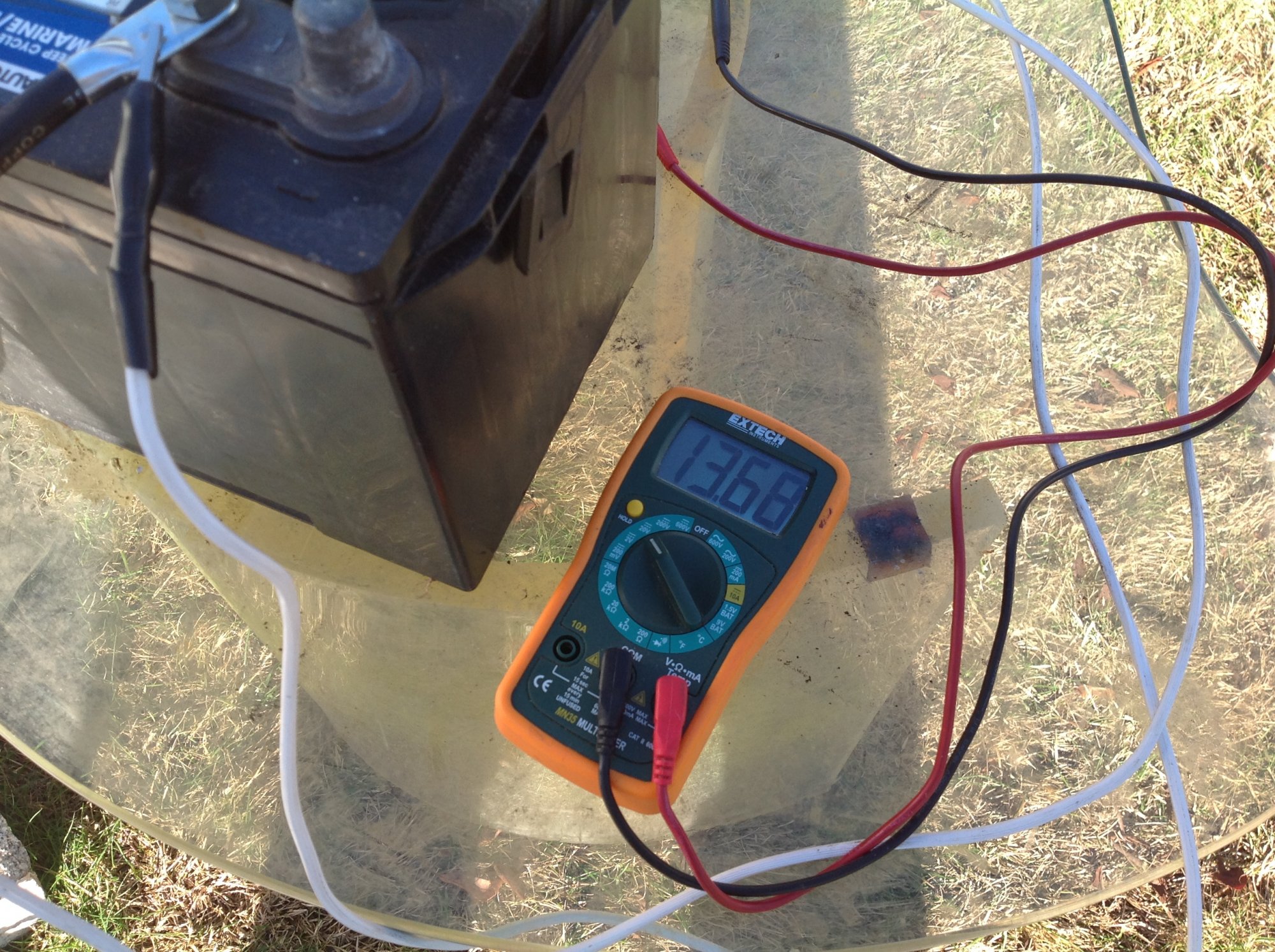

I did dial back the voltage to 16V. I've been in and out checking this battery for the past 4 hours as it progressed.
I now have an equal Specific Gravity in all cells of 1.275. And an ending voltage of 13.68 - 13.74 V. That's leaving out right now at 13.68V.
So this battery is done and I will be checking it as the days go on.
I'll start my 3 others in the next few days.
Do you know what the ambient temperature is right now where you are? It's really more for a data point. Specific gravity is the best way to check this. Nice!

It’s 42 F.
I will really know my end results over the next few days and going forward from here. But it’s a straight forward process and I do suggest a new modern DC Bench Top Power supply for accurate readings, if you’re are going to make this one of your maintenance projects.
