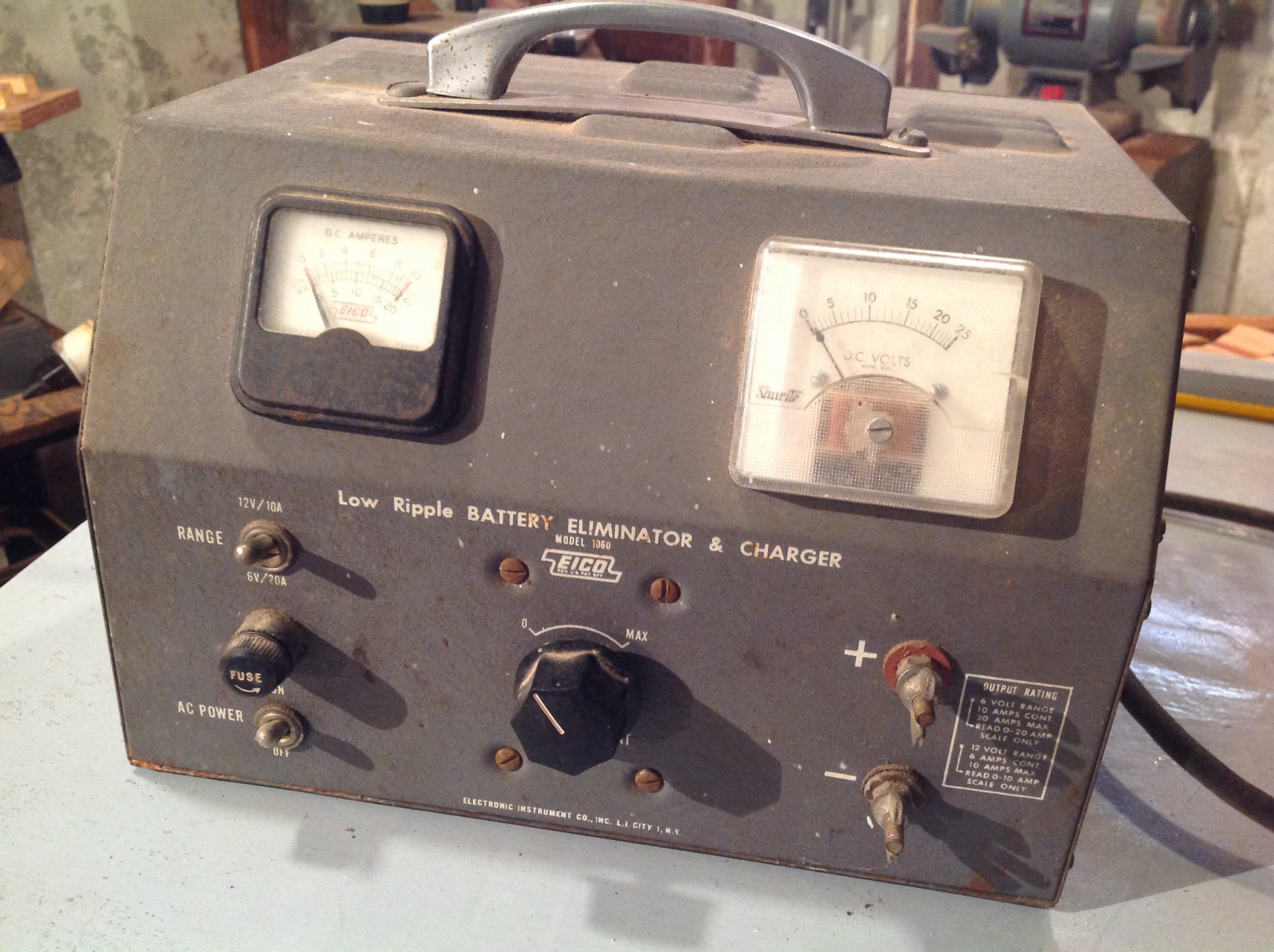

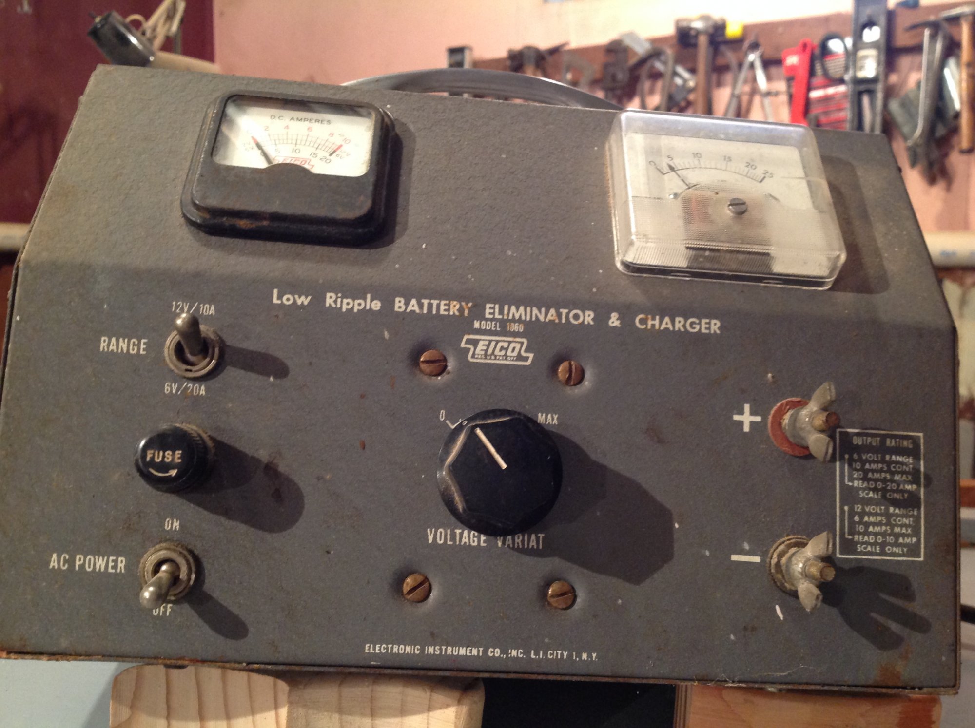

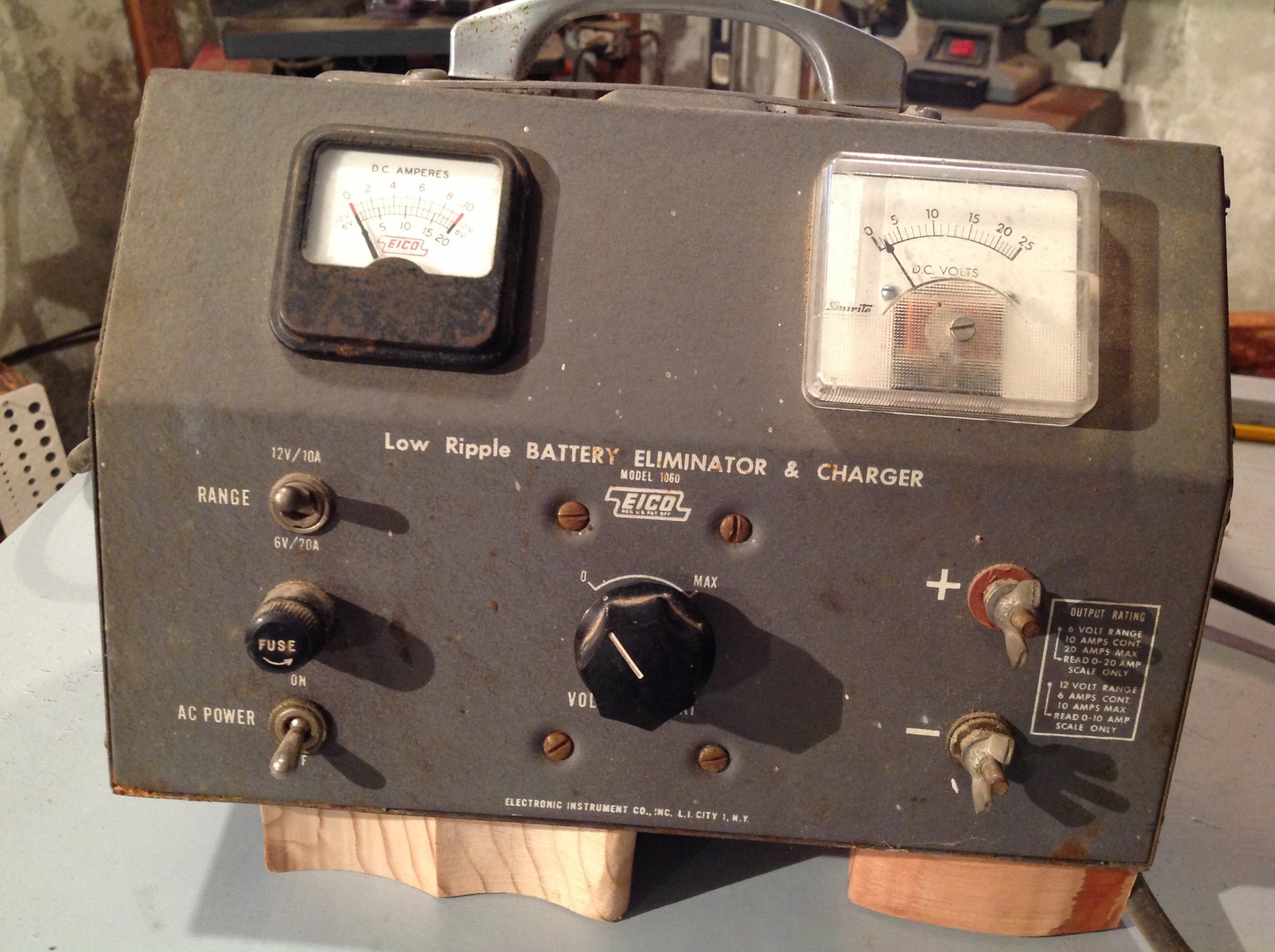

I have 3 Group 24 Interstate Wet Cell Batteries I would like to equalize. My basic run of the mill car charger does not have a setting or voltage for equalizing.
I do have a bench top Battery eliminator though which does have various ranges. Curious to see what others use, techniques and if you would use this battery eliminator.

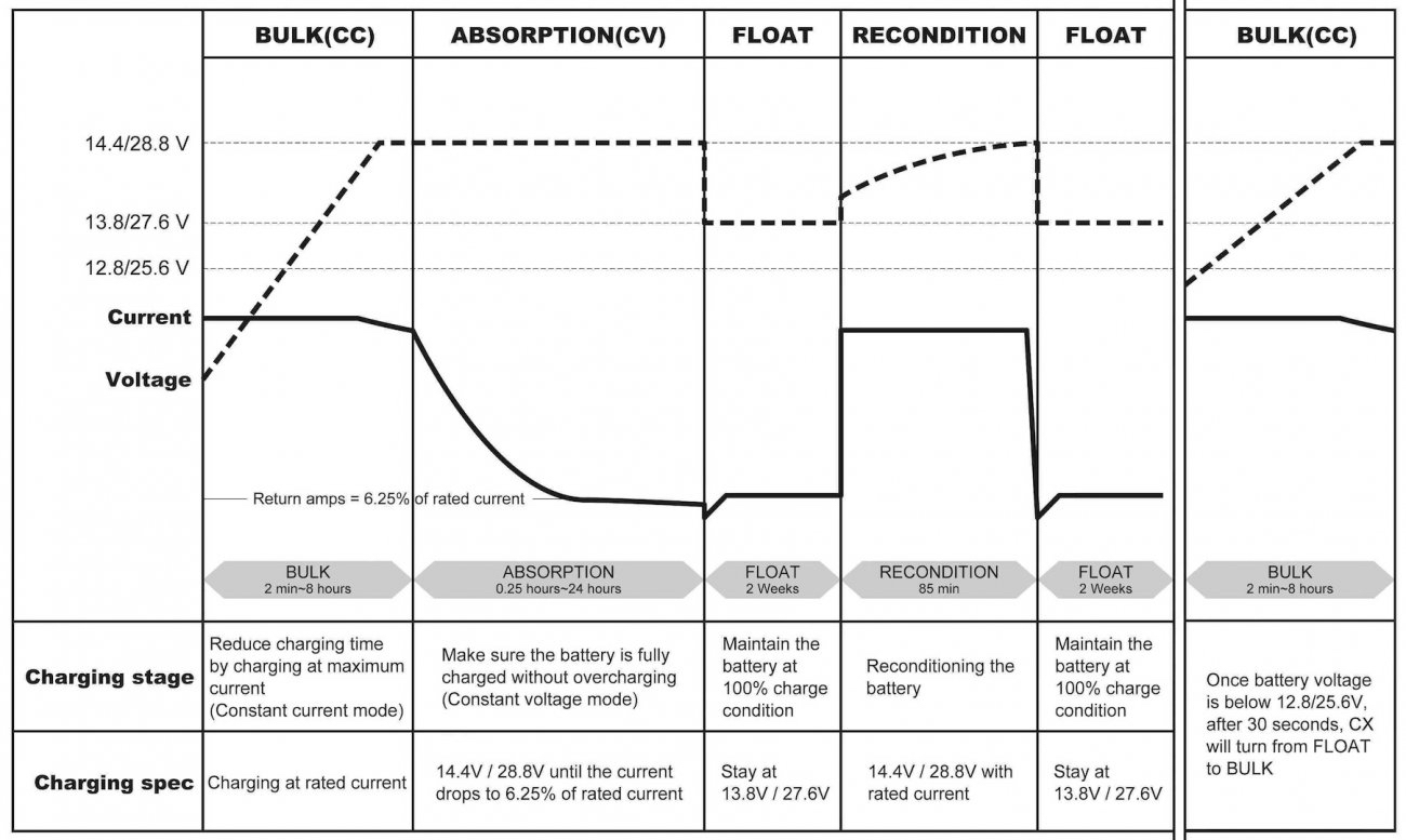

This is a good example of a boat battery charging curve.
The "Recondition" = Balancing on two parallel batteries of same age and type.
Note the Current flow or Sustained Amps and time on "Balance"
Jim...

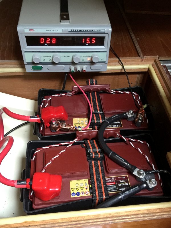

I use a research grade Lambda power supply that is programmable for both current and voltage. That power supply will control voltage to the nearest 0.01 volts, and the current to something like 0.1 amps. You don't need that precision for the amps, but you should be able to control it to about 0.5 amps. There is an IEEE standard that talks about equalization, I'd have to go dig up the exact number, don't recall off the top on my head.
@sailcapt340 - for your flooded lead acid batteries, the equalization voltage should be between 15.6 (IIRC) and 16.2 volts. I don't remember if the the lower side is 15.6 or 15.8V. I just set my power supply to 16.0 volts. One thing that has never been clarified for me, is when is the "end of cycle" for the equalization phase. All chargers I'm aware of that claim to perform equalization use time as the end point.
As far as if the device you've got would work, I'd check to see if the voltage output is sufficiently stable and if it falls within the range stated. One concern is the current output, which seems a bit on the high side. When running it, be sure to check the temperature of the battery, it should not get hot. It it begins to get hot, turn your device off. I control heat by controlling current.
dj
p.s. I just looked on ebay and there are numerous options - here's one that looks like it would work well.

Maine Sail mentions using a DC power supply to equalize batteries in this article:
Blitz
Jul 10, 2007
717
Seidelmann 34 Atlantic Highlands, NJ
I use a VOLTEQ HY3020EX DC Power supply, using a techniques that Mainesail outlined years ago.

Yep, that is a battery "eliminator", literally. What you have is a manual bulk charger that unless monitored very closely could very easily overcharge and damage the batteries. I could see one use for that charger, when a battery is so depleted that a modern smart charger would fail to respond the old work horse could surely put some charge in it.
