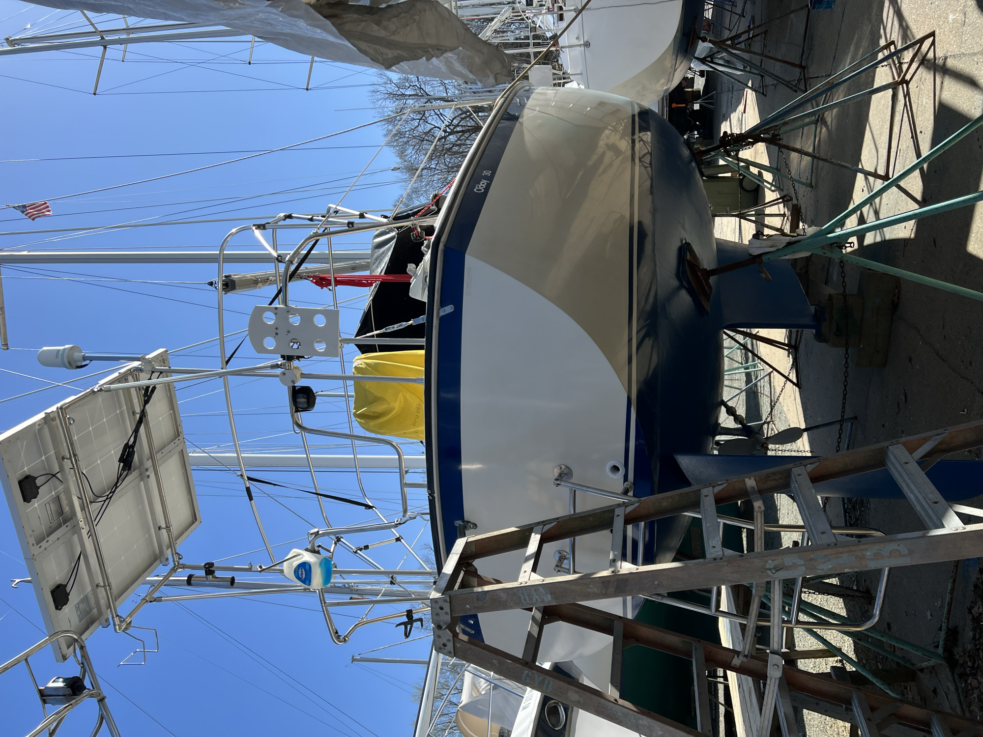

Also installed a 375W LG solar panel on Kato dingy davits w/Victron controller- seems to be working fine so far.
