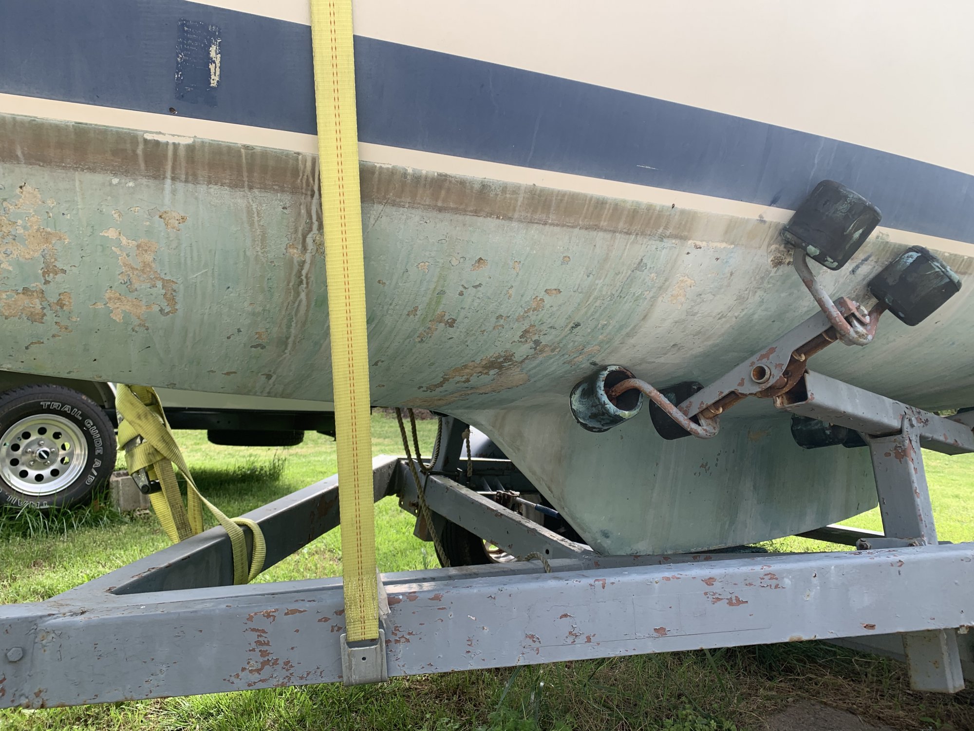

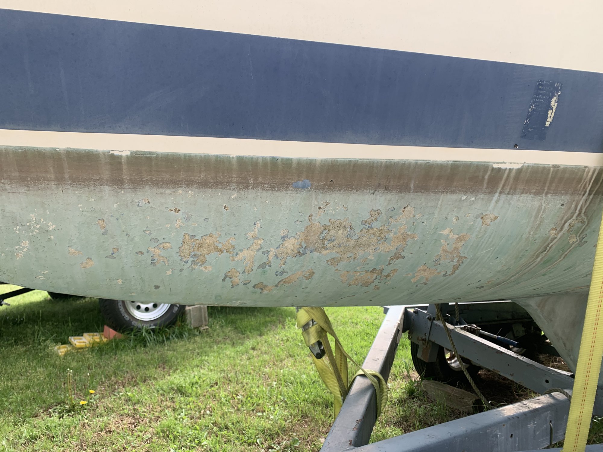

I purchased this boat over a year ago and due to a neck injury have only sailed on her once. The previous owner kept her in the water during the season in Lake Erie most of the time and routinely kept her bottom painted with an ablative. Here in North Carolina she will be mostly in freshwater lakes for no more than a day and when at the coast only in brackish to salt water for no more than three days at a time. As I have planned many projects around this boat as I heal up I couldn’t help but think that I really dont need a bottom paint on her. From the posts here it sounds like I am correct. When I asked a painter at the boatyard about it, she said I did need the bottom paint but couldn’t give me a reasonable answer as to why. My question is this. What should I have done to this bottom to make it right for my expected sailing conditions ? Recognize , I can’t do the work but I would get it professionally taken care of. Sand all the ablative off and wax the gel coat bottom ? Or do I need to invest in a hard bottom type paint over the gel coat ? Here is what she looks like at present.

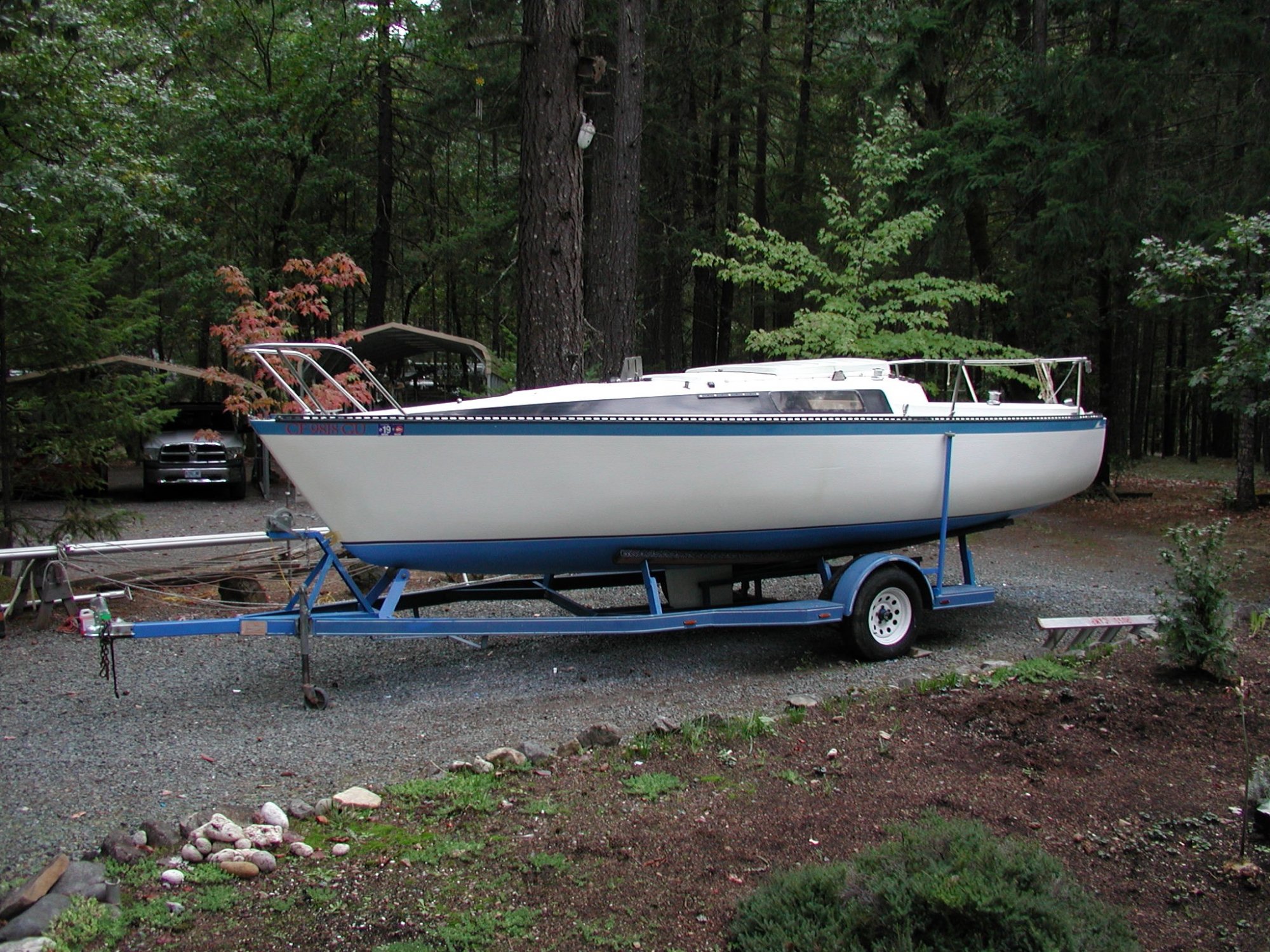

First off @David T/ODay23 . Welcome aboard the SBO forum. lots of good stuf available here. normally you will want to start a new post in order to get an answer to your question, but I'm done re-painting my project, so no harm there as far as I'm concerned.
I did end up buying the Merit last fall and spent many hours getting it ready for this season. but then....... here we sit :(...................... the bottom on mine was in similar condition to yours and was too far gone to just clean up and wax, so prep and painting was the only option to make it look decent. I do my own work, so I did have more options than you, but I ended up using a swimming pool paint on mine and have been very happy with the results. it's quite a bit less expensive than your typical boat paints and sprayed well with my airless sprayer (could just as easily roll or brush if desired). depending on who you have re-do yours, you may have to use whatever they typically use however, and most boat yards will want to use the VC-17 recommended to me above.
All that being said...... If I were you I'd get that boat ready to sail, minus the bottom paint, and prepare to get on the water in a month or so. you've already lost over a year, and a bottom job won't be quick to get done with all that's going on. just a thought. :)

Go after it with a handheld orbital sander and 80 grit. Right down to gelcoat. Blow the budget on 2 gallons of IP000e and be done with it.
That is not a workaround, rather a solution. The IP2000e will provide a nice barrier coat, look good for years and survive a regular pressure washing.
