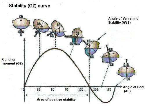

'Self Righting' is a grossly miss-used and miss-understood term in the context of displacement monohulls. ALL monohulls will happily sit inverted forever in flat water.
The GZ curve, which measures stability and righting will always show an area where the boat wants to sit upside down. Generally, the beamier the boat the larger this area is, but its typically around 25 degrees from 180 (upside down). In real life it takes a wave to roll it back over... but much smaller than the wave need to roll it in the first place.

Thanks Jackdaw, that's great information, but I was curious about the relationship between speed and stability. I don't see the correlation.

What Don said used to be true in yacht design, and actually is in the majority of yachts in existence today. With conventional yacht displacement hulls, the best and most straightforward way to get more 'speed' was to increase the SA/D (sail area to displacement) ratio. This created 'tender' boats that were faster at getting to hull speed, but often needed crew on the rail to keep them upright, or be reefed much sooner. Race boat SA/D ratios traditionally start at 20 and most cruisers are like 16. Higher obviously 'faster'.
More modern designs often use beam to create much more initial stability, and innovations like lightweight construction and lifting keels to put the majority of the ballast 10 feet under the hull. This creates cruising boats like the Pogo 12.5, a 40 footer that a couple can easily sail at 15 knots. While it has a SA/D ratio of 35 it is immensely stable. And fast.
