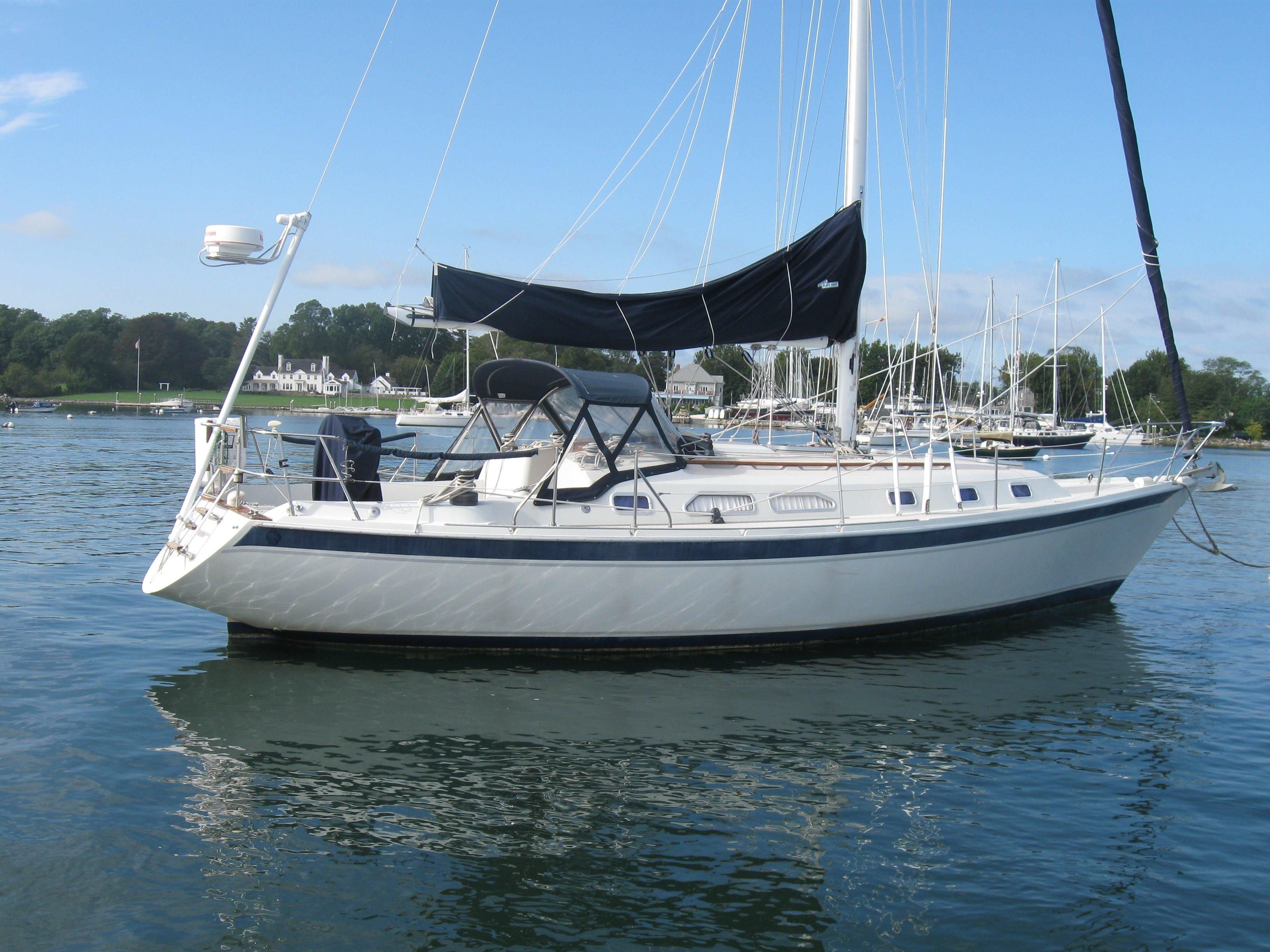

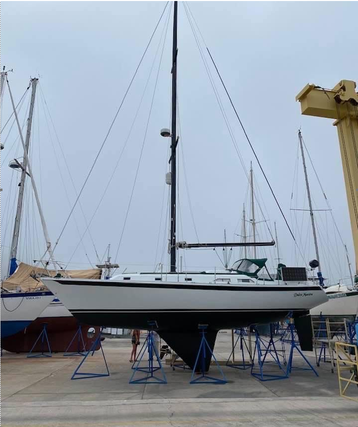

Does anybody know what this boat is? Interesting keel.

So that is what's called the "competition keel" - Ericson's are quite nice boats as I recall. I've two friends sailing in Mexico at the moment, I'd ask them what their boat is but they are out of contact right now and won't be able to be back in contact for a month or 2. They sent me this photo last time they had internet access and I just didn't recognize that keel. I'm familiar with the standard keel on these so this threw me a curve ball. Thanks much for the input. That's great!

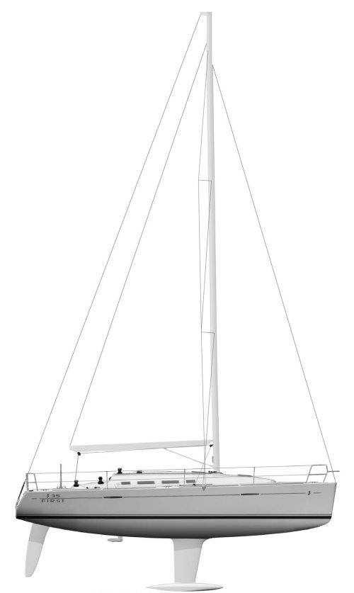

Interesting how the notion of 'competition keel' has changed over the last 50 years! Viewed with today's eye, that keel is all wrong. Stubby and long that generates low lift, and fat at the top, where it undesirably concentrates all of its lead. New performance boats turn this around; long thin foils generates max lift (think U2 wing) and all the weight down low.

The keel does put a hurt on the eye. And the likely designer is Bruce King-who is very reputable. I guess that keel was born in the notion that reducing surface area was the next step forward. The keels of the day weren’t really foils either - for example my Ranger29 or even the Cal line. So I’m hypothesizing that the Competition part comes from reduced drag over the keels of the day. Probably were counting on a large amount of meat on the rail. A dock neighbor had one. I never saw him sail upwind. Reach out, reach back. The boat was very good at that.

FWIW that E-38 will pass up a herd of more "modern" performance cruisers. Like others I have always thought that Bruce King should have used a shape more like our boat's elliptical keel or maybe a Petersen keel, but it just works.
