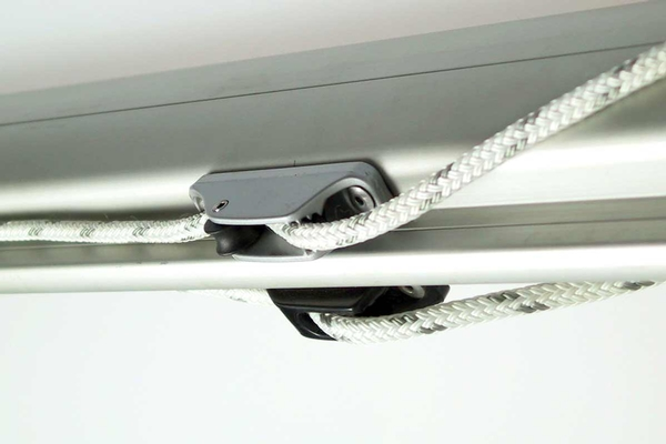

Thank you I know that I'm unsure how to unscrew it from the boom im not sure what I need to use
The photo is not clear but that appears to be a rivet head. If so, it must be drilled out, or ground out with a rotary tool such as a Dremel.

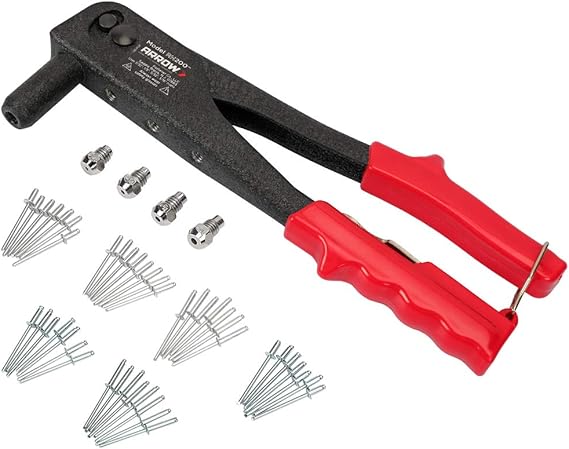

You can replace it again with a pop rivet. If you need to buy a rivet tool I suggest you get one with long handles. The ones that have small handles like pliers are cheaper but much more difficult to use (requiring a lot of grip strength).

Here's a simple pop rivet tool that should be adequate for your needs... aluminum rivets are softer that SS and you'll have little trouble operating the less expensive one. Under $20 anywhere. The one pictured is from amazon.com. But any hardware store will have a decent selection. Don't waste money on an electric model or some other fancy tool........ unless you're going into the boat repair business! :cool::biggrin:

Seldon and other mast manufactures recommend, use, and sell monel rivets. Most beach cats, including Hobie, use monel. Aluminum sounds good, but in fact is more prone to corrosion and much weaker (which is why it is easier). But that is only what I have observed over the past 40 years.
It look like you will need a nose extender on the rivet gun to fit in the narrow channel. Depends on the gun and the nose piece shape. A stack of nuts or washers can work.
I would not chose aluminum rivets for a highly loaded item like a clam cleat.

under $50 - do a web search on long handle rivet gun
