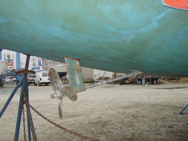

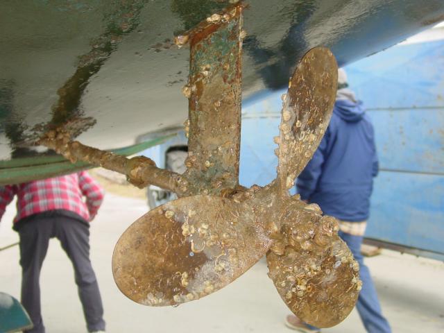

Here is a copy of my PHRF. I didn't have any exact measurements when I applied for the fixed prop credit. What they want to determine is if the prop is out in the open or in an aperture, and if you can turn the blades so they are hidden by the deadwood. The 310 with the OEM fixed 3 blade RH15x9 prop will qualify for 9 secs on ches bay with the exposed shaft and strut. You should be able to submit a picture if you don't have exact measurements. If you are going to race, make sure it is cleaner than this one was.:)

Still have no idea on measurements but got the PHRF
It is 186 like you all stated.

Things we don't always notice at the time
OMG, that is a crusty prop. Up here on the Potomac the water is fresh as we don't have near the barnacle problem. I was looking for some old posts from Witz on his transmission travails and saw this. I did get my PHRF and it is 186.
