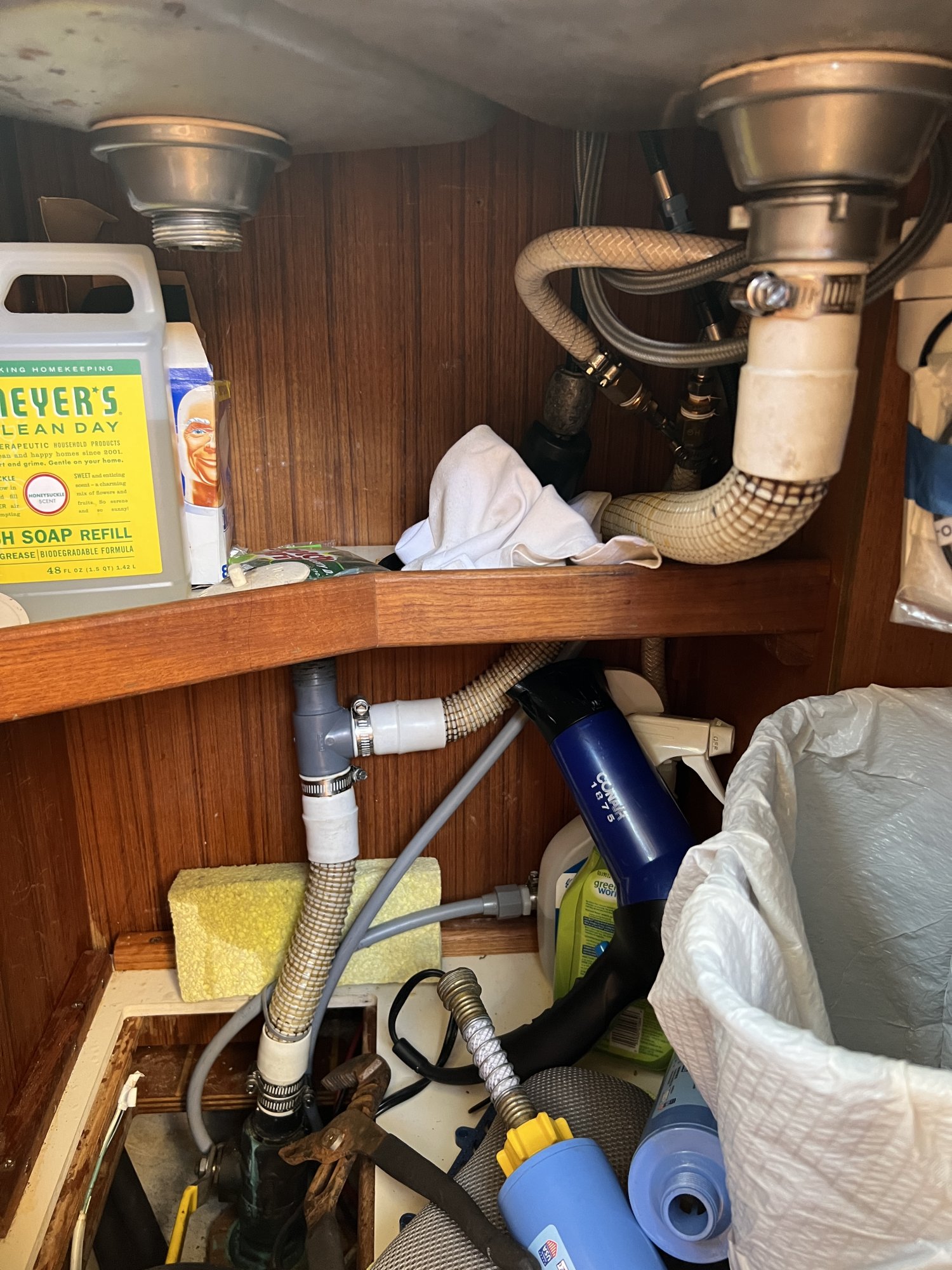

Yesterday I finished installing new drains in the galley, it was a bit complicated because of a T in the drain for the refrigerator condenser cooling. I used 1 ¼" 147 and ¾" 147.
The hose is thick and does not easily slide over fittings. I found boiling water worked well to custom fit the hose to the fittings. Place the end of the hose in the hot water (boiling or near boiling) in a minute or two it will become soft and pliable. With a little K-Y Jelly on the fitting the hose would easily slip on. Let the hose cool and remove it. It will not shrink back to its original ID. Repeat the process for the other end. With the ends molded to the shape of the fitting the hose can be more easily maneuvered through tight spaces and will easily slip back on the fitting.
The hot water evenly heats the hose on the inside and outside this makes it more pliable. Temperature can also be better controlled than with using a hot air gun and it is much faster than using a hair dryer. Hot air methods tend to over heat and dry out the outer portion of the hose while leaving the inner surface too cold to stretch over the fitting.
