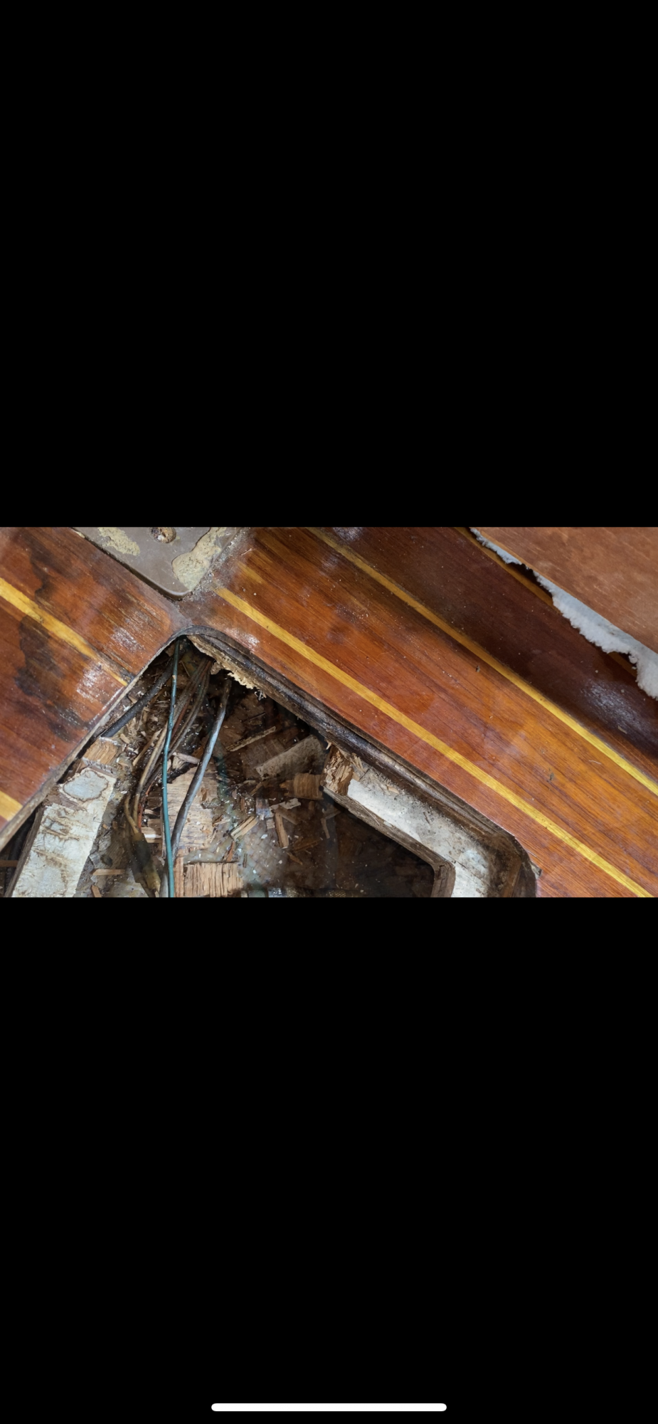

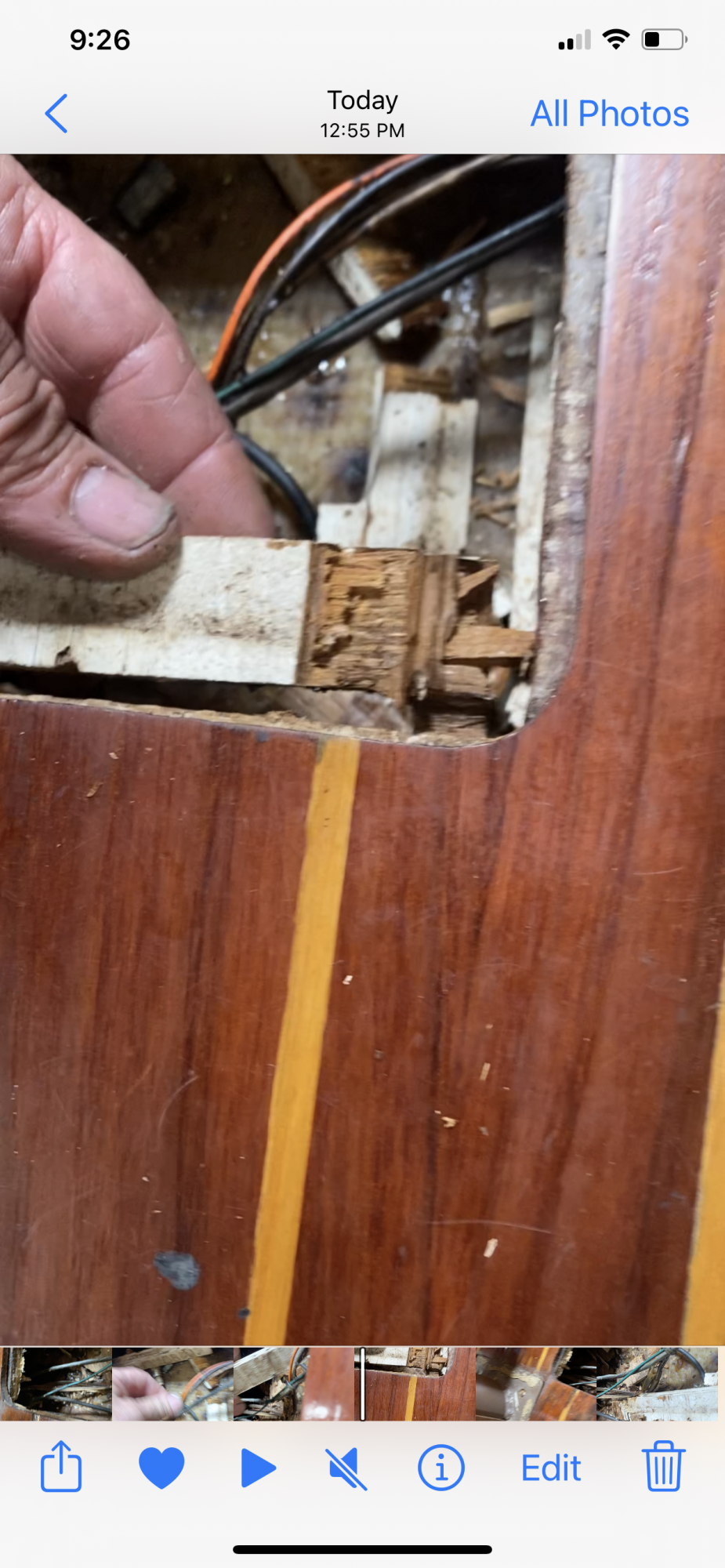

I got a 1979 S2 9.2 c. The floor under the compression post is very wet. Do I need to remove the mast in order to fix the problem?

Pictures would help diagnose. Is there just some sitting water in the bilge there that hasn't drained or been pumped out? Or is the support structure for the compression post rotten from sitting in water?

Is the deck (where the mast rests) concave?
does the bottom of the compression post sit on a wooden base?

Yes the bottom of the compression post sits on a wooden base . The support got rotten

Pull the mast. Then pull the compression post. Rebuild the pad for the compression post and reinstall the post and rerig. You do need to ascertain if any deck delamination occurred and deal with that before reinstalling the mast. I know there have been several 9.2a boats with this issue. Make sure limber holes/tubes are clear.
