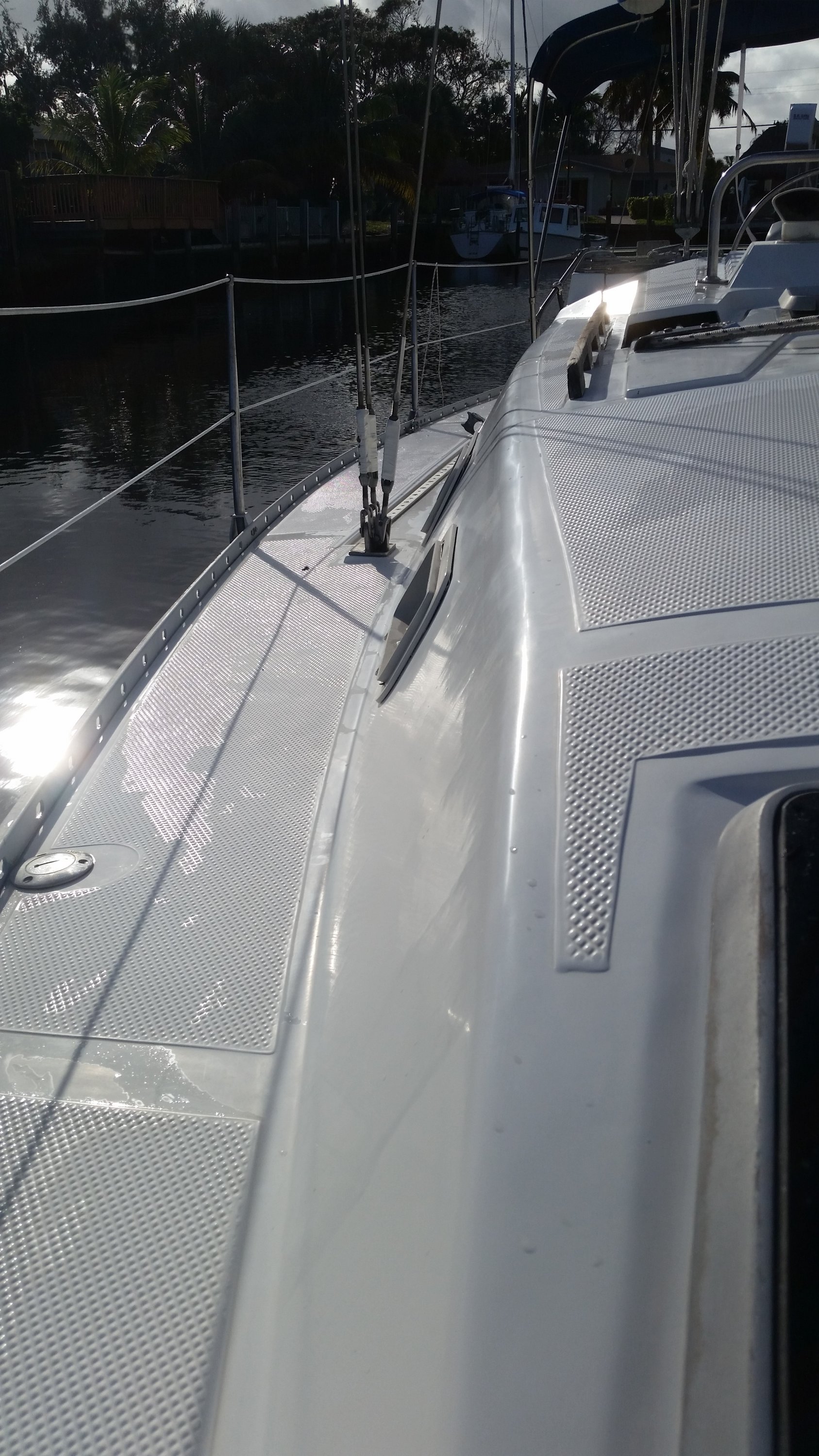

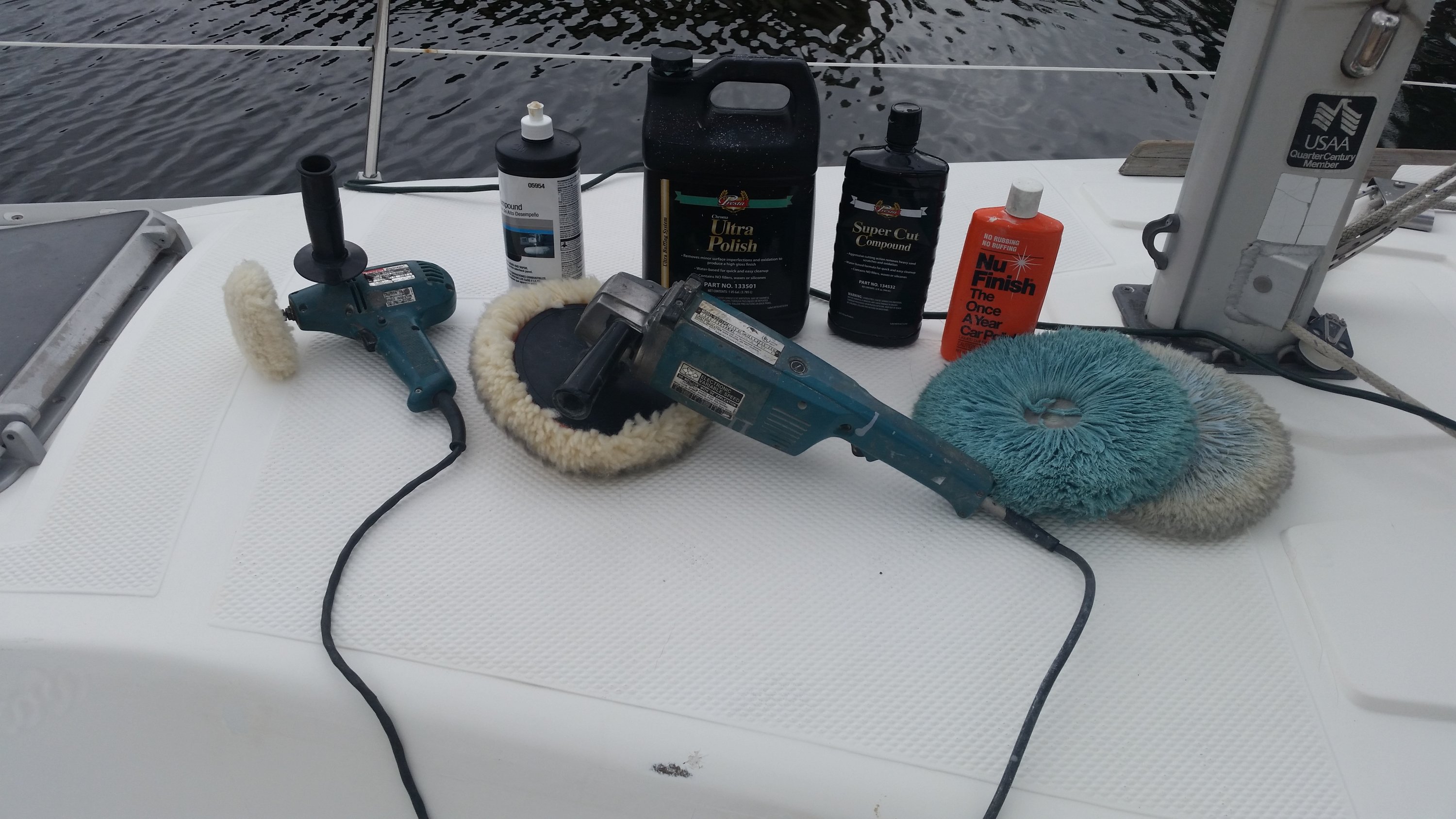

For the deck area, I found a small 3" high speed sander at a pawn shop, and bought a Velcro backing plate and wool pads to fit it. I used the large buffer for large areas, and the small one for tighter areas. you will still have to do some of it by hand depending on deck hardware spacing. Below is a picture of the tools I used.
I think I got pretty good results, but I learned a lot along the way, and may go back and redo the buffing stage to several of the early areas of the deck.

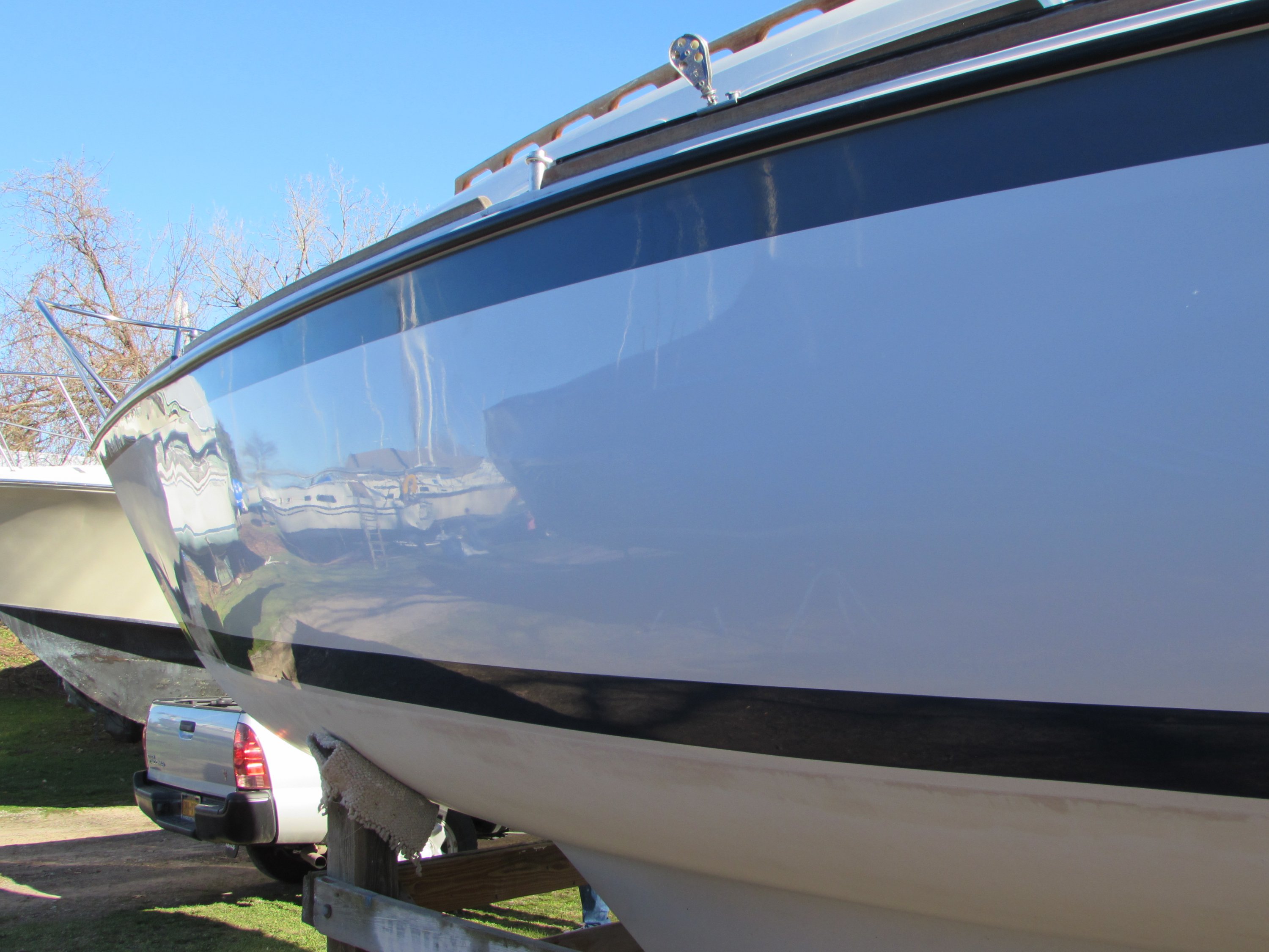

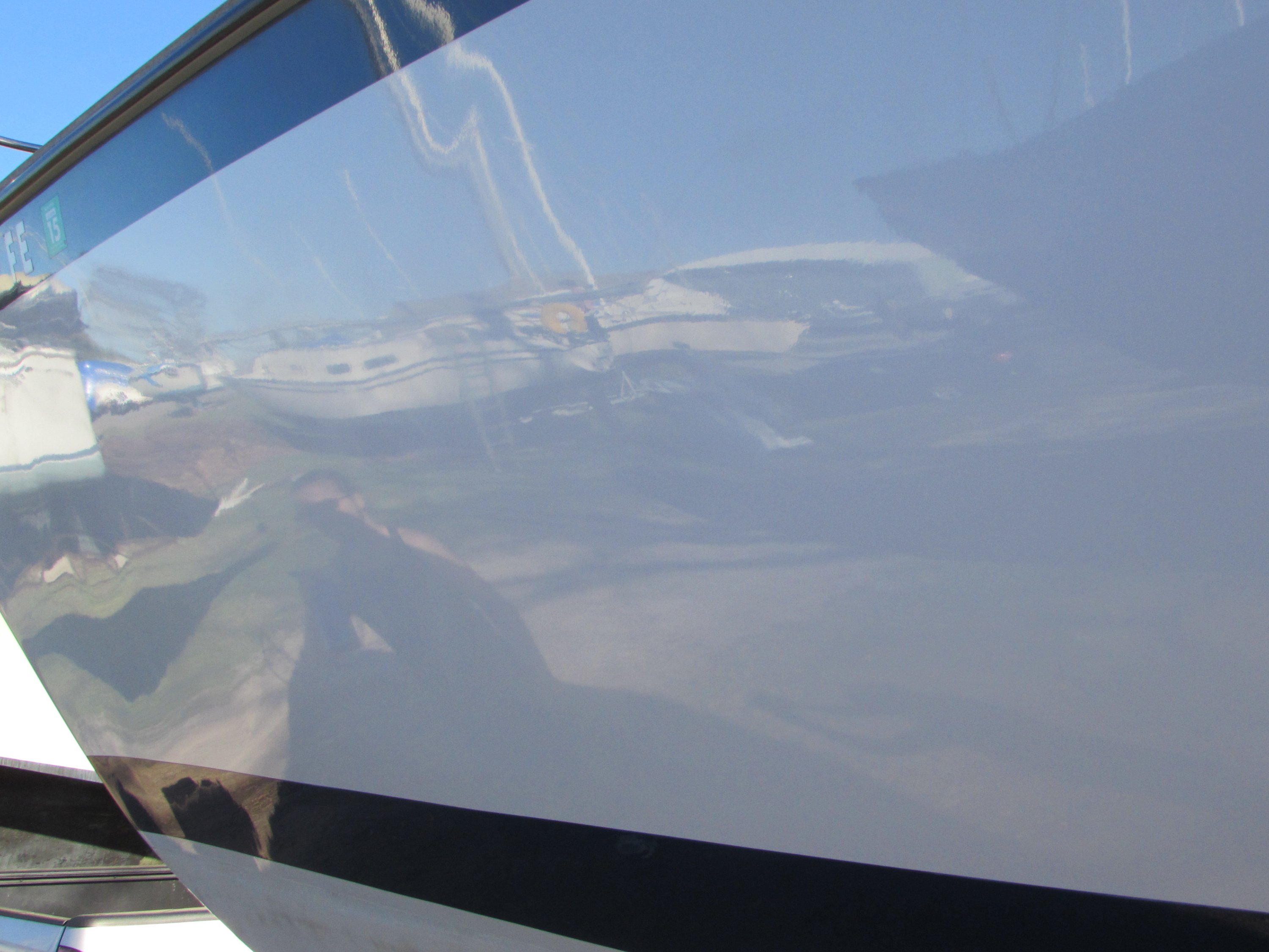

I am waiting till I haul out to do the hull, but I did try a test section. by hanging over the side.

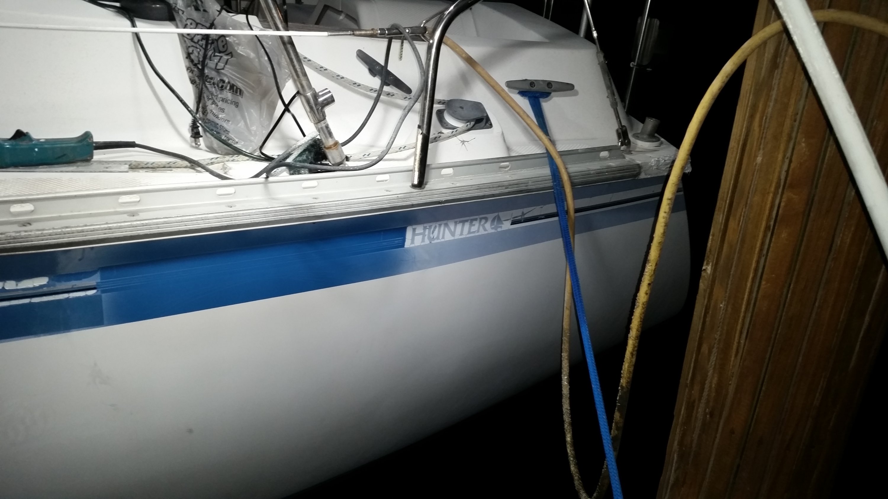

My stripes were blue gel coat with multiple white/blue/silver vinyl stripes on top. The vinyl was cracked and bad so I am removing. however, I was quite pleased with how well the blue gel coat portion cam back. In the picture above, you can see how faded it was before.

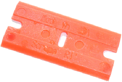

A razor scraper with plastic blades

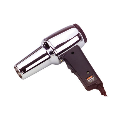

An old heat gun I had from working on RC airplanes.
Heat the vinyl until the adhesive gets soft in small sections and then scrape with plastic blade. DO NOT overheat, and DO NOT use metal razor which will scratch the gel coat. (I found the metal razor tip out the hard way).
