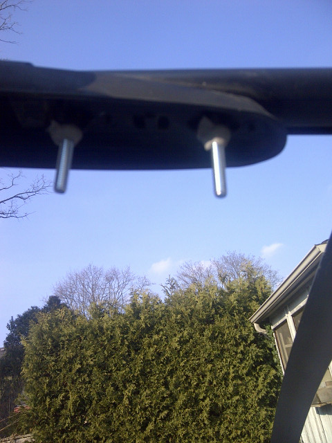

Welcome to the site. There is this stuff called Butyl tape. Great stuff! You will only need a roll.
I found every piece of hardware on top of my boat leaked into the cabin. I could almost predict rain by looking inside the bilge! Butyl It fixed all that! Here is a link. http://www.pbase.com/mainecruising/butyl_tape

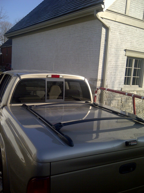

I even used it on my truck.

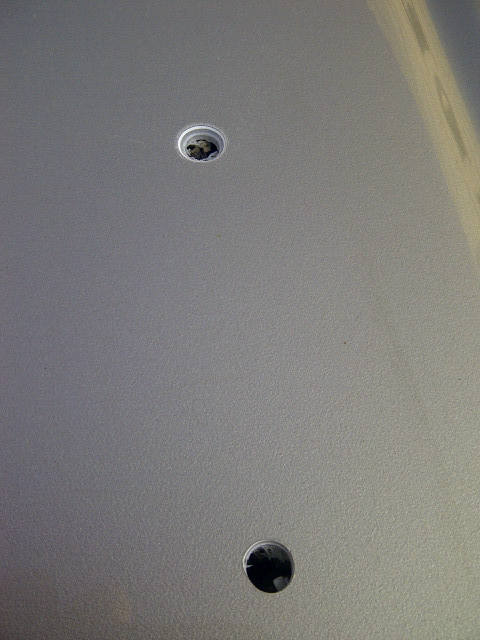

Note: First picture, top hole is flanged or tapered correctly. Bottom is not.
