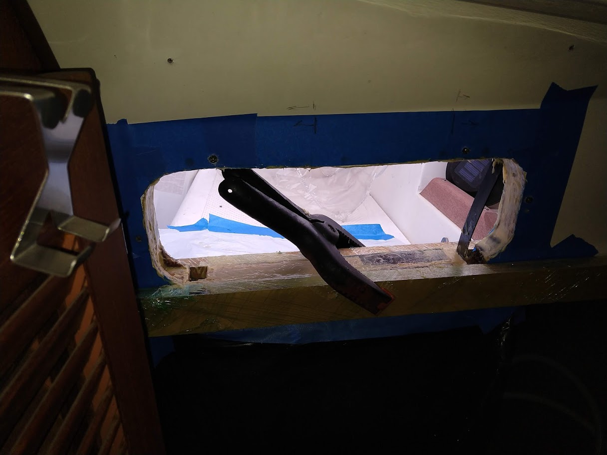

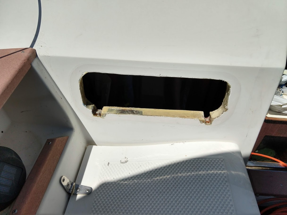

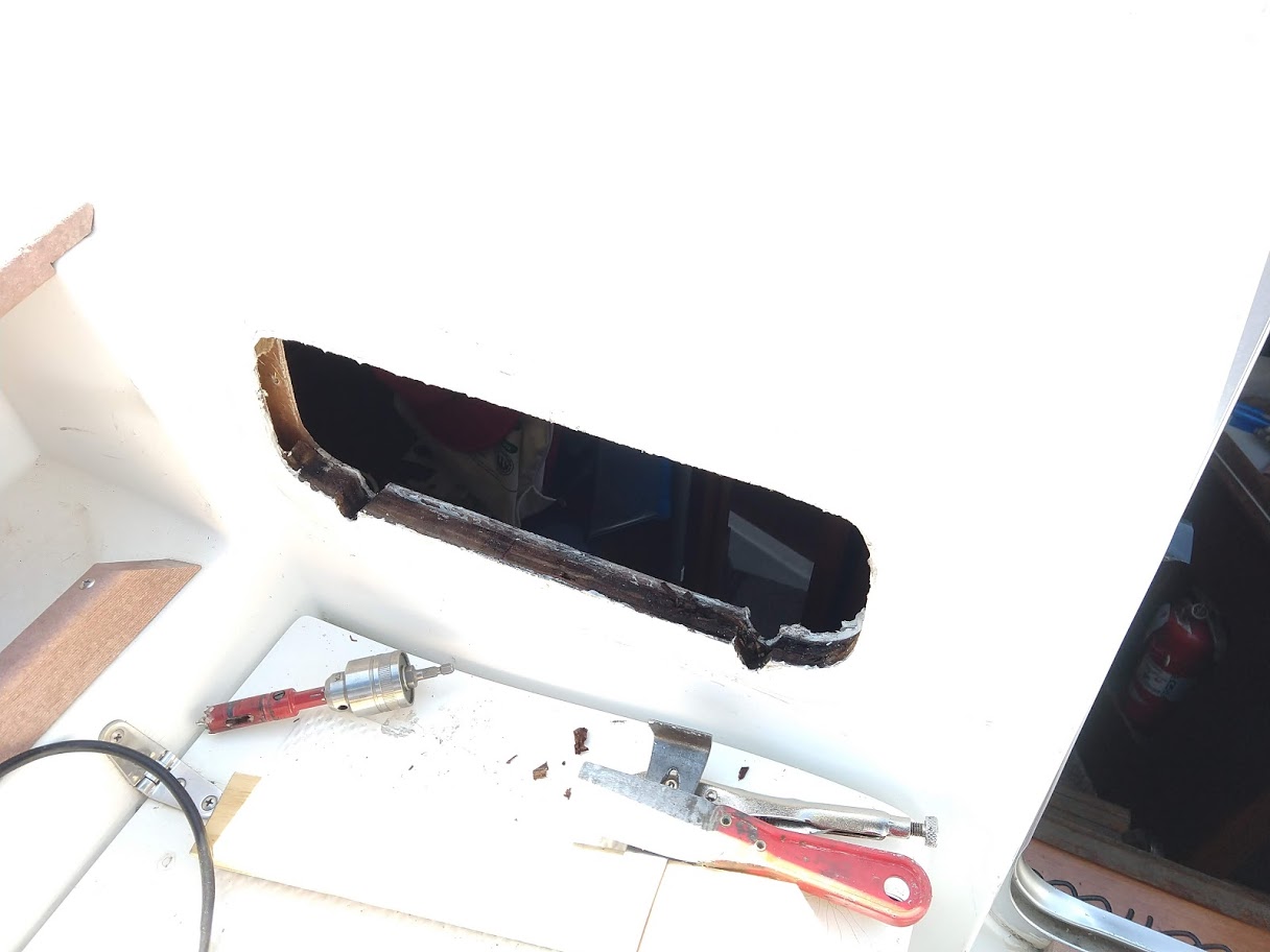

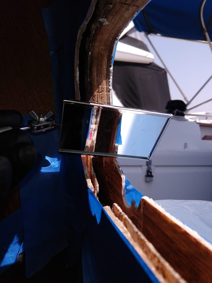

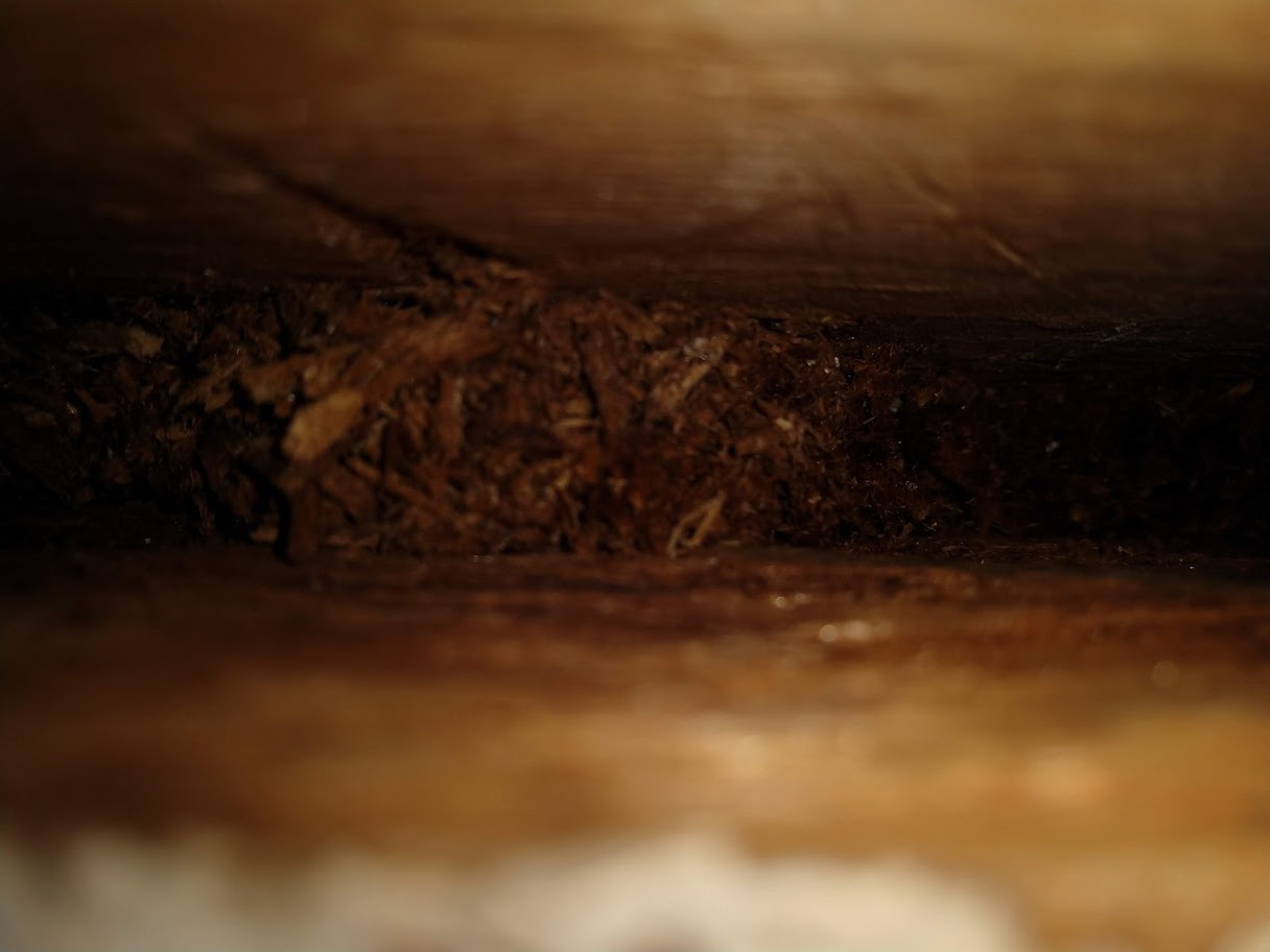

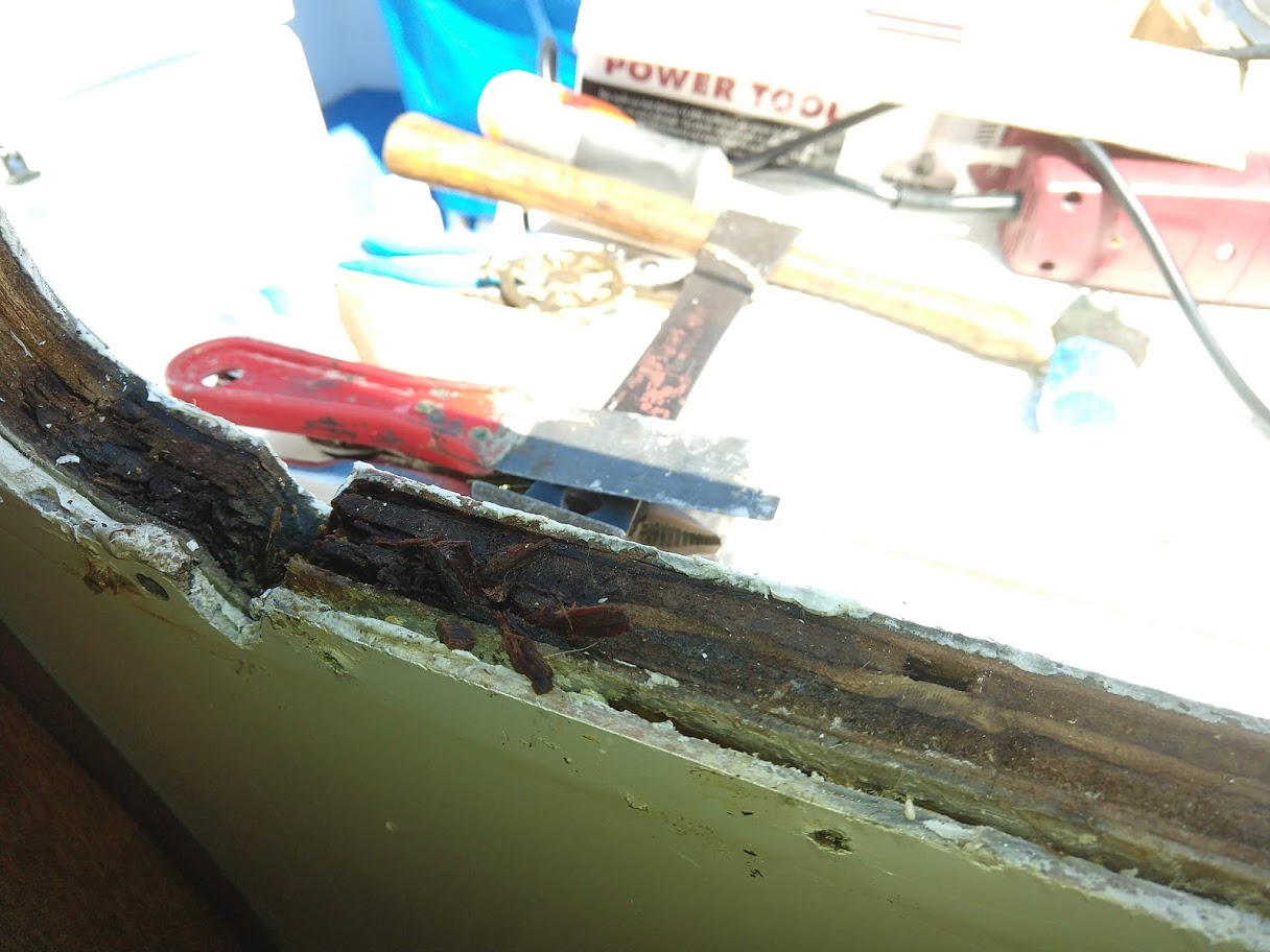

Unfortunately the proper approach is to tape it off on the outside and get that core dry. Really dry. Otherwise you can get rot. That could be from a fungus that can march through the wet wood. This just happened to me this season and I ended up hogging all of the wet (and decomposed wood) out. The core was made of individual pieces. It turned out the rotten stuff was isolated to a single piece. I dug it out about 4 inches down inside until I found the next piece that was solid but wet. Same for the adjacent piece which was wet but solid. I let it dry for a month during the summer. The last 2 hours I used a hair dryer to blow hot air in the the gap between the fiberglass skins. I injected a couple of syringe loads of Git Rot down inside where the original, but now dry wood was just to be sure it was sound. That has the viscosity of water so it wicked up as near as I could tell. Then I re-framed the opening first with new wood and used cedar shims to make sure there was no gap between the skins. All of that exposed wood was saturated with West epoxy. Since the plywood Hunter used had voids, I then mixed thickened epoxy and troweled it into the gaps, and filleted the corners. This formed a solid bridge between the outside skin and the inside skin. Now if it leaks it will not go between the layers, but rather "leak to daylight". I'll see it come inside and can address re-caulking the port light if necessary. Luckily, none of the other 7 port lights I changed had damaged wood. They all had the separation of the inner skin from the core so the potential was there to allow leaks to go unseen and cause real structural problems like the one I found. As I was replacing all the other port lights I was coating the bare wood with epoxy and filling the gap with additional wood.
