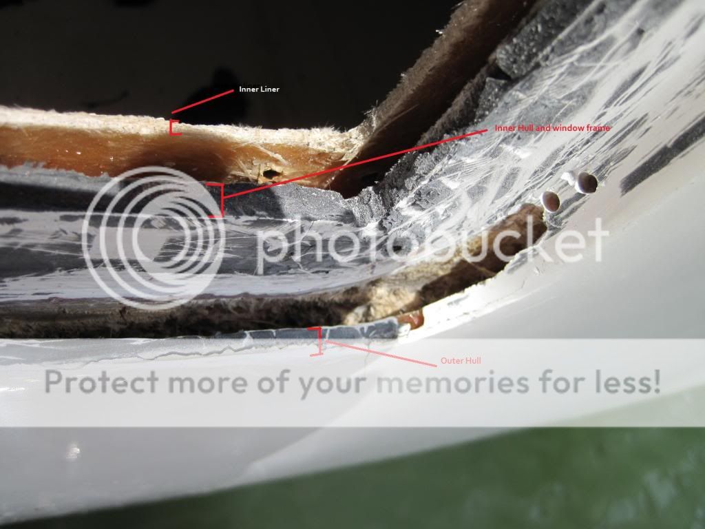

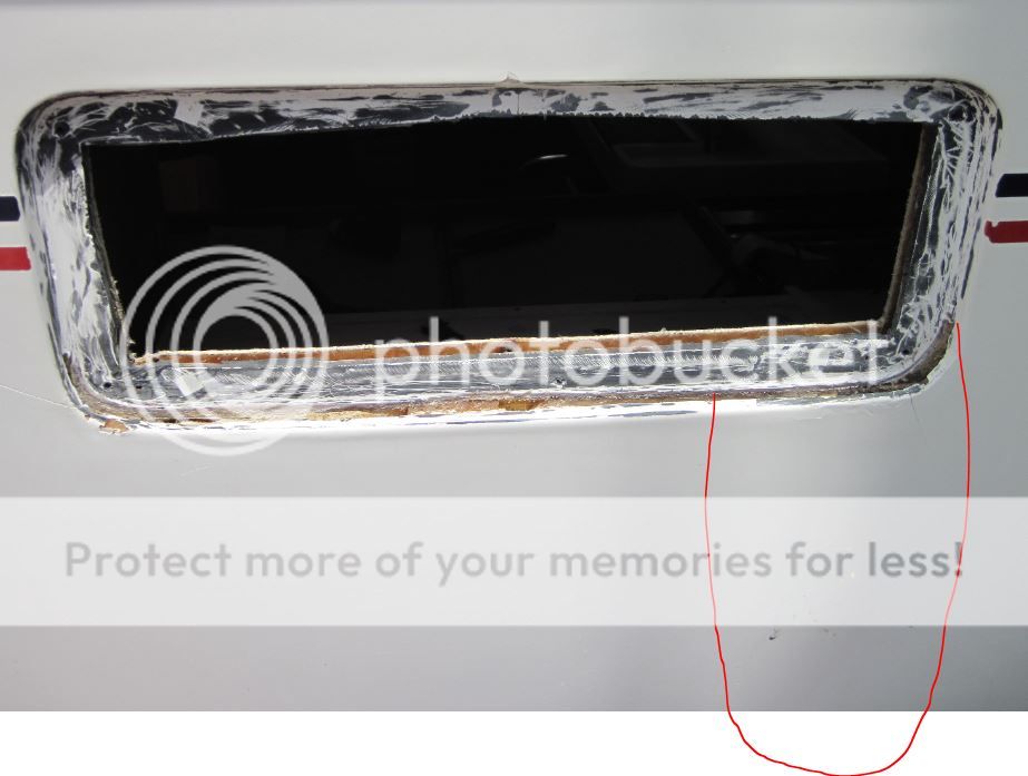

I removed the two forward port lights. A thin flexible paring knife is nice to cut the bead of the frame on the inside. It is about an inch wide. From the outside a carpet blade is good. First window took an hour the second 10 minutes. Go figure. I used a dremel and reamed out the space between the inner hull and outer hull. As mentioned earlier, Hunter AFTER 1994 had solid glass around the port light frame. In my boat there is 1/8 to 1/4 inch. I still suspect that a bump on the side would crack that 1/4 inch and allow water to intrude. The area saturated is marked in red below.

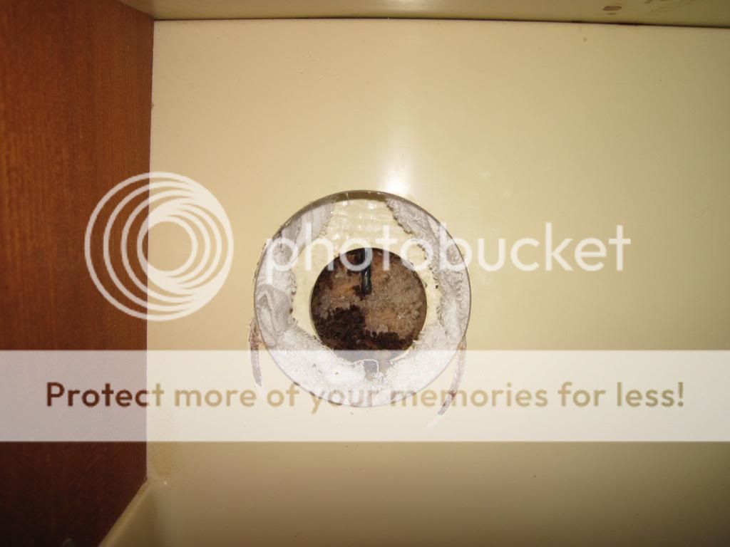

I cut through the liner with a hole saw, then cut through the inner hull with a smaller hole saw about 13 inches below the port light. The core was damp and black.

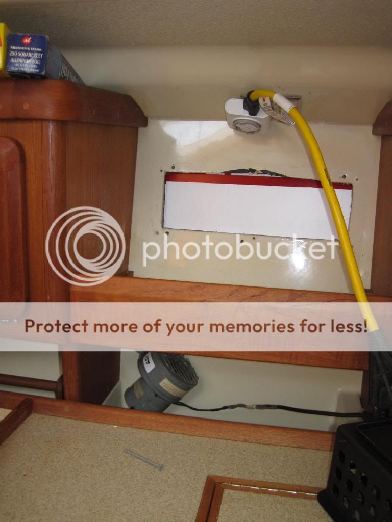

I then opened up a passage from the port light frame to the hole below. With the exterior covered with a plastic panel duct taped to the hull and a dehumidifier running 24x 7 and a blower pushing air through the passage the core dried out nicely.
