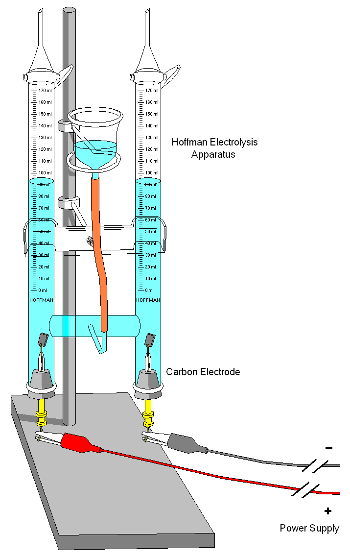

OK who remembers the HS Science teacher with a beaker of Hydrogen adding oxygen to the beaker till there was an explosion that caused the class to jump?
5,753
The old electrolysis experiment. Collect the gas in a beaker, stick a smoldering wood splint into the Oxygen side and like magic it ignited. Stick it in the hydrogen side and POP! I still like the hydrogen balloons from the youtube videos. If my college chem professors had let us blow things up, I might have become a chemist.
Image from Wikipedia (https://en.wikipedia.org/wiki/Electrolysis)
