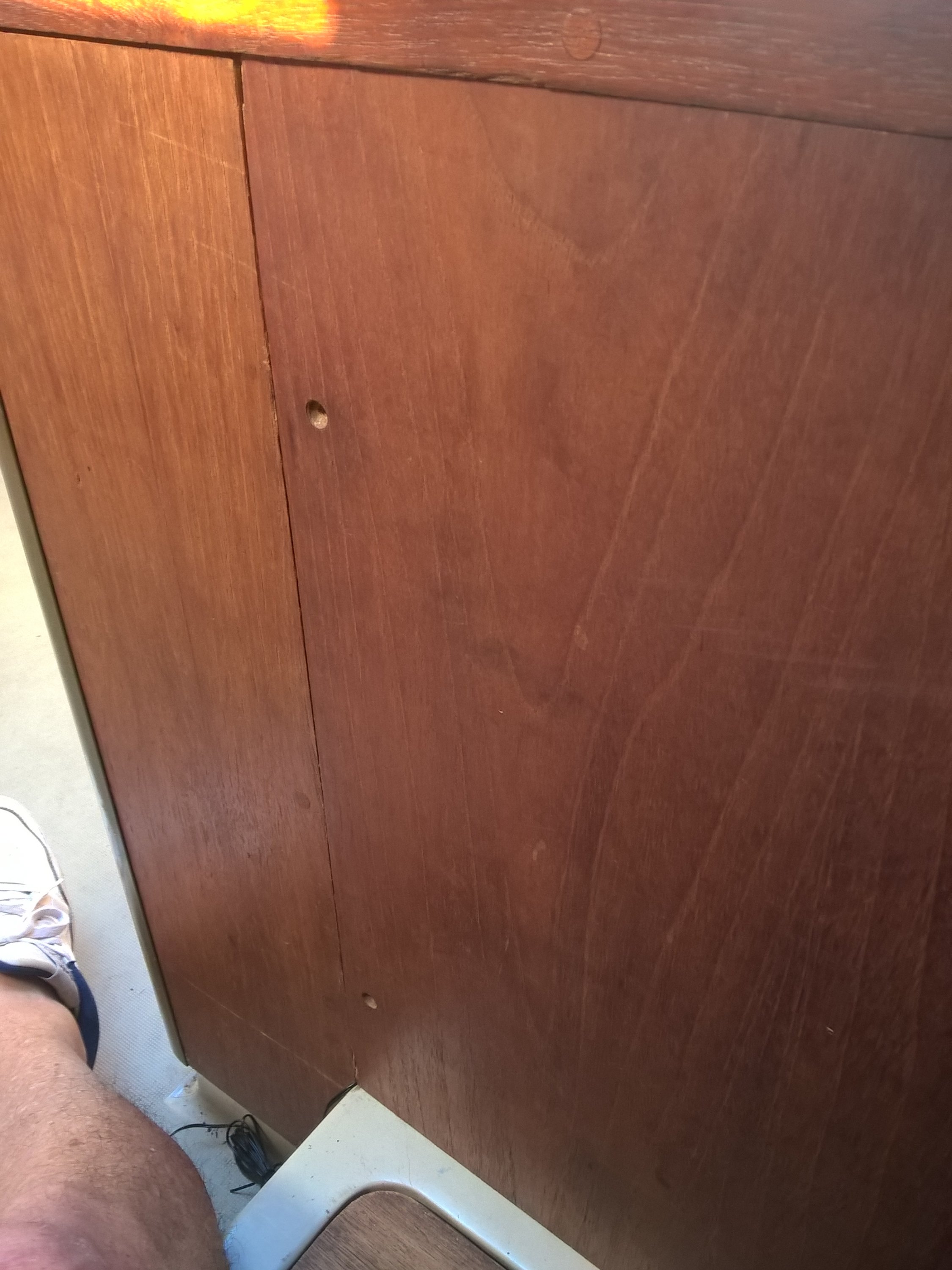

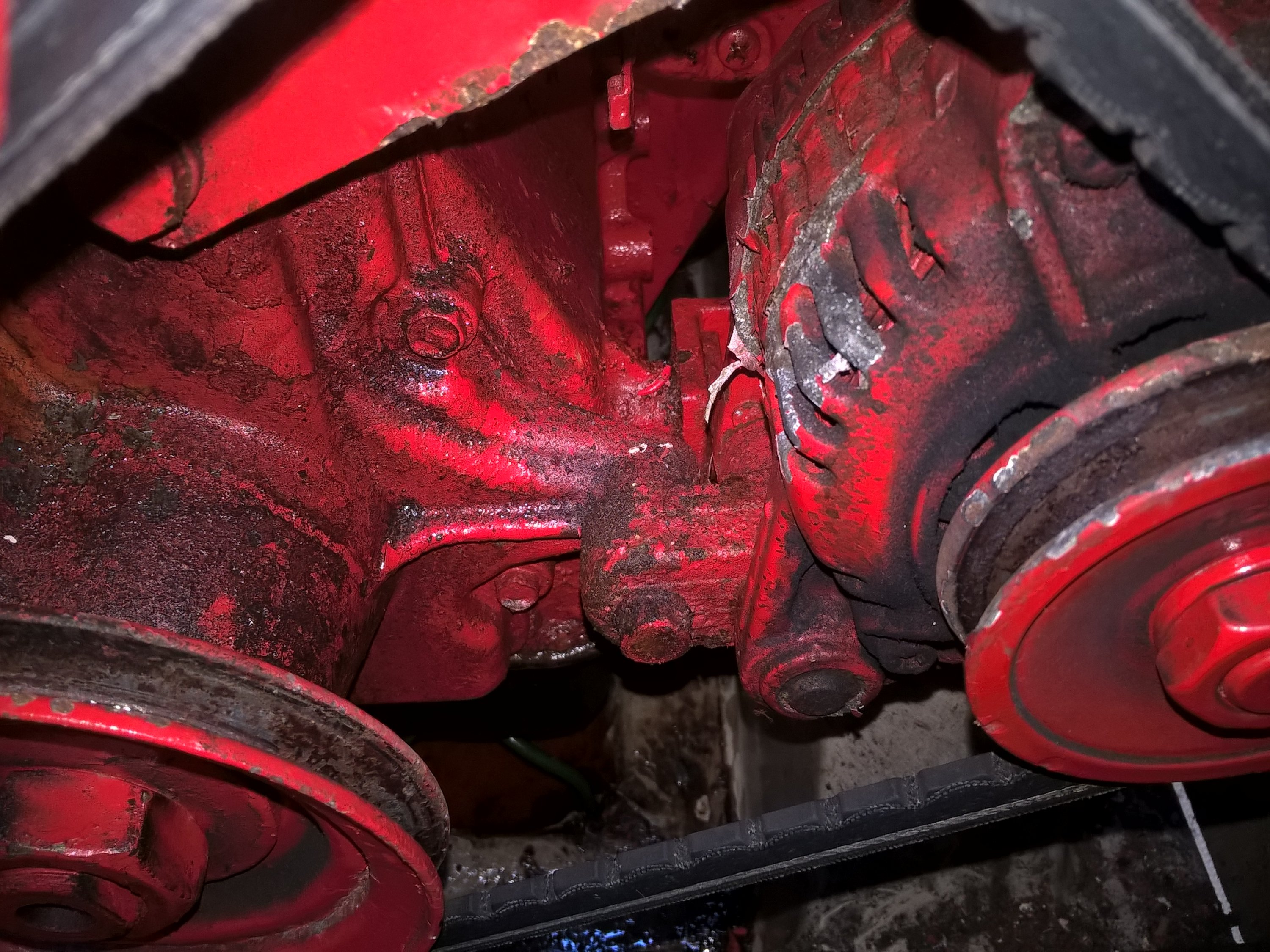

Like Mickstr said, remove engine cover's 4 screws and set aside cover. This will give you access to port side of engine where alternator is located(pic 1 & 2). Also remove ladder in front of engine. Find nut on bracket (bolts from rear of engine into bracket). See 2nd post for more pics.

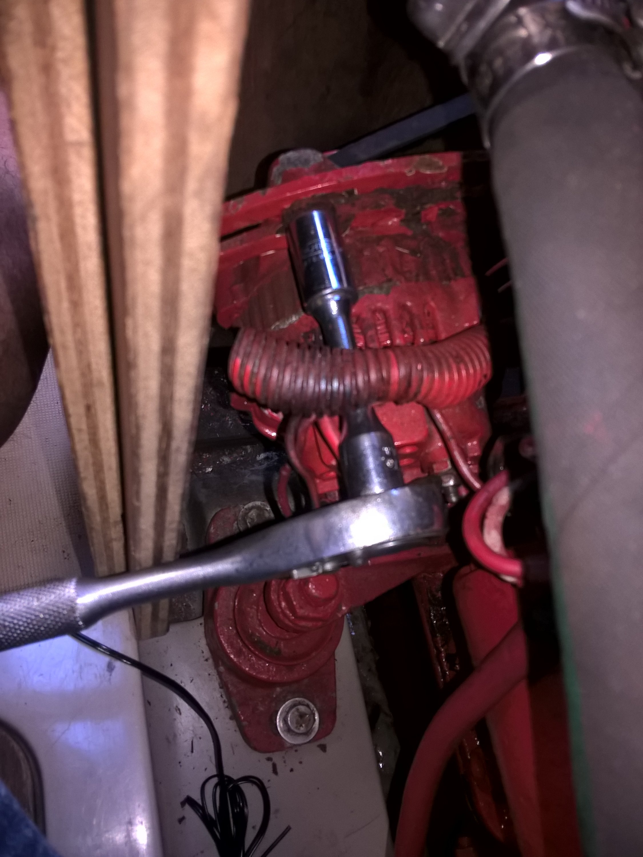

Oops, disregard pic 3. It is of front of alternator/bracket and shows no useful info.

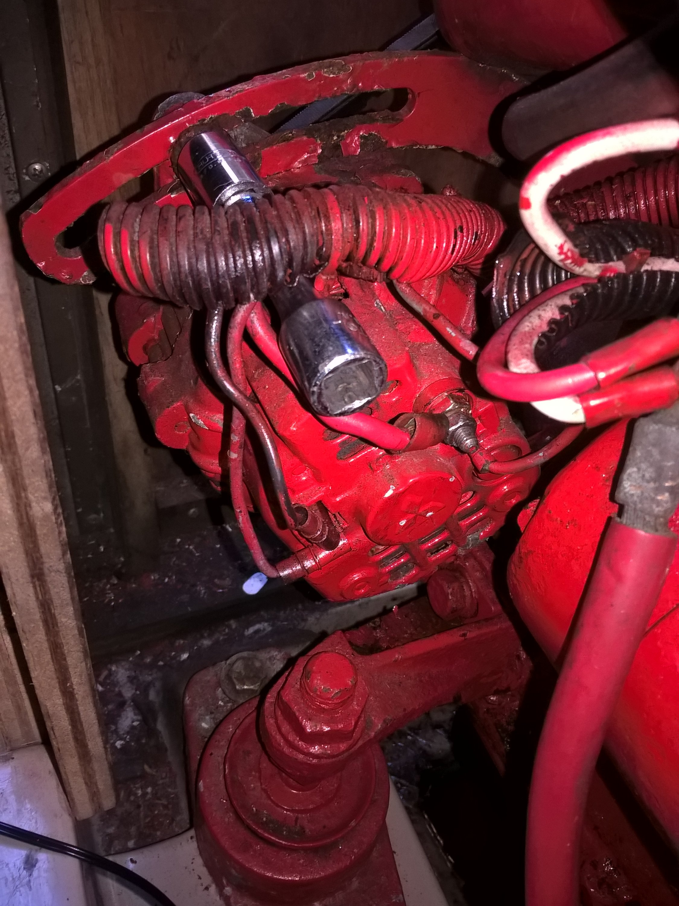

Pic 4 shows 1/2" socket with 2" extension required to fit over bolt and give clearance to get past corner brace. Since the bracket is curved, you probably won't need to loosen anything else for adjustment. Good luck and if any other questions, let me know.View attachment 128962
