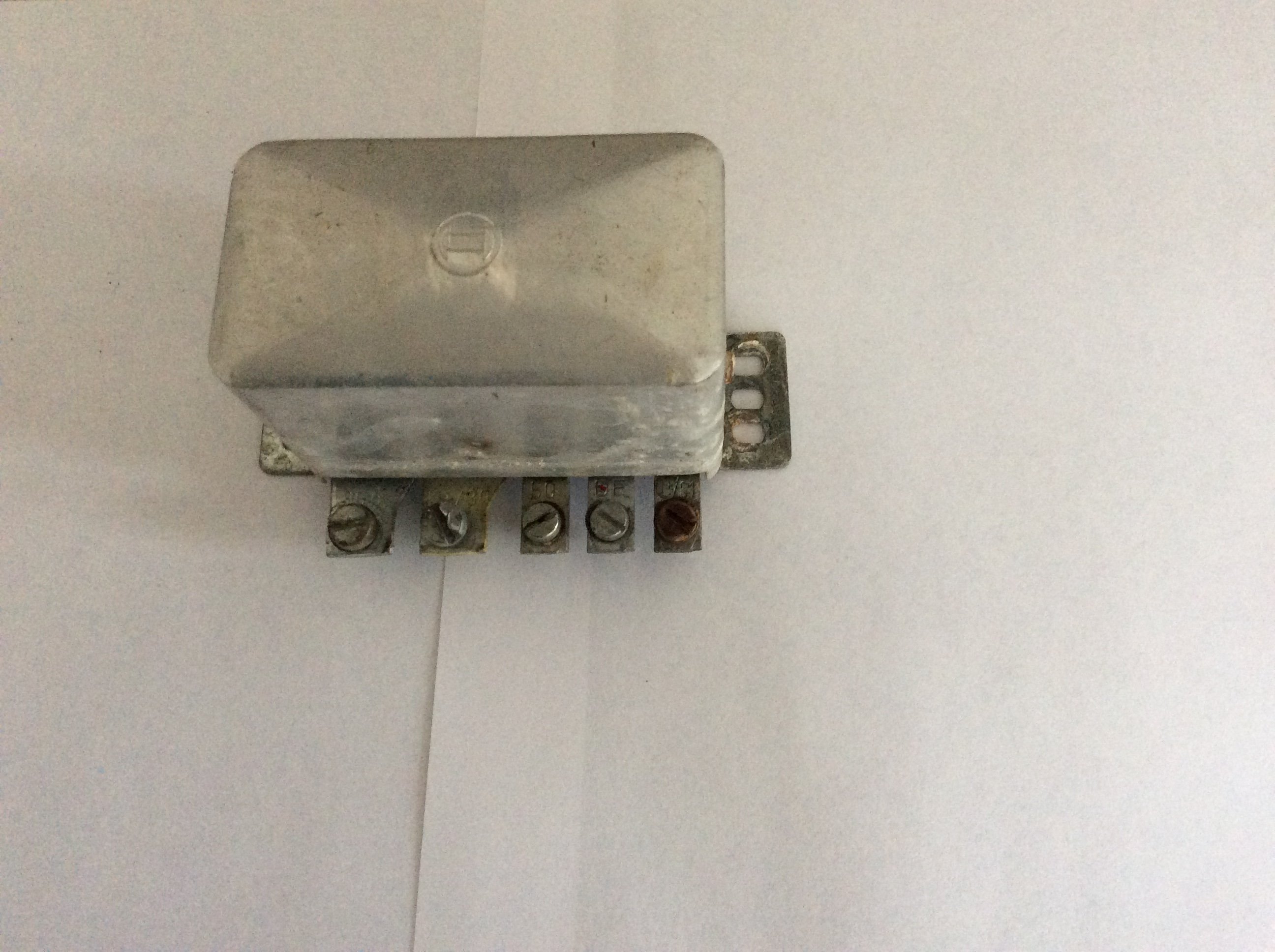

Hi,
My 1975 Bristol 32 has a Bukh DV20 marine diesel. At the end of this season I had a hard time getting it to turn over and start. The batteries are new and fully charged, and the alternator was checked by a mechanic and seems fine. My boatyard guy looked at it and suggested that something might be wrong with the regulator, which stands between the battery and the alternator (picture below). Is this likely and should I replace the regulator with something more robust? If so, what would be compatible with my DV20?

Looks to be a plain old external automotive regulator.. If ya take it to a good auto parts place, they can supply an electronic "generic" that might be adjustable for volts.. Your alternator is probably in the 30-40 ampere range so almost anything automotive will work..

If the batteries are fully charged and it still won't turn over it's not your regulator. I'd start checking voltage at your starter first.

The engines does turn over, but very slowly - it's like it wants to start but can't build up the rpms. I had the started checked out by a professional and he said the starter was fine. Should I "upgrade" the regulator and, if so, to what? I know next to nothing about electronics.
Thanks!
