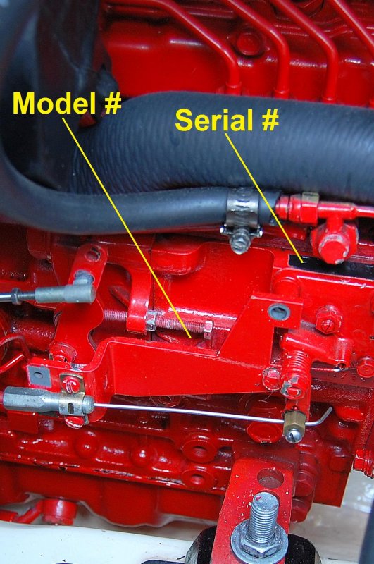

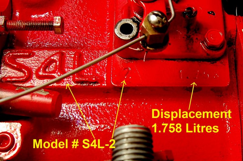

If this is a 42B Four then the block model should be here.. What ever you do DO NOT tell the folks whom you are buying parts from that you have a Westerbeke. Westerbeke has a gag order contract with Mitsubishi that says only parts for Westerbekes can be purchased through Westerbeke.
FWIW I happen to have a; "Red engine in a home made wood splitter and all it says is S4L-2.."

Thanks, now I know where to look. Can you help me out with the injector number and if there is a crush gasket below it. I think you once said it was a NKG available out of Nappa, if so a part number would be appreciated.

I have a 44B Four so parts are different but the locations should be similar for engine block
