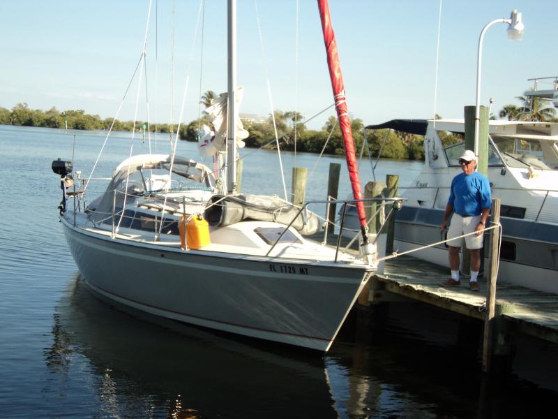

Phil - hope that OB on the stern is for the tender...!

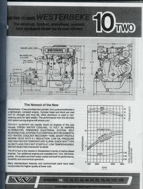

This evening I talked with a friend who is familiar with diesel engines, and he said that I should not be afraid to run the engine faster than 2600 RPM. He mentioned checking the torque curve of that engine. I have seen some of that information on line, but do not clearly remember it. I thought that is how I arrived at the 2600 figure.
Yes, the blue OB is for the dink that is folded on the foredeck. We don't keep the dink there, but I do keep the motor chained to the stern rail.
Regarding engine horsepower: Maybe I could get a few more "horses" from the cowboy standing on the dock! :eek: I cringe when I see myself in pictures.......the old knees sure aren't what they used to be.

Thanks for the power curve info. I did see that earlier and used it to justify the 2200 cruising RPMs thinking of fuel economy and torque. When I looked at it again I decided that 2800 RPMs seemed OK due to more Hp and not much change in fuel consumption. As I motor at 2800 I will watch the temp gauge and the exhaust. I think the most important "curve" will turn out to be the "learning curve".
