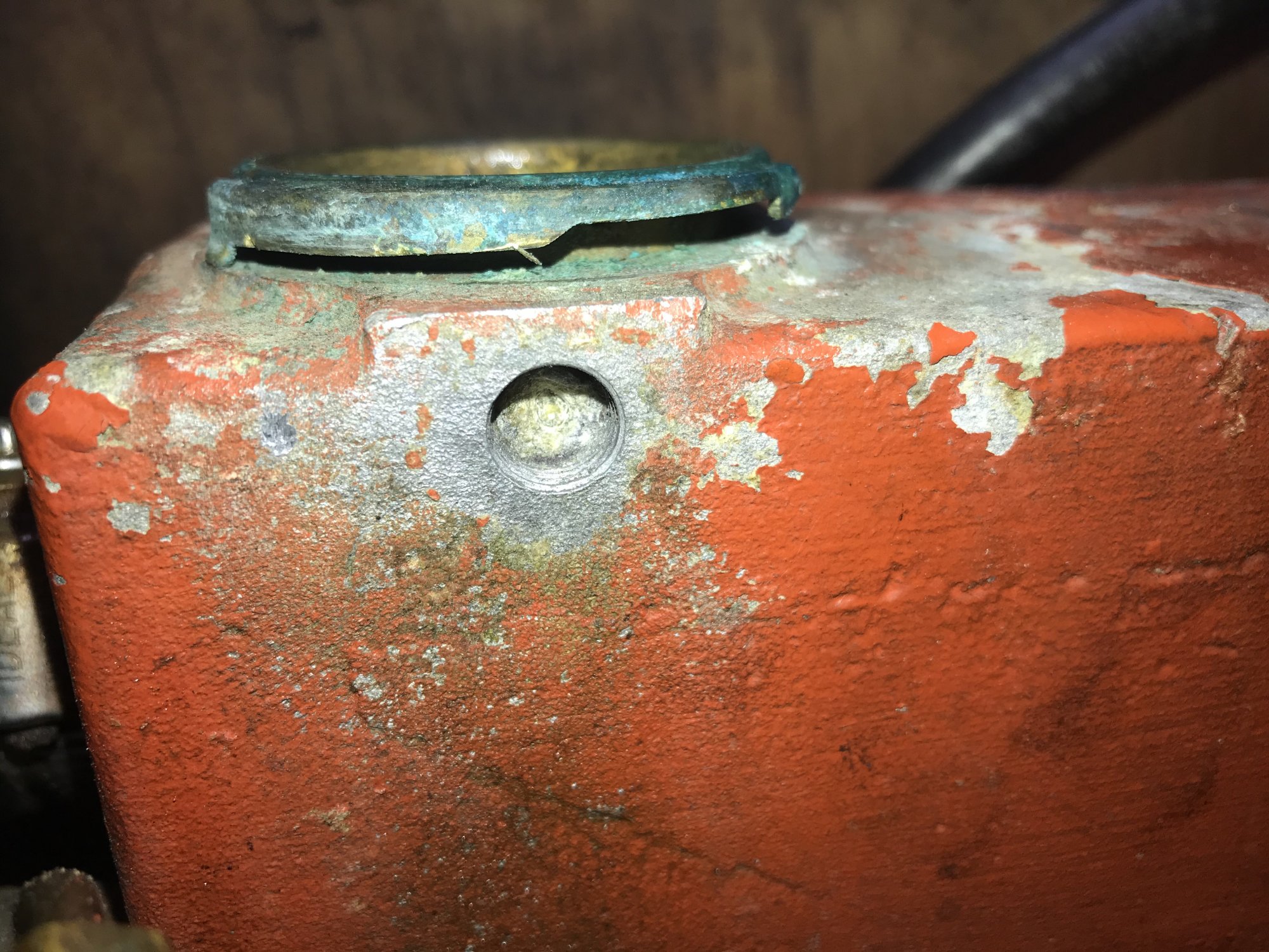

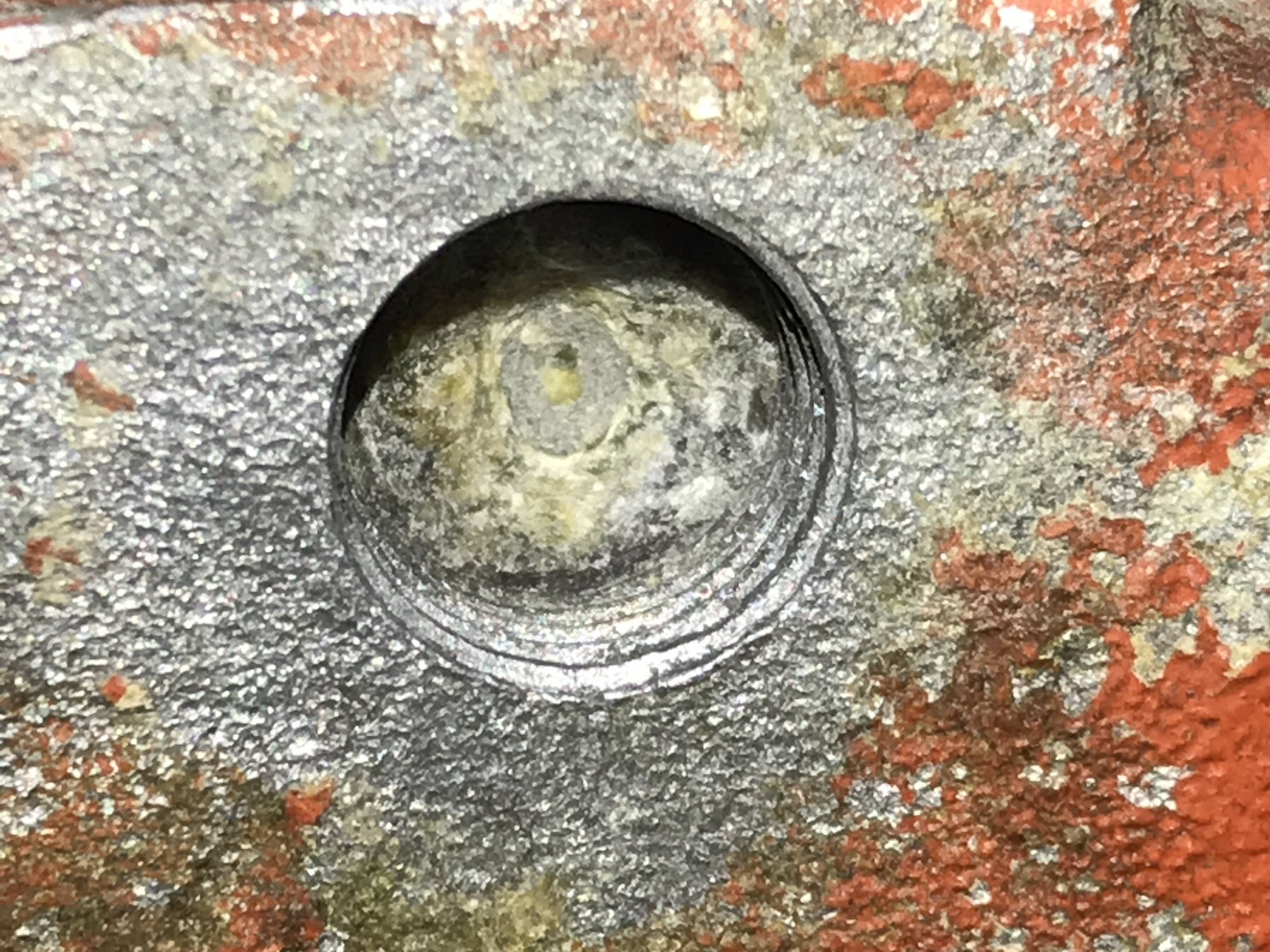

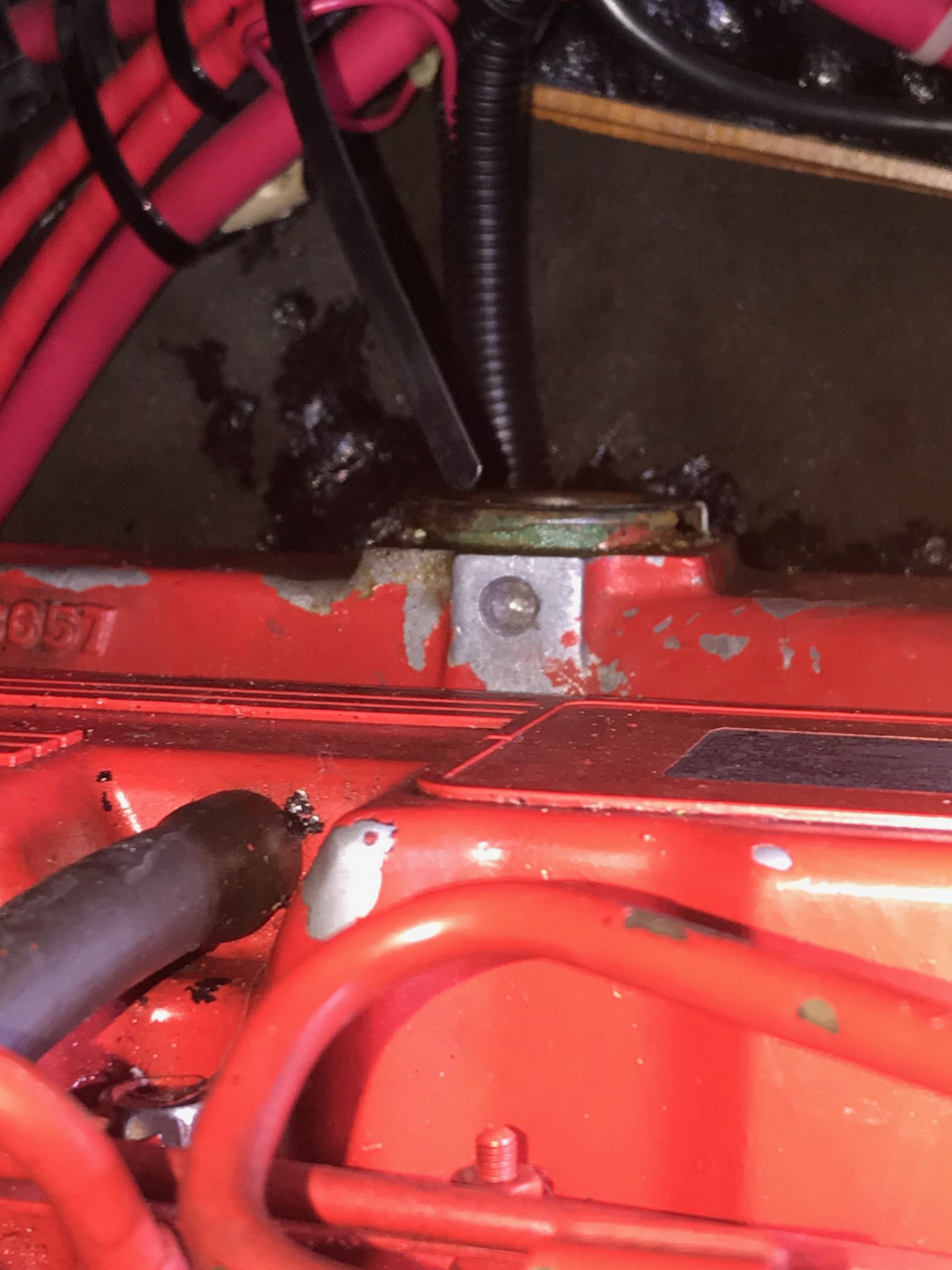

Hey all!
I found out why the coolant overflow wasn't draining into the exhaust manifold--clogged with antifreeze crystals.
I've checked the manual but I cant tell if this hole goes straight through, I don't want to drill through the manifold by accident.
Also--does a regular flush get rid of these heavier deposits, if not, what's the plan?
Thanks!

My Westerbeke 12C two has a elbow that threads into that opening. I guess you removed yours and that how you found the clog. It should run through. If you pop the thermostat you can probably feel or maybe see the other end of the hole.

Yep! that was clogged too. Thanks!

Haven't flushed it yet, topped up with antifreeze though. Definitely a little crusty with crystals, you think they will flush out?
23,352
Nope. Boil out maybe.

That’s a serious build up. I just removed and reinstalled the elbow in mine. It had a very slight leak. My motor has 520 hours purchased it with 300 hours. Records don’t show that it was ever flushed. I had absolutely no buildup. I guess your heat exchanger is ok, do you run hot?

Good clear photos Idle.
My guess is that engine has never been flushed properly and on top of that different grades/ brands of anti-fleeze liquid had been added and mixed over the years. Good thing that you caught this now. You can probably expect that kind of build up all through the secondary cooling system.

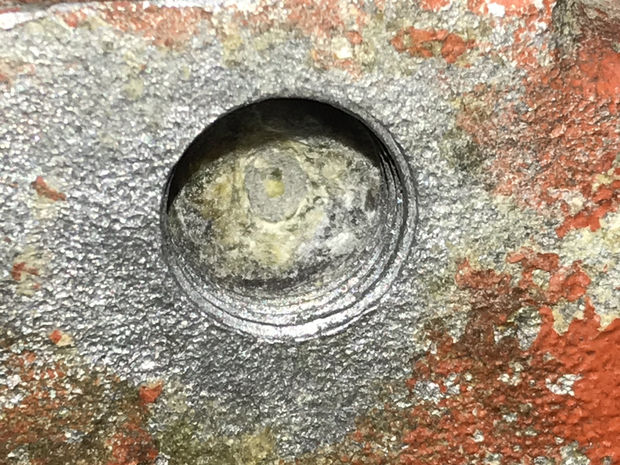

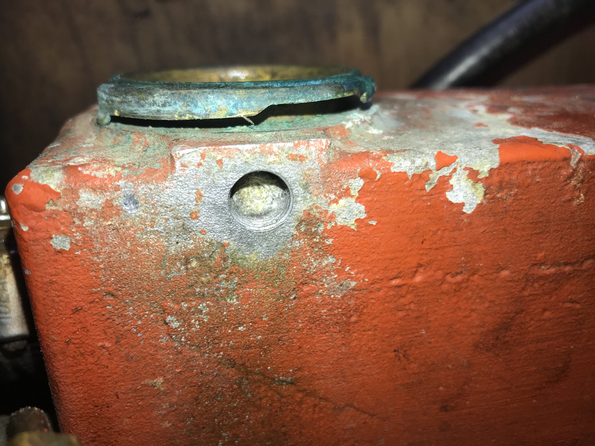

Hey all!
Thanks!
View attachment 174473View attachment 174474
Hi, I read with interest your old post. I have a Westerbeke 44A and found the exact same problem in the Exhaust Manifold and elbow, preventing coolant from reaching expansion tank. After unscrewing the elbow I have cleaned any build up I could see in the hole but still no air or coolant flows through (I reattached hose and tried to blow). I am afraid to drill through the aluminum of the manifold. There must be another little hole inside the rim of the pressure cap connecting the two but cannot see it. Did you ever find out the exact location of the "second" hole leading to the manifold? It would help to know where to look/clean. Thanks a million
