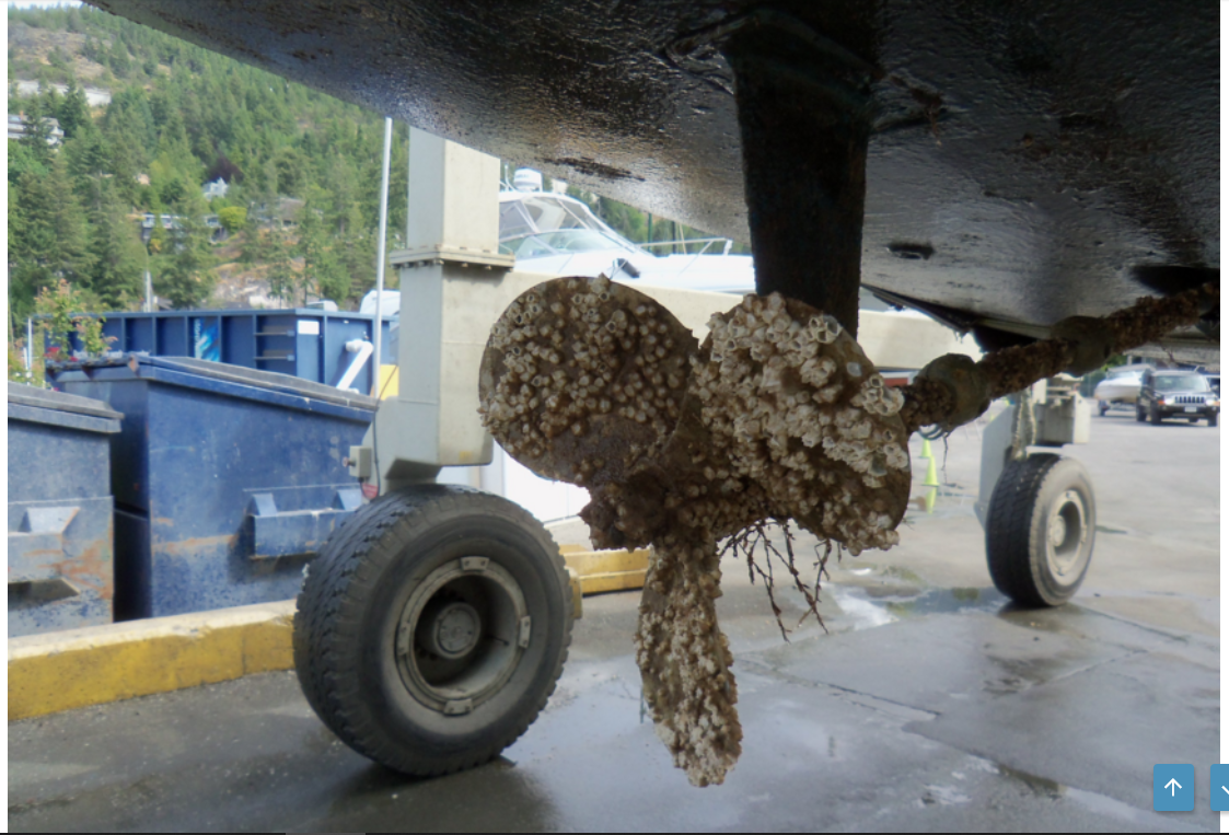

This is what I meant by low fouling water, sometimes. This is quite a while back but the barnacles were out in full force that year. HOWEVER, notice how the bottom only has a light coating of slime with CPP. This was the first time the boat had been moved since last boating season.

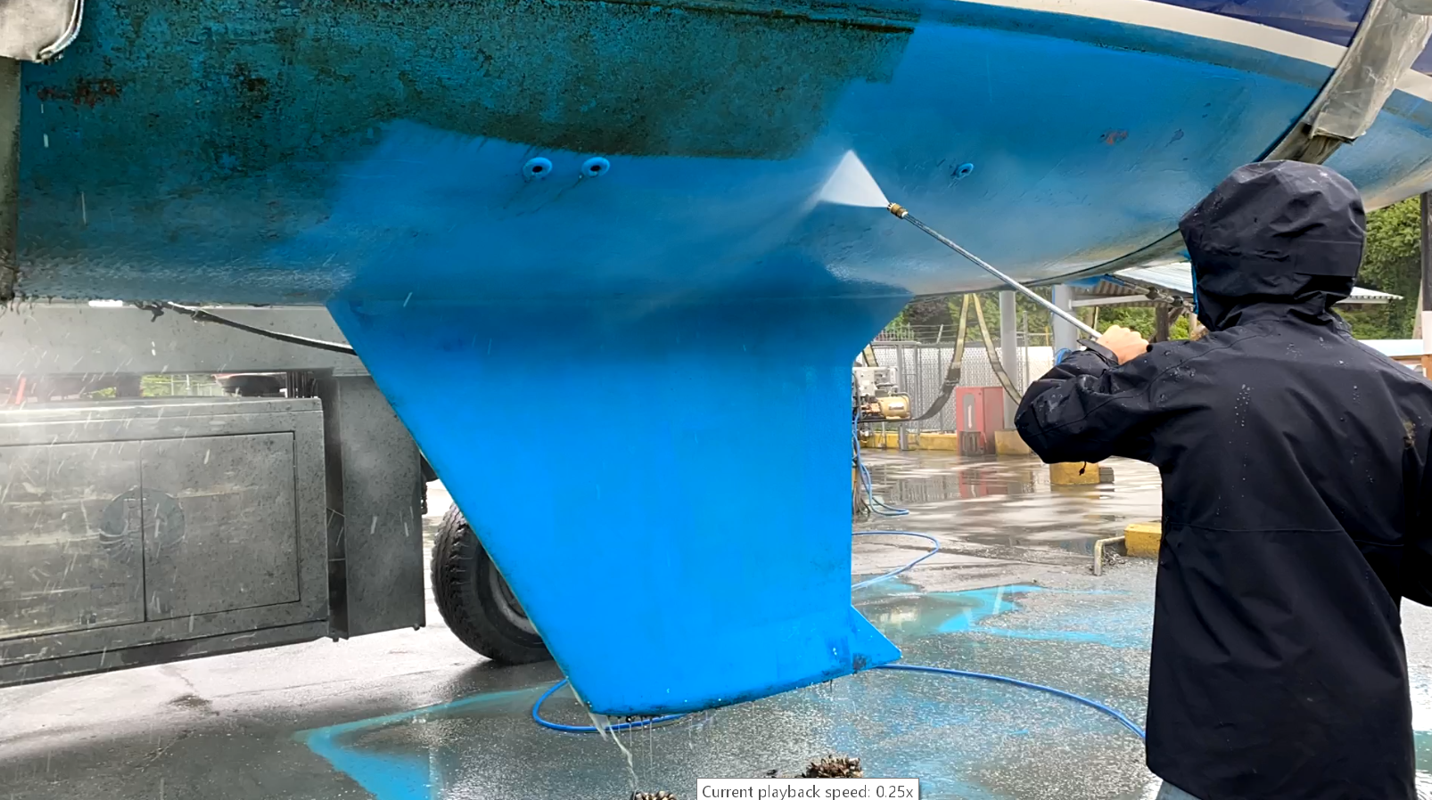

Clean as a whistle after a pressure wash and NO TRACER coat showing. Also, not much blue colour in the wash water. With Micron CSC, the wash water was always a translucent bright blue indicating that a major portion of the ablative paint was being lost with each pressure wash.

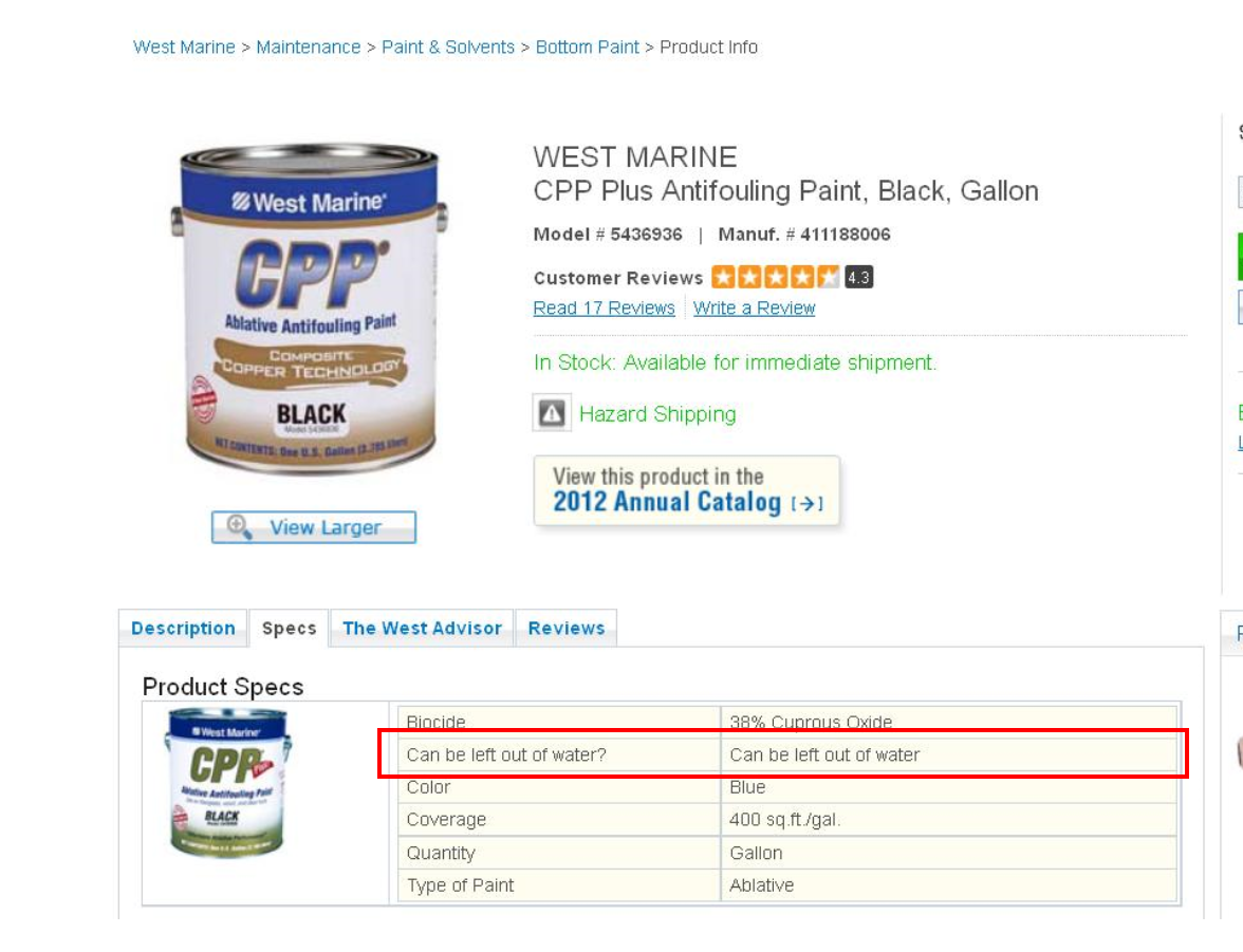

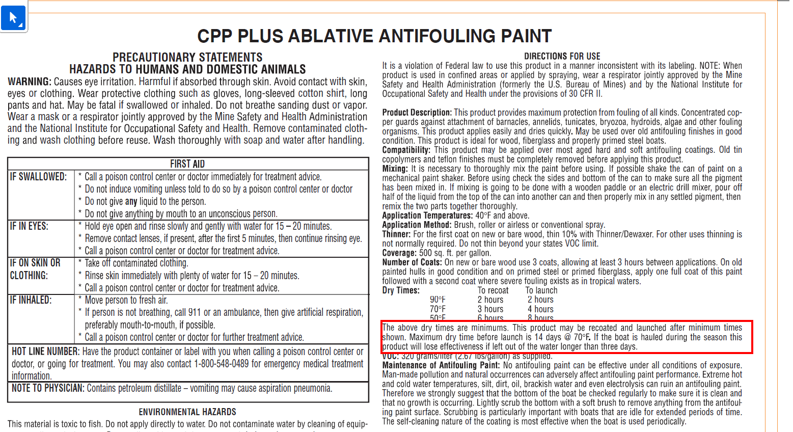

Are WM CPP one of the paints that will retain it’s anti fouling properties if the boat is store on a trailer for winter
This first shot is from the CPP can label :
This second shot is from CPP's specs :
Who you gonna believe ? It's all a conspiracy, I say :soapbox: . Who and how, I'm not yet sure but it's a conspiracy.
