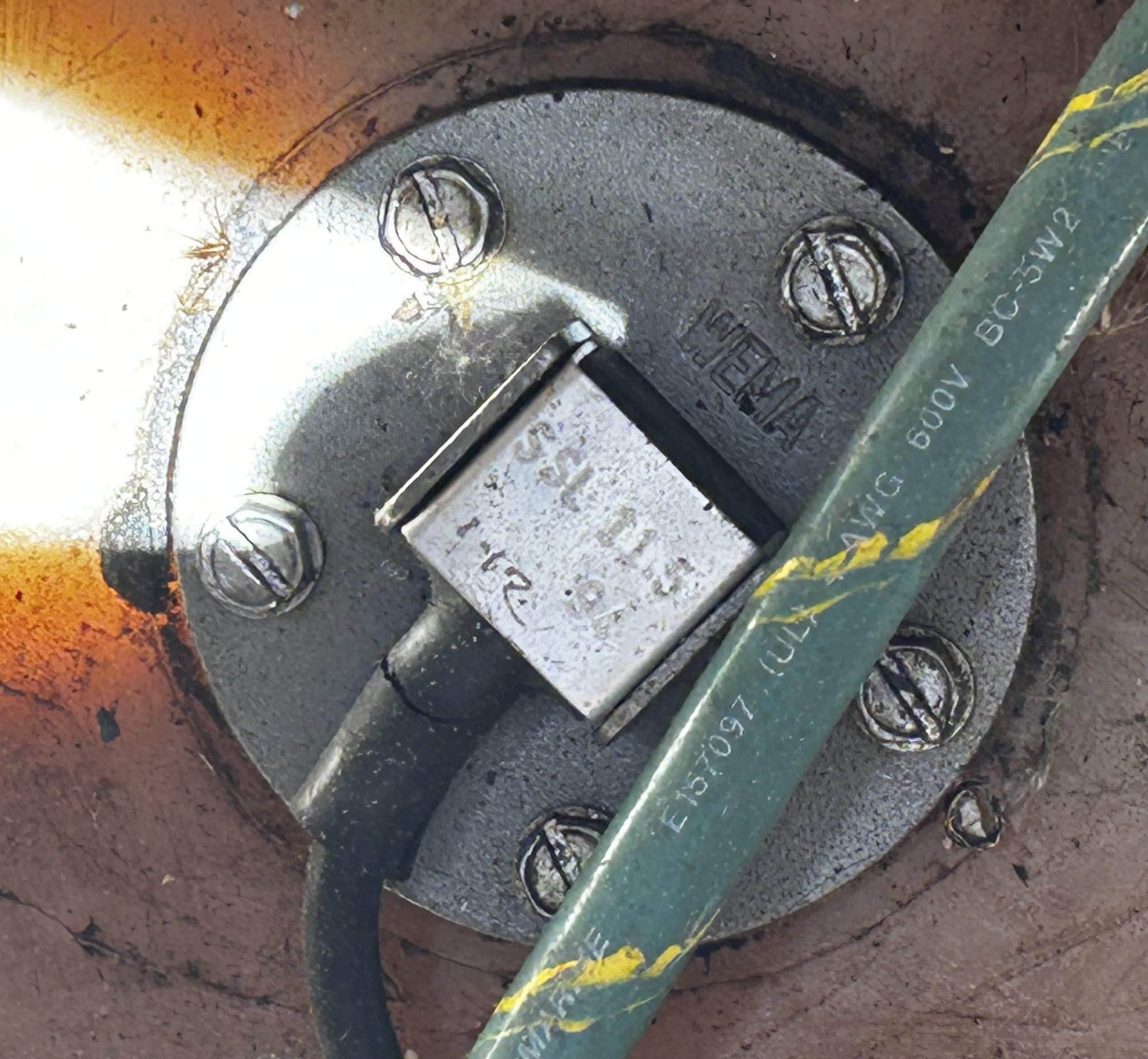

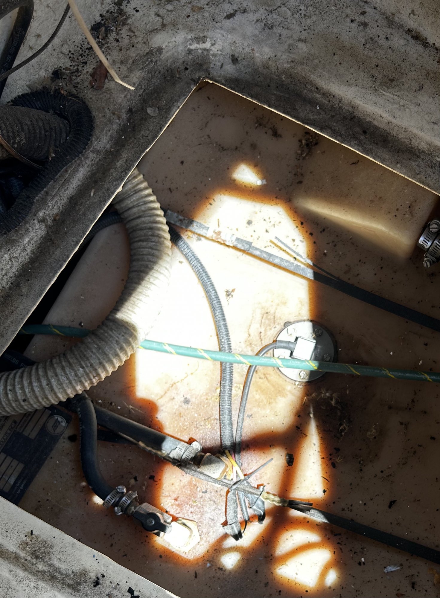

I have to replace my diesel tank WEMA internal sensor. It‘s reading less than 1/2 a tank of fuel, when I can see I have just over 3/4 of a tank. It‘s not the most dire of issues, knowing the variation in readings I can guess at the fuel level, but would rather not have to.
I removed the sensor from the tank to clean it, but it’s not dirty or fouled. My guess is, it is saturated as it is free flowing out of the tank and gives me accurate readings when I move it by hand.
I also think it might be too short a sensing tube and I have just never noticed the variation before. And the only reason I did notice this issue was because I was in the compartment, saw the level in the tank and then when I looked at the gauge reading less than 1/2, I started to question what was happening.
Are Moeller Sensors more reliable and compatible with WEMA wiring and gauges?
Are there any other sensors being use currently that are better?

I‘ll definitely check my clearances…….I see from reading the top of my sensor, it is an SSL type and is 11.5 inches long.
While I was hanging head first and waist deep into the access, I just didn’t think to get a ruler and measure the tank’s depth. Stupid, now I have to back and do it again.
11.5” long just seems to short for the tank. But I really feel its the saturation of fuel also.

Yes, a short a sensor would cause the sensor to read lower than the tank level is, some do this so there is a reserve and others so they don't draw from the last few inches of the tank since it might contain debris.
I have had good success with the wema and now the Kuss sensors.

Good Point….I just changed both fuel filters last week, which both came out clean and no signs of clogging debris. And when I removed the sensor I looked in and the fuel was clear to the bottom, no signs of any gunk. So I’m good in that respect. Didn’t measure the tank though but thats another issue.
When I replace the sensor (I’ll be sure to measure) I think I’ll keep it at the 11 1/2 to 12 inch length to avoid any bottom debris. And just do the math.
I do have to replace the sensor because since writing this post I’ve been to the boat and noticed wide fluctuations in readings. I feel it really is saturated, as the level hasn’t gone down any.
