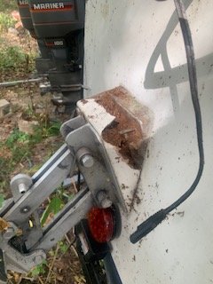

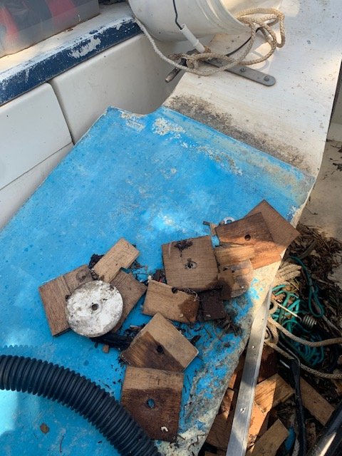

There had been a growing crack in the mounting block where the outboard bracket attached to for several years . Last fall , I opened the crack in the fiberglass to discover 40 year old mulch
After a few attempts, I made a replacement and went to mount it on the transom .
when I crawled under the cockpit to mount an expoxy soaked sheet of plywood and a 1/4” sheet of stainless as a backing plate , I found this was the only thing keeping
My outboard from falling into Lake Michigan
