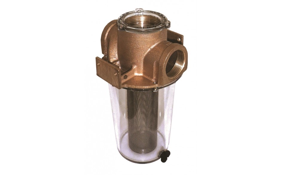

Regarding strainers.
some plastic strainers are top fixtures with in/out fittings that screw a bowl containing a screen into the top. I had one when I first acquired my boat. Looked good. Was a devil to open and close. The O ring would bind the strainer would leak or the plastic bowl would craze over winter. I ended that poor design mess by upgrading to a Groco bronze strainer.
They come in various sizes.
The top clear plastic unscrews and the basket screen can be removed to clear the strainer of any jetsam that gets sucked into the strainer.

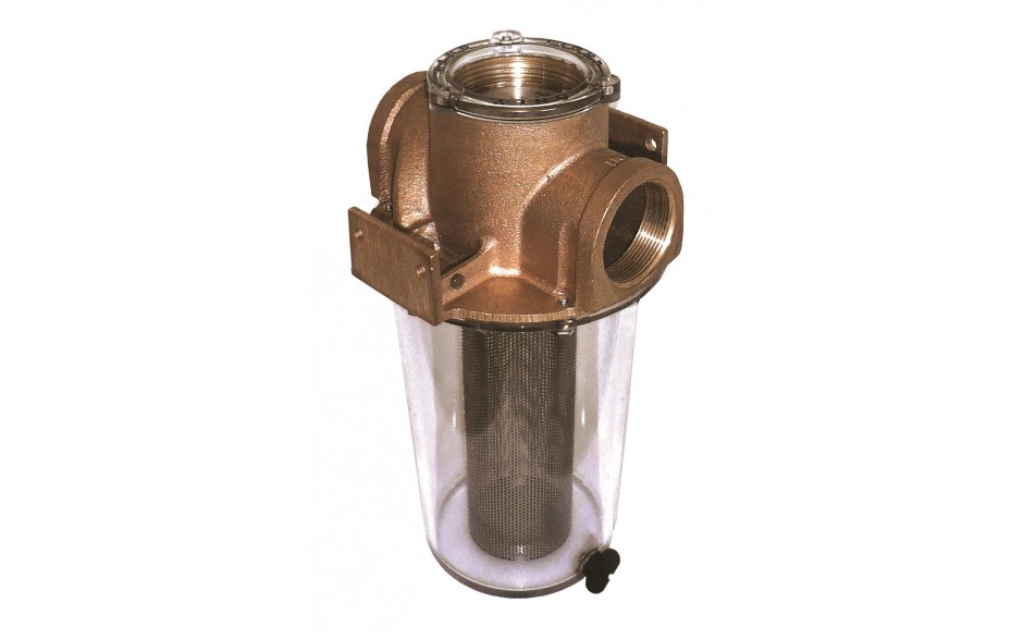

I've got an older version of this Groco - the little screw on the bottom has broken off and is now a plug, and the top is solid brass (no clear window). The problem is that the flat plate is pinned against the mounting surface so there's no way to get at those back bolts, and you can't pivot it because there's an intake hose pressed against the other side :(
24,739
As I suggested, sometimes the boat needs some new bling. The flat plate in the image on the newer strainers slides into a mounting bracket (supplied with the strainer). The top plastic screws out and is hand tight. No tool needed to open. Sealed by an O ring. It was a serious upgrade on my boat. About $200 for the 1/2” hose model.
