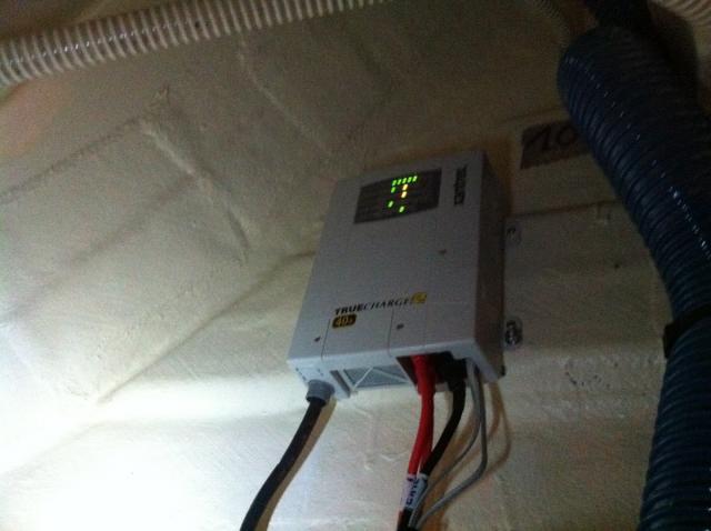

My focus is shifting back to the charger itself. It's mounted on the hull near the transom. See the pic attached. It is an enclosed area at the back of the boat and there's lots of clearance above and under the charger. While there is a lot of volume in the area, it isn't ventilated per se and I'm wondering if that is the problem. It takes 30-60 mins for the unit to overheat with the area enclosed so I'm wondering if the the warm air exiting the charger has no where to escape and eventually builds in the area and causes the unit to overheat.
The fan on the charger does come on when the unit is outputting >30% however one thing that is odd is that when the warning light comes on indicating the unit is overheating, the fan shuts off. Unfortunately Xantrex Support didn't know if this was normal. Hard to imagine it is, but that's a mystery.
If anyone has any experience with this type of problem, let me know including ideas on adding ventilation to the area; what would be the best way to do that without compromising waterproof integrity of the cockpit; adding a fan, etc. Hard to believe that in an area this large the charger would throw off that much heat; and it's not even that warm here yet.
It's possible. The rather large-ish server sitting next to, here, that serves as our home server, our Internet server (web, mail, etc.) and my workstation is often running it's fans at high speed if we've left the house and had the room's door closed. (Otherwise the cats may set off the motion sensor in the room.)
If that was my suspicion, I'd purchase an inexpensive indoor/outdoor wireless digital thermometer from Radio Shack or the like, and put the outdoor unit in that space, near the charger.
Ah, the world-renowned Xantrex customer and technical support. They make good stuff... well, mostly good stuff, but their customer and technical support often isn't the greatest, from what I've read and been told :(.
If anyone has any experience with this type of problem, let me know including ideas on adding ventilation to the area; ...
If that's the problem, you might be able to get away with just putting a small, low-power fan in there to simply circulate the air. If that area is completely closed-off, as you say, odds are the air stagnates. Just moving the air around will expose the warm air to more cooler surfaces. Also: If you can put the charger down as low as possible, w/o compromising wiring routing or creating a potential for it become immersed in water, that might help.
