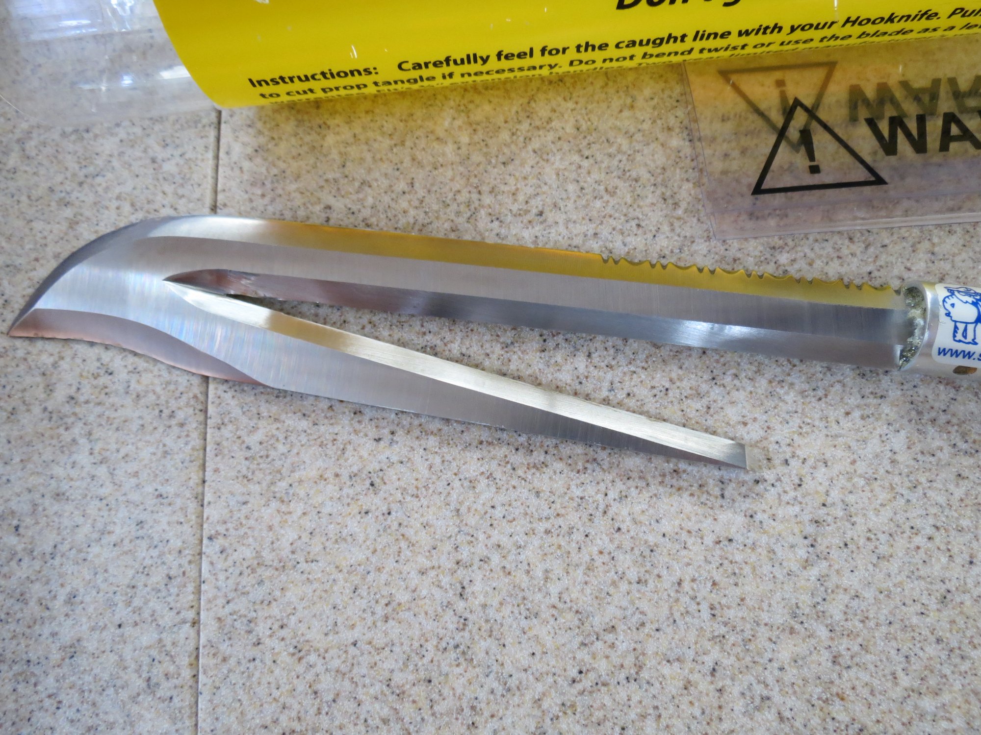

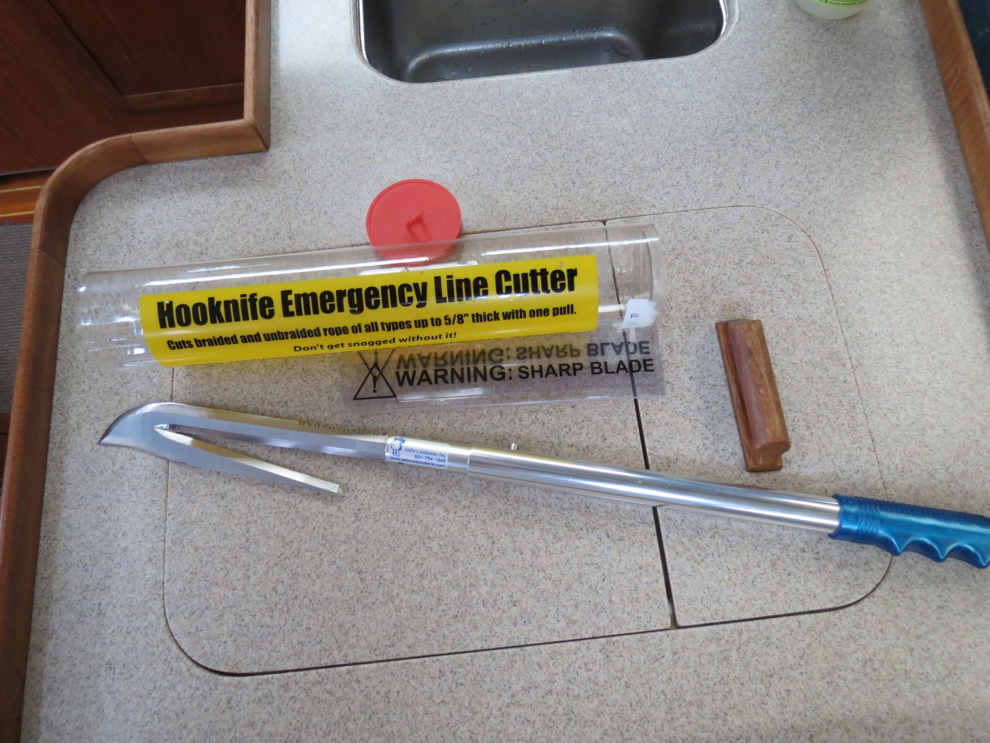

Get a Hook Knife. It is an amazing tool! It will fit on extendable handles too. It has saved me several times.
