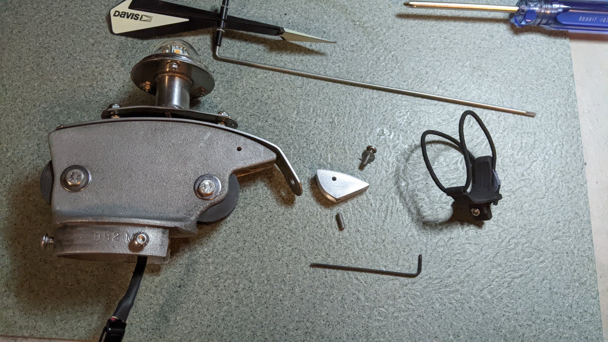

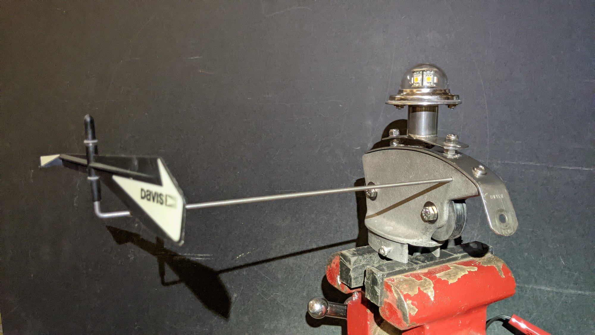

I have this little windex that was made to strap onto a mast with a plastic bracket and bungee arrangement, which you can see on the right in the first picture. To make it a little more permanent, I cut a piece of aluminum to fit in the hollow spot at the back of my masthead and threaded it for a set screw to hold the shaft in place. A machine screw replaced a rivet through the backstay tang to hold it all together. It's the little things.

Looks like it works better for you on port tack. Harder to see on starboard. Will airflow over the sails affect it? Ours sticks out forward and up to avoid this problem.

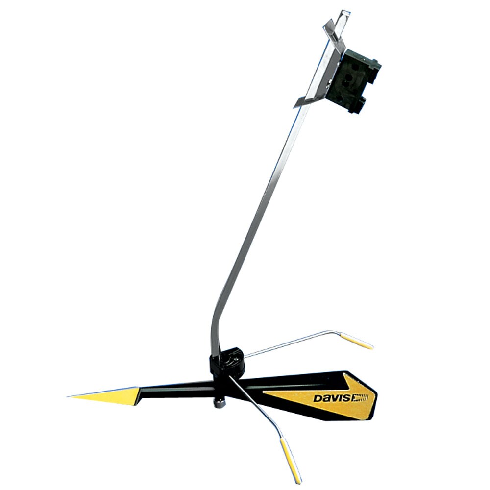

Davis Instruments Black Max.
The are designed to strap down low on the mast of una-rig dinghies and extend forward. I like them on pulpit rails, one on each side. Again, I used a modified mount.
The way the original mount fit on my mast I usually had it positioned on a diagonal to port, so I'm accustomed to looking over that way for it, and sailing within the confines of the Kanawha River with its fickle winds I find that it's seldom occluded for long. If the airflow over the sails has any effect on its accuracy, I'm not a good enough sailor to notice.
