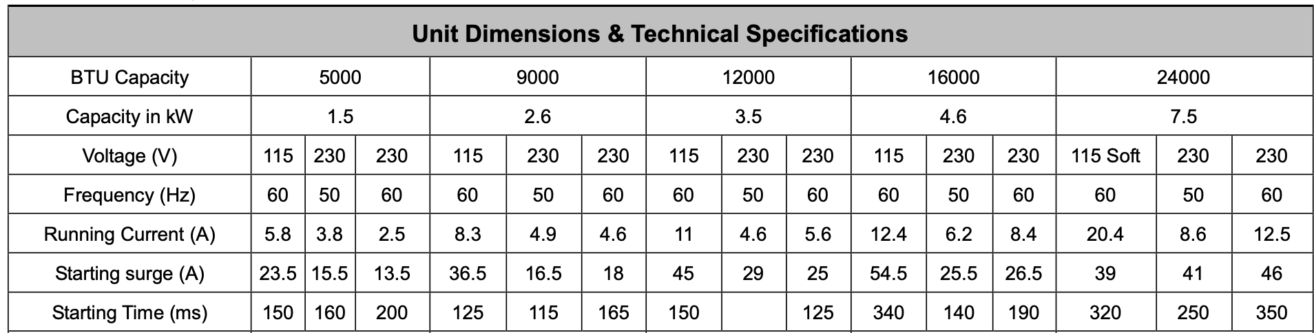

The surge current could be greater than the Breaker.
The breaker may have aged.

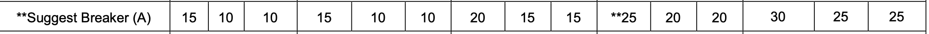

If your unit is the 16000, a slow delay breaker is recommended. Check the breaker meets the requirement. P_erhaps install a new breaker if it is the one on your boat that is popping.

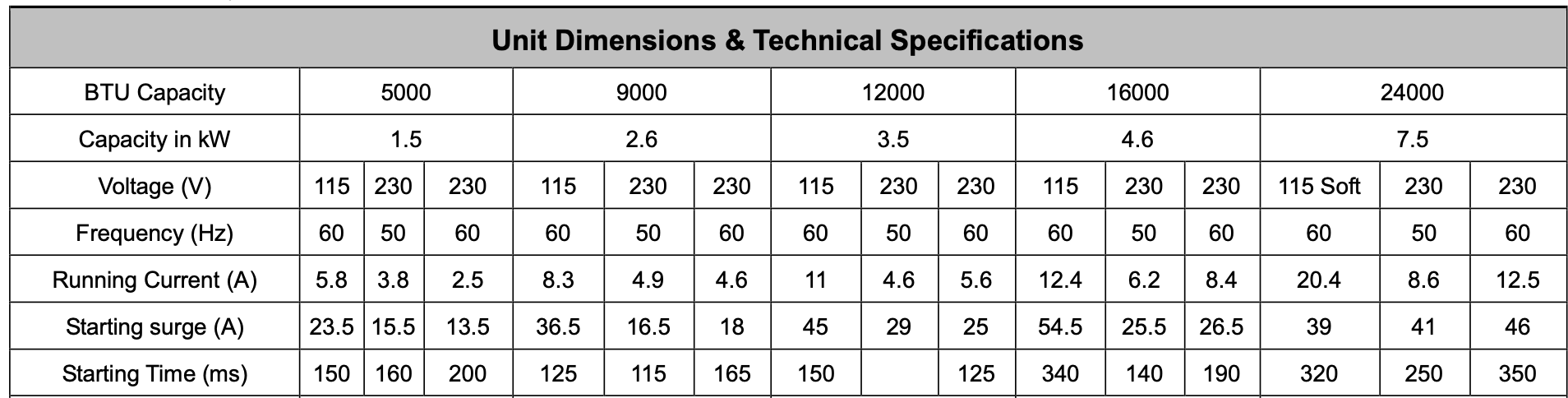

That table is super helpful thank you! The amps are spiking up to 54 when it's surging but after the initial surge lasting barely a second later on after the unit's been running for a while when it starts again it's lasting like three to four seconds and that's what's tripping it. I'm not sure why the amps spiking up like that and lingering there after the unit's been running. I've been considering getting a soft start for it but I don't want that to Band-Aid underlying problem if I have one
