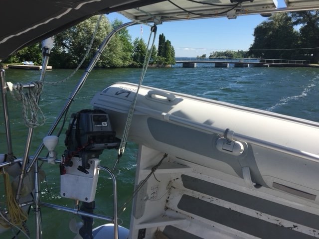

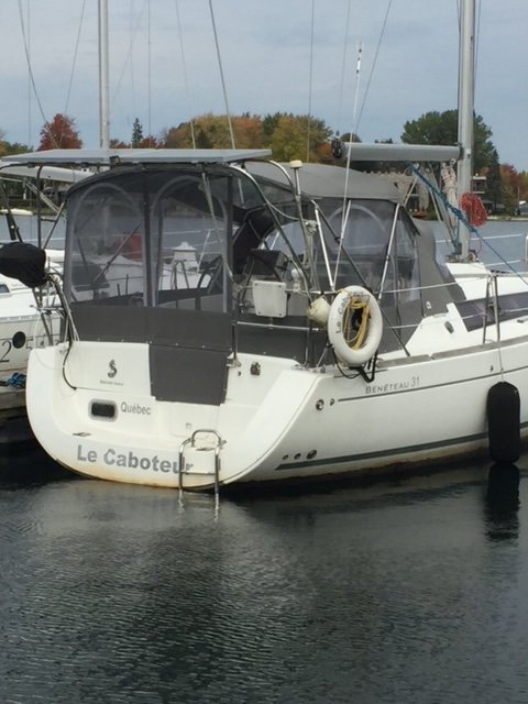

The boat was dirty etc... sorry. On the top picture you can see my now 10 foot dink on the back of the boat... I will need the extensions to sail with the dink on the back of the boat.
There is a stern navigation light screwed on the starboard solar panel. I left the old one in place and simply ran the wiring to the new one.
The bases of the removable davits easily clear the ladder arch... the touchy job is on the port side: you have to remove some of the permanent wood paneling behind the stateroom to reach under the swim platform to install backing washers or plate and the nuts to hold all this in place. On the starboard side it's a piece of cake... though best performed by a 5'01" 100# grand-daughter!
With the smaller 8'6" dink I didn't need the extensions.

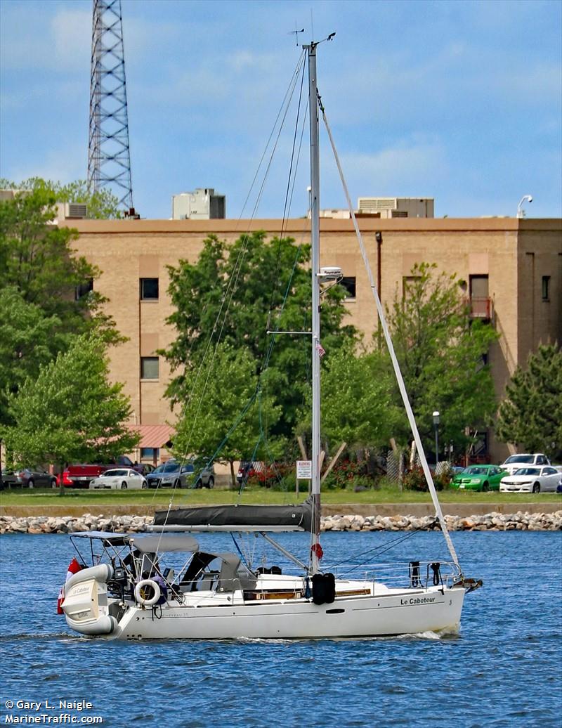

On this pic from Marine Traffic you can see that the dink is hung behind the swim platform... therefore no chafing! You may also notice some lettering on the bottom of the dinghy: that is the boat name and port of call. These would otherwise be hidden by the dinghy.
