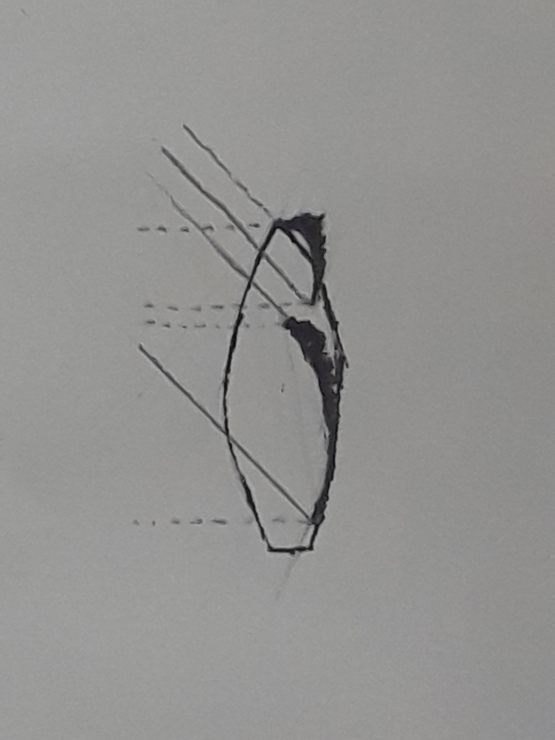

While simplistic, the Center of Effort of the sails (CE) is calculated by marking the intersection of two lines, both which leave the two leading edges of the sail and bisect the other side. If a boat has two sails, the combined CE is in the middle of the line (actually proportionally) that connects them. That we can adjust.
This is accurate geometrically, but cant possibly be useful for sailing. If it is, then i would say stop trying to sail sideways.
I am just a noob, but even when i sail downwind my rig never looks like that, especially compared to the hull.
The sail area should be viewed in terms of a projection from the perpective of the apparent wind. I also suspect that a top down view is better.
In the sketch you see that while pointing the sails are angled for best lift. The projection of apparent wind over the leading edges reduces the "sail area" to a sliver, especialky the jib, in addotion the center of effort for each sail moves backwards.
Note also that force is not applied equally to the sail area. The sketch shows shaded area that represent the lift. This average lift for the most part should be the CE for each sail. Note to that the lift pulls in a direction way different than wind blowing say a fence. The lift force is applied well forward of even the center of the projection.
The CE drawings in textbooks are junk. The best balance will come from the nth iteration of prototyping. I bet if you took a mini transat or most super high performance sail boats the CE textbooks are waaaay off on 2D side geometry versus holostic results.

Good deal. I said simplistic for a reason, because it is. but we are talking about a discussing for beginners. Sail pressure absolutely does not evenly distribute over the sail. It often looks like this.
But the geometric calculation is often close. As least for discussion purposes. And yes, in any event no modern designer would still do that, they model every aspect of the boat. And not just statically, but dynamically.
I might also add that the jib is well forward of the hulls rotational axis (port or starboard). If the boat is not heeled then the lift from the jib is pulling the bow into the water. As the boat heels the disapprotionate lifting force and torque of the jib pulls the bow to windward versus to the water below.
Any discussion of weather helm must involve this "rounding up".
The interaction of CE and CLR is dynamic and constantly changing with changes in wind speed, boat speed, heel angle, etc.
With respect to heel angle, it is much more to do with the CLE moving aft when the boat heels vs changes to the CE.

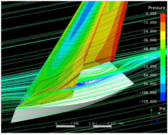

A few years ago I was talking to a designer at the Farr Yachtt Design about the first 36..7. He was talking about the improvements they made between the 367 and the 4 year older 40.7. I think I know a bit about this topic, but the discussion made my head spin.
The point I took out of it is that the deeper levels, this topic is beyond the ken of mortal men and sailors. The levels of dynamic modeling and CFD that supports new hulls at all ranges or speeds, heel, and sea state can’t be simplified into simple sentences or diagrams.
Older designers DID use these simple models and diagrams to get it close. Then they made it good looking and that normally made it fast. And it was at the time. But if you want real speed and real performance, then supercomputers come into play.
