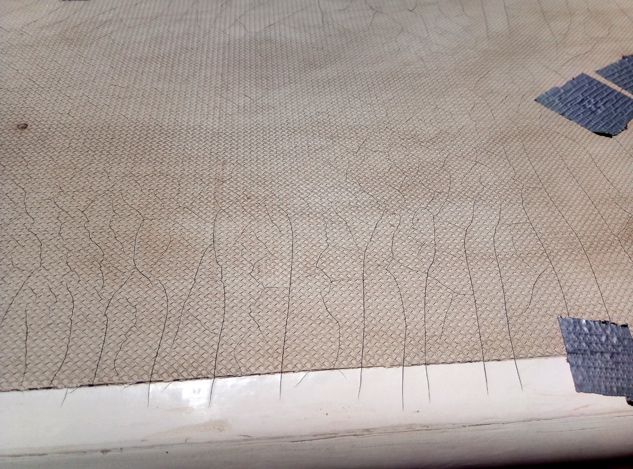

We need to grind down the cockpit coaming and paint it.

We do not need to save the nonskid, but there are a lot of holes from the teak that we will fill.
What type of sander would you recommend?

A random orbit or a dual action sander with 40 grit paper will make short work of this and make it more difficult to gouge the underlying laminate. If you're really careful, an angle grinder with a flapper disk will be even faster with a higher a risk of damage to the glass. Finish up with some 80 grit at the end.
There are now sanding screens available in some places that fit on standard 5 or 6 inch sanders. These don't seem to clog as fast, although I haven't tried them.
14,135
40 grit scares me. It can make deep scratches that are tough to remove without going further than wanted. I'd start with 60 grit, or switch to 60 as sson as the non-skid looks thin.
I'm guessing @capta is going to replace the nonskid with something else. While prepping for the paint the scratches will be removed. And the nonskid hides a lot of sins, like sand paint on a ceiling.

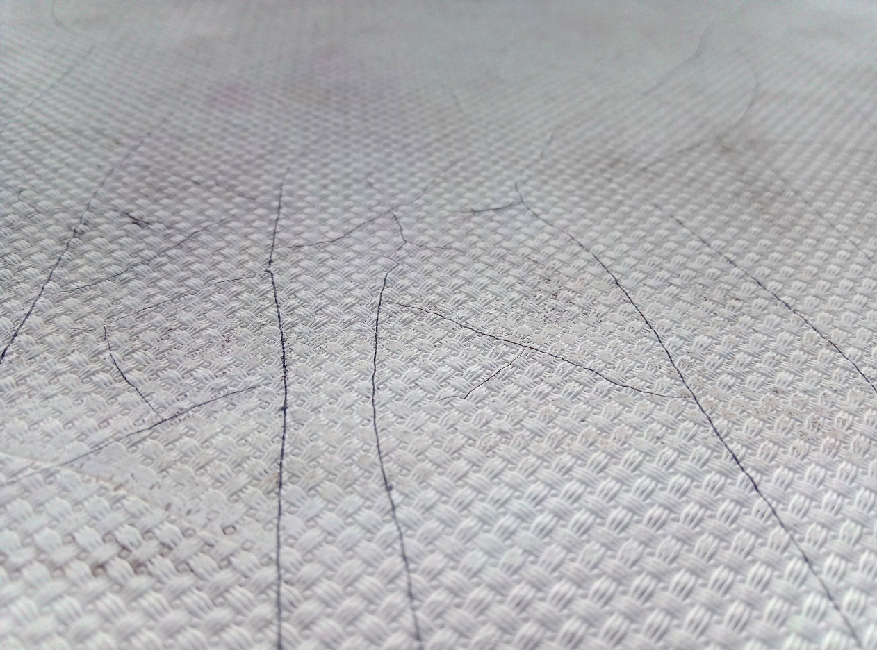

Yeah, unless you want those cracks coming right through the new paint, you're going to grind deep and then do some manner of filler or high build primer before paint, with more sanding and perhaps even a layer of finish cloth and more sanding. Hard to say. But you are going to sand into the first layer of laminate.
I would not use a disk sander. Too much chance of gouging. 60 grit might be a good compromise. And some papers cut much faster than others; 3M purple is the best value when endurance and speed are included.
And you probably want new non-skid; falling down is bad.:(

I didn't ask for a method of dealing with the cracks. They were caused by years and years of wood soaking up water, swelling, then heating up or freezing and drying out, moving the screws. We have no other cracks like this anywhere on the boat.

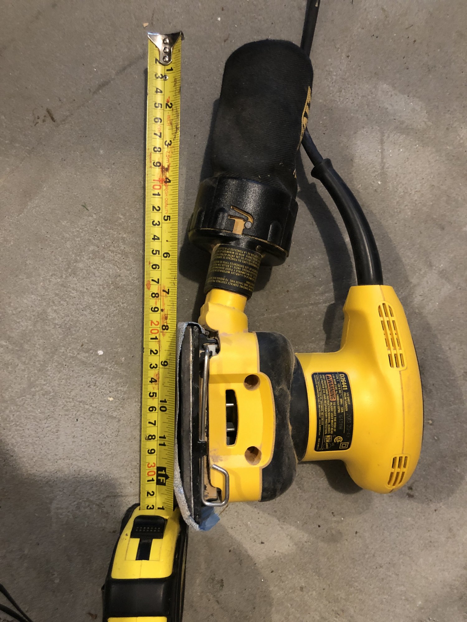

I use a Dewalt model D26441 - 1/4 sheet palm sander that doesn’t require any special discs etc. Take normal sand paper sheets cut them up for size and sand away. Dust bag comes off if space is tight.
